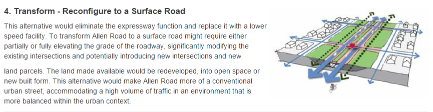

The preliminary work of the unfinished EA showed ample room for a bikeway and a linear park system in addition to development.
The subway would have to be decked over in any proposal. It would make no sense to leave it exposed. and there will still be a divide with the subway that has to be grade separated. Decking will remove the negative aspects of all of this and not divide the neighborhood, and provide Toronto with another linear park.
Edit to add: Here's the of the slides:

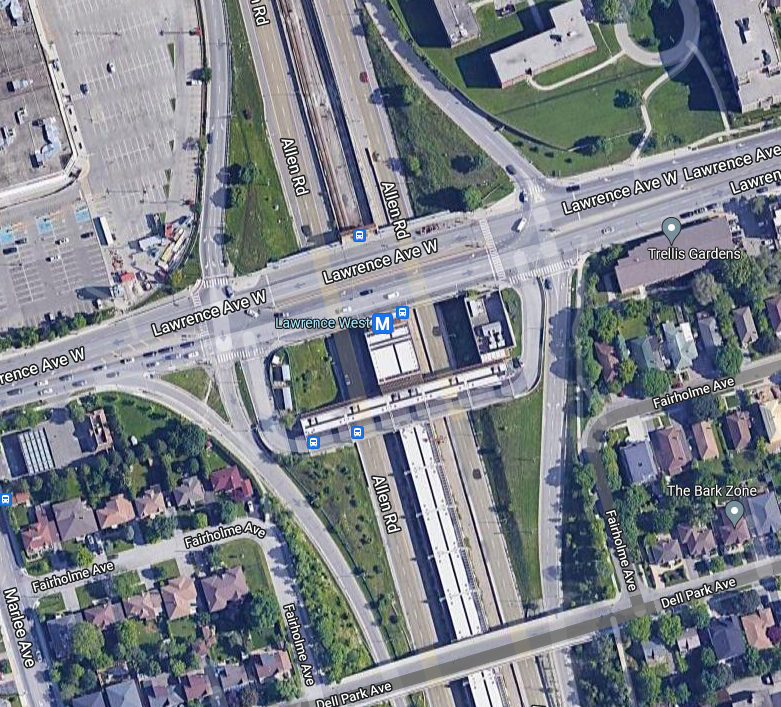

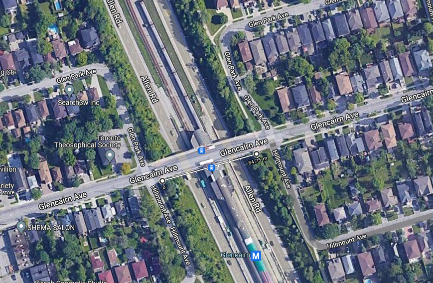

Here's a couple of aerial pics of The Allen:
It varies slightly in width, but over all the corridor, including the subway is about 80M wide at non-interchange streets.
A basic (2-lane road, plus cycle tracks and sidewalks) would occupy ~20M; that leaves 60M all of which can be a greenway between major streets/station areas. You then set aside 40M for development at the major streets,
preserving a 20M linear park (roughly 4M trail, and two 8M landscaped buffer zones w/lighting and seating) that take you to the wider spots in between where there's room for playgrounds and sports fields.
Based on a distance of ~2.5km from Ranee to Eglinton; and allowing for some additional cross-streets and such, I'd say there's room for about 10 hectares or 25 acres of new park.
Lawrence as an interchange occupies much more space, its over 200M wide at Lawrence, and narrows to ~115M at Dell Park.
Lots of room to do multiple interesting things.
