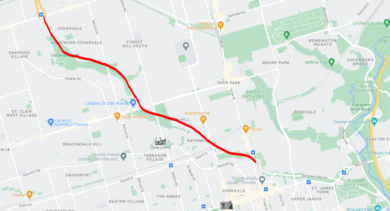

Given the reference to Avenue Road, I assume something like this?
There are plenty of problems with this plan:
  1. How much will it cost? You need to get around the YU subway, and whatever creek beds may exist on that alignment.
  2. Three lanes in both directions? That will have not nearly enough capacity, especially since it'll induce demand from the DVP. And maybe the TTC.
  3. Even if there is enough capacity, it is still dumping cars onto congested downtown streets. Which definitely are above capacity.
  4. You are running a freeway through Forest Hill, Rosedale, Summerhill, etc. If the Osgoode Hall has created so much controversy, what do you think the odds are of this happening (you'd need to demolish actual housing, plus bits of Cedarvale Ravine)?
Or in other words, not happening, and even if it was happening, bad plan.

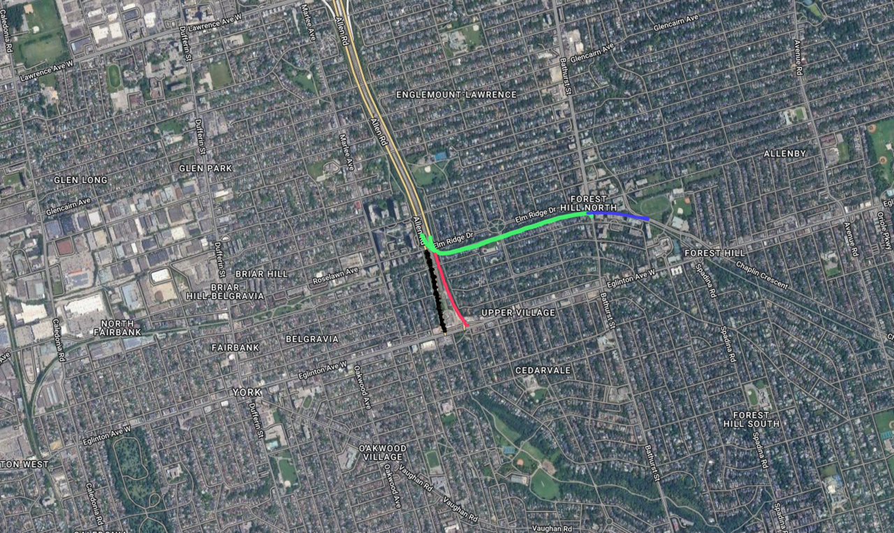

Wow, two people who I admire like my idea.
I fleshed it out a bit with a poorly drawn map, and slides from other tunnel projects.
Midtown Tunnel, Allen Road, Toronto
Black: Closed portion of Allen Rd, turned into a park
Red: New at grade Aterial road connecting to Eglinton at East side of Line 1
Green: 3 lane tunnel under Beltway to Bathurst, 1 lane reversible
Blue: 2 lane tunnel to Chaplin, no through traffic @ Eglinton
Tunnel length: 1.4km
Estimated cost: ~$800M
New exits: Bathurst St South and Chaplin Cres South
New Entrances: Bathurst Northboud to Allen Northbound
Chaplin Northbound to Allen Northbound
Objectives:
- Reduced total number of pedestrian conflicts
- More efficient traffic dispersion in study area

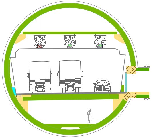

Cross section:
Portal @ Bathurst and Chaplin uses centre of street.
