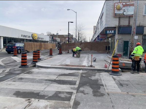

Becky Katz is obviously proud of the small project at Danforth/Kelvin (and rightly so, we just and a few hundred/thousand more of these).
She's posted another update, and her project team posted for a photo on-site. (Text part of update first)
Team pic (Becky on the left)
Taken from:
are there cells under that planter area, or is it another coffin?
I don't believe there were silva cells deployed here, but there are none needed, this will not be a coffin.
Silva Cells serve the purpose of protecting any tree roots from compaction by the sidewalk above.
But there, there is no sidewalk above, the tree will be placed within a planter, whose soil will be exposed to air.
Additionally, the concern is soil volume, I can eyeball the design and tell you there will be adequate soil depth and volume here to provide for a healthy mature tree.
The design also minimizes excess salt and encourages adequate moisture through the direction of storm water. This is a solid effort.

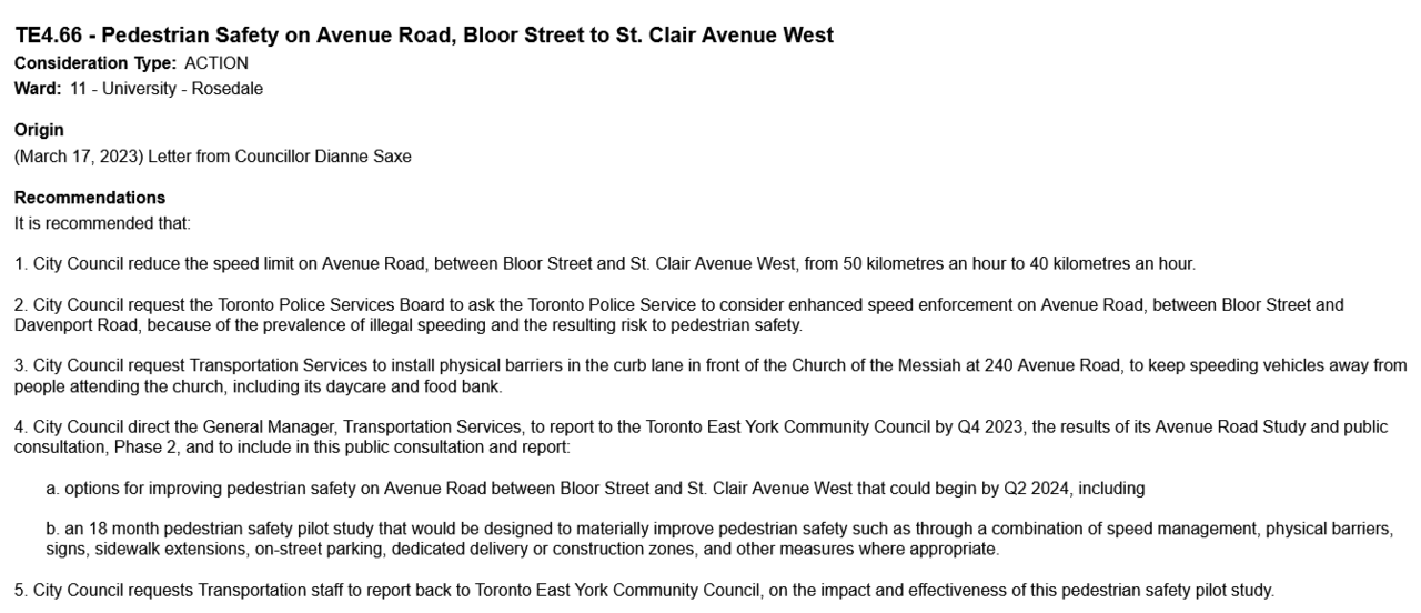

Second item for this thread comes to us via the agenda for the next TEYCC meeting.
There, a letter/motion from Councillor Saxe will come forward on the subject of pedestrian safety and Avenue Road.
I did hint at something just recently.........and voila:
Taken from:
Signs are useless for the want-to-be-expressway named Avenue Road. If they put up speed limit cameras on Avenue Road after putting up the signs, we'll have a revenue source like Parkside Drive and their useless 40 km/h speed limit signs. No improvement for pedestrian safety until they actually narrow Avenue Road down to 2 lanes in each direction an install proper Vision Zero action plans.
