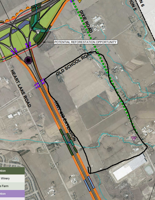

The transit ROW looks very appealing, add a GO bus station in Caledon East that then going to the airport road interchange.
On a side note, the area circled in black is a proposed massive warehouse complex. I think it would be a smart idea to add an interchange on old school road for the trucks to easily get on the highway.
Aside from my opposition to the highway ... that's too close to the interchange, unless you mean something like this:

  • The 410 interchange is both too large and precludes a future extension towards Orangeville.
The idea will run into issues north of Old Base Line due to the terrain, unless we repurpose the existing highway 10 corridor but that also has its own issues because of the towns it intercepts.

Since Heart Lake Rd was converted in a limited access 2 lane highway during farmland era, there was never a need for service roads. Later on it was expanded into a 4 lane freeway.
The issue is the 410 was designed to be a connection to Brampton not a through route to travel across Brampton.
Ah right right. Still, they'd function nicely here just for the sake of making travel easier. One can only dream.
