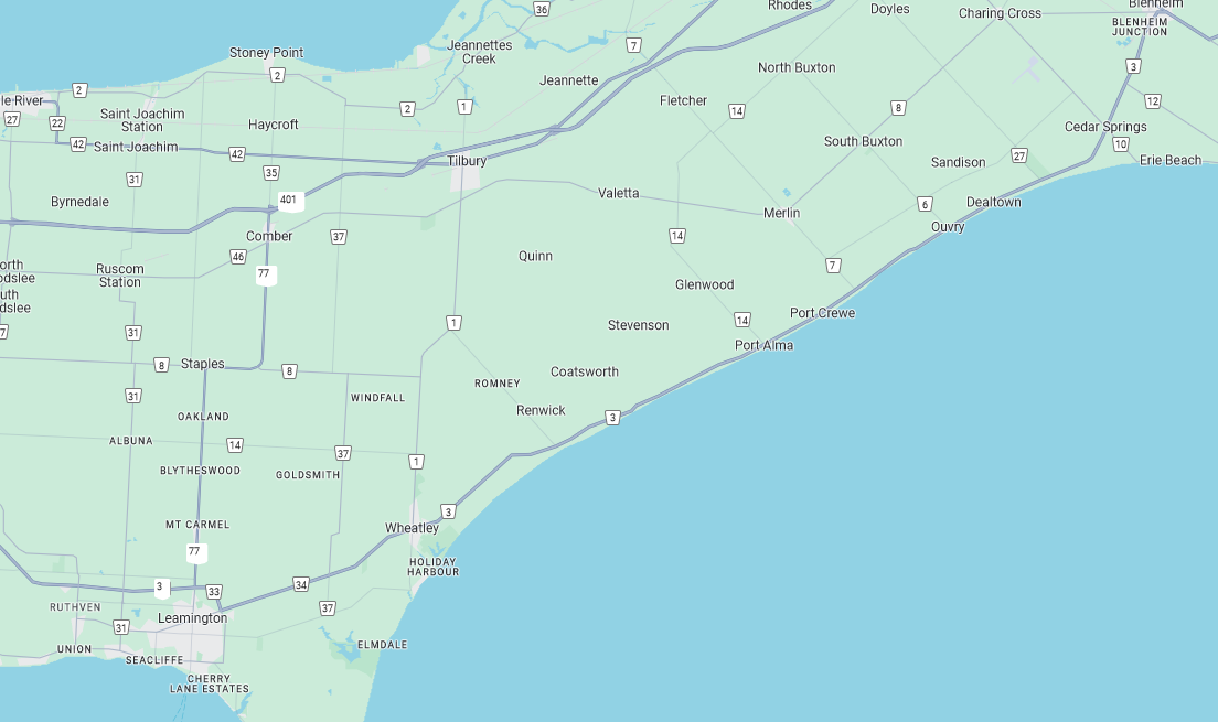

Here's a question for UT's Highway expert:
Are there any plans for this section Highway 3:
I feel quite strongly that this section should either remain a local road, where applicable, or even be removed (re-aligned) entirely. Its very close to the water and really cuts off Lake access in some measure, most of the properties on the south (lake side) are subject to erosion issues and may have to be removed anyway. Better to rebuild the road further north, particularly east of Wheatley and line it up to #6 or #8 east of Merlin.
That stretch is a municipal road and has been for a while - I imagine it’ll stay more or less as it is for the foreseeable future. I can’t imagine it’s particularly busy, and mostly just provides local access to the area.
There are a whole ton of little cottages and houses along the lake there though that need access so I don’t see its removal as being particularly useful.
That hasn't been highway 3 since the mid 90s Mike Harris downloading. And parts of it were actually washed out years ago and still never rebuilt (though officially the closure is still "temporary").
As I noted, many of those cottages are at risk of being washed out into the Lake.
I favour converting that space to parkland and the Lake Erie Waterfront Trail, when critical masses of them come out (which they will). Erosion mitigation here would be prohibitively expensive, and an aesthetic blight (shoreline hardening and/or a breakwall)

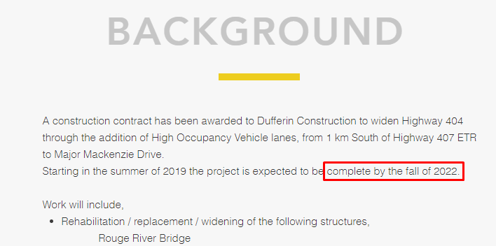

Anyone know what's going on with the 404 widening north of H7? I swear its been under construction for 6-7 years now and it feels like work has completely stalled for the last 2. The section north of Major Mack has basically looked done since summer 2019 and it is still not open due to the expansion south of MM still being worked on.
The website does says it should open in June 2024.
This is just speculation on my part, but I think they are waiting for the completion of the 16th Ave widening before opening the HOV lanes on Hwy 404. However, that makes no sense as the main widening for twin underpasses is already complete so there should be little to no impact.
Edit: This has been delayed quite a bit. I wonder what caused the 2 year delay. This is from the page 4 years ago:
There were massive delays on the 404 project which already had a ridiculously long construction schedule in the first place. I'm unsure of exactly what the issue was though, but it's at least finally almost done.
