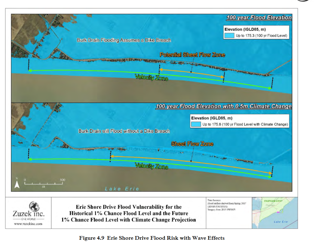

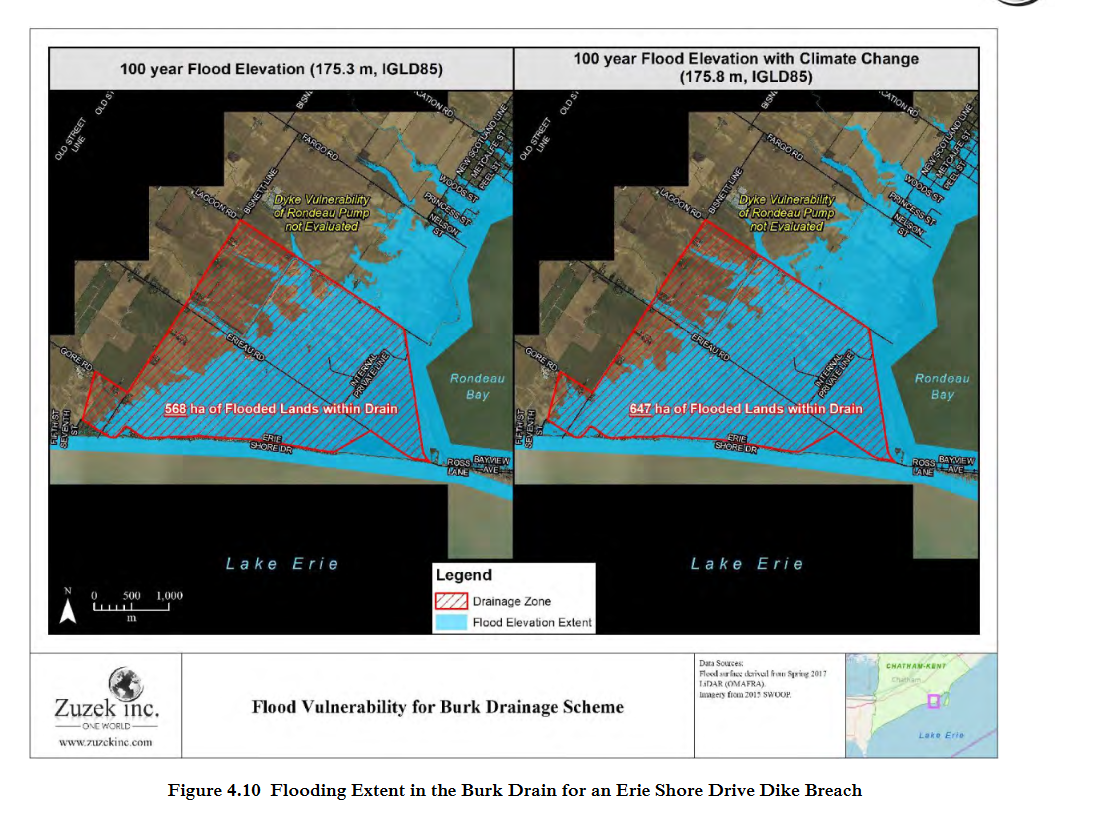

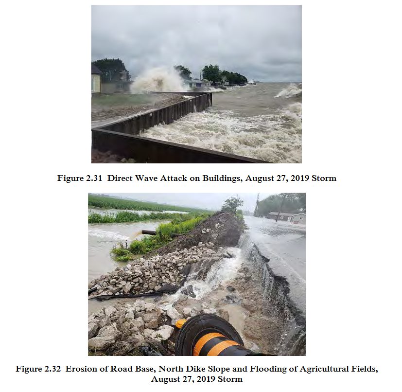

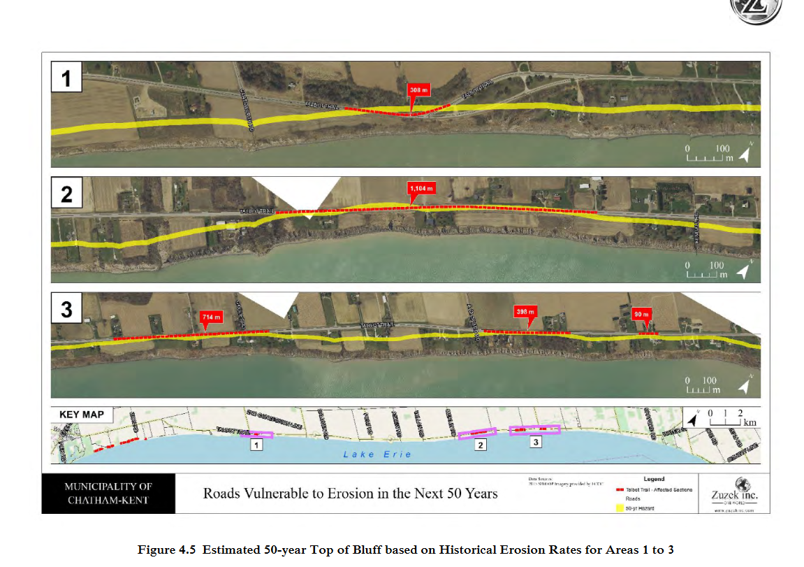

From the Planning Study above, a good photographic example of the problem:
What the Erosion risk to the road looks like:
Look at the projected regulatory flood plain (100-year storm) with climate change modeled in)
More of the above, with/without climate change:
Ok, I need to stop for tonight, I only got to p.80. more at the link above.

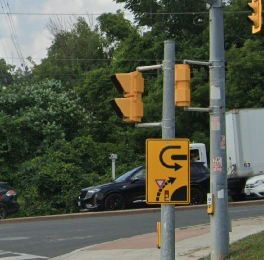

Anyone familiar with the HTA? I thought U turns are at fault for any sort of accident 100% of the time, saw an interesting sign in Woodbridge that may counter that?
This sign is stating the legally obvious (and by general design, amber sign is advisory). Without quoting chapter and verse, a vehicle facing a red indication may turn right after stopping provided they yield to any vehicles lawfully in the intersection. Since the other roadway is facing a green, they have the right-of-way.
U-turns in intersections are legal unless specifically prohibited. Personally, I would prefer they not be.
The only reason I can think of for the sign (and there are a few instances along Hwy where the VIVA rapidways operate in the median) is where the interchange explicitly indicates that the intersection is dedicated for making a U-Turn. Often done where there is a business or some address that can only be access via a right turn.
So I'm curious where this sign is located...
See the location below where the sign explicitly indicates "U-Turn permitted".
https://www.google.com/maps/@43.787...SLdPUV0q9f_8mwSg!2e0!7i16384!8i8192?entry=ttu
Saw something similar when I was in Calgary earlier this year. BRT running down International Ave., They allow a U-turn at every left turn when the "left turn light" turns green.
I suspect the sign is there because of a high collision count or multiple 'close call' complaints, possibly because of the configuration of the intersection or some adjacent factor that is causing a high rate of u-turns (in my experience, they're really not all that common).
The sign on Hwy 7 is there to permit u-turns on the left turn signal; otherwise they would be prohibited because it is a dedicated lane signal for a dedicated purpose and, without the statement at the bottom, the sign says 'left turn signal'. Section 144(9) of the HTA basically says that the rules regarding rights-of-way, movements and signal indication rules are subject to any sign that is posted (like in this case). U-turns are still legal for the 'through signals because there is no sign prohibiting them. In the case of intersections like this, I find that particularly dangerous. It's a large intersection and, with the bus shelters, barriers and possibly transit vehicles sitting at the line, the sight lines look particularly poor.
