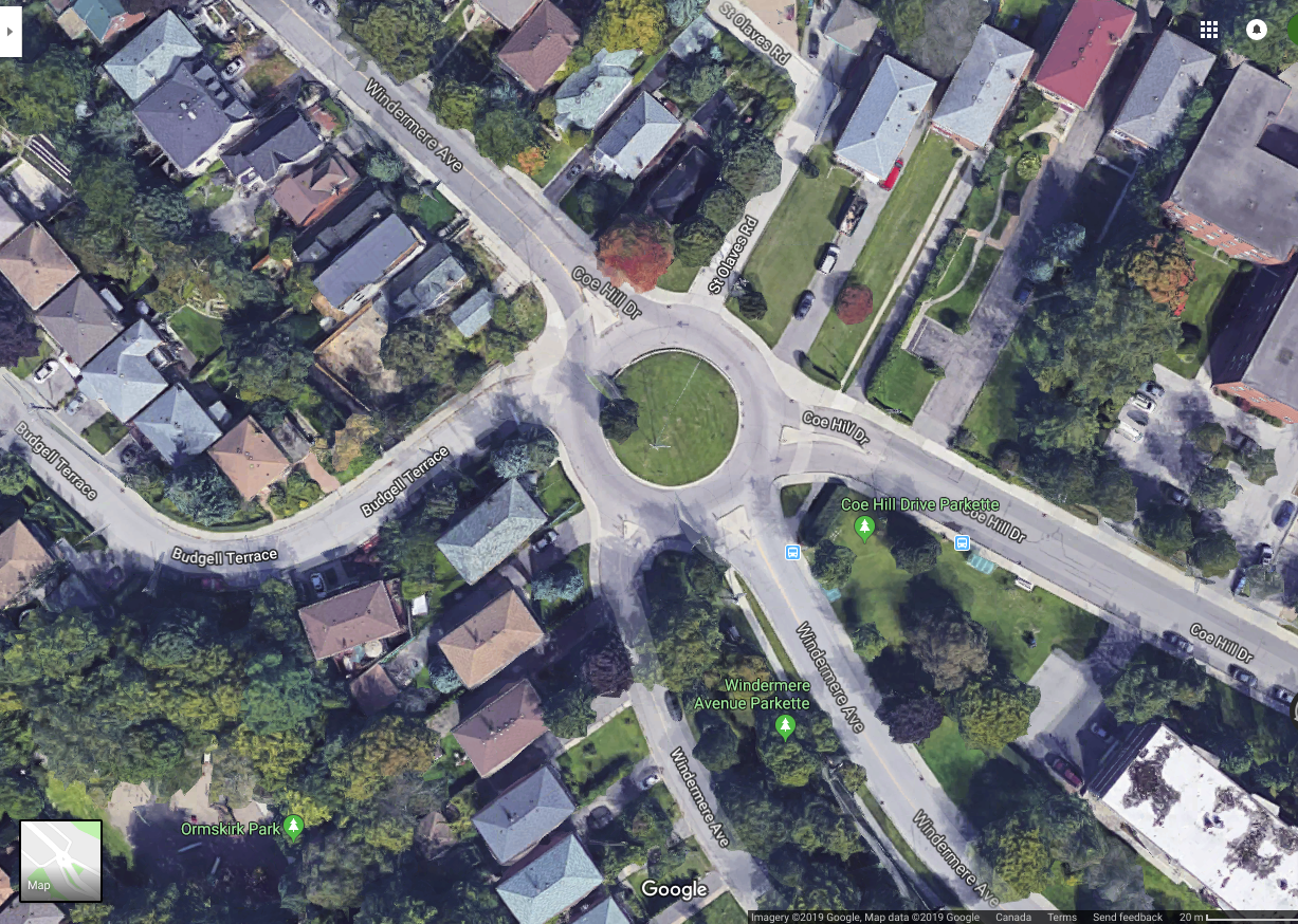

The oldest one I'm aware of is on Windermere in Swansea. Just looking at it now, I see that it isn't a 'classic' one as is now being used in Waterloo, but it does something very clever I never realized before seeing it from above:
https://www.google.ca/maps/place/To...23555502ab4c477!8m2!3d43.653226!4d-79.3831843
It's more like an inverse railway roundhouse than a classic roundabout. Note how it services a 'by-pass' for the original Windermere Ave and also St Olave's Rd and a driveway.
I don't have the references up on my taskbar that I did earlier, but IIRC notable in Waterloo's case is the *increase* in accidents (mostly on initiation of the roundabout) but the *severity* of accidents was vastly reduced. Almost all were scrapes and bumps, no T-bones, no head-ons. Pedestrian safety takes on a new impetus however. Europe has long ago accepted the need for pedestrian underpasses at them. Waterloo's impression is very favourable, but unless addressed in the HTA in the last while, there is no provision in the HTA for roundabouts.
I'll dig deeper on those facets later, and Toronto's official stance. I seem to recollect Toronto leaning toward implementing them. There are very good reasons to doing so.
Edit: Just doing some checking now. One source claims "This is a traffic circle, not a roundabout, as it has stop signs at the junction". Just checked on Google map, that is wrong, they are *yield* signs, technically unnecessary, but a sop to motorists to 'mind their road manners'. In other words, legally redundant but good reminders.
