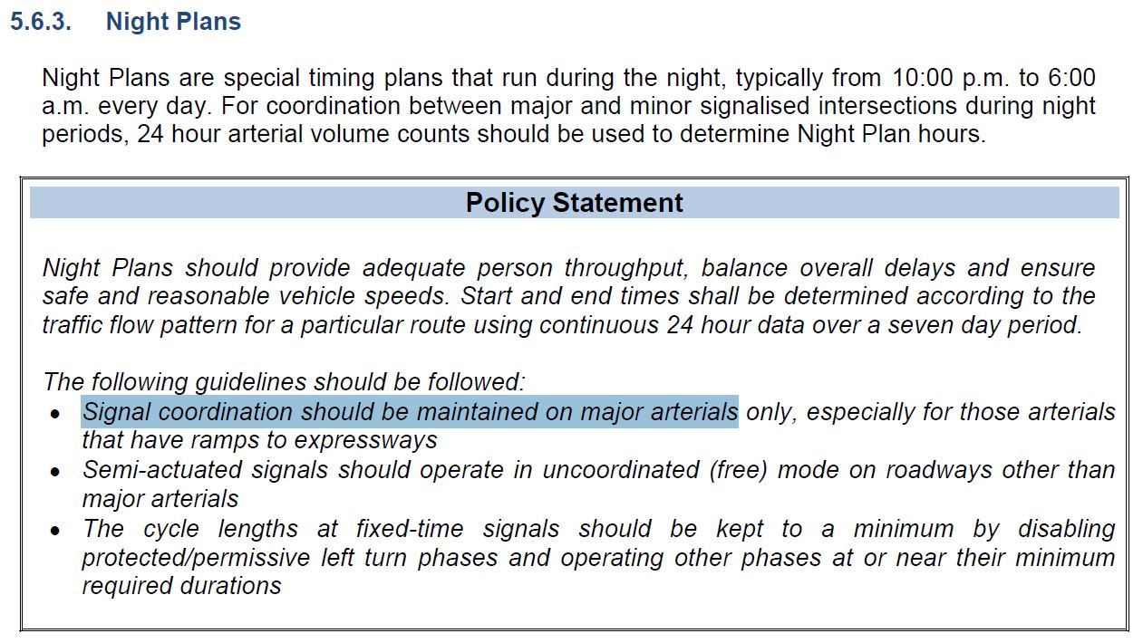

Toronto used flashing red/yellow at night for while, but stopped doing that after tests found that leaving the signals on normally at night reduced the number of collisions. Which is a bit counterintuitive considering how many people ignore the lights at night or drive excessively fast through greens, but apparently that's what they found.
In most cases if you're waiting at a red light for no reason in the middle of the night along a minor street, it's probably due to the signal operating in Coordinated mode, as per this policy:
City of Toronto Traffic Signal Operating Policies (2015)
I quickly show the difference between Coordinated and Uncoordinated operation in this video:
The issue here is that signal coordination in Toronto is based on a single fixed "yield point". Which means that each cycle there is only one precise moment when the light is allowed to turn to yellow along the main street. Even with a shortened cycle during the night plan (e.g. 60 seconds), you could potentially wait up to 66 seconds at a red light even though there's no traffic in any other direction.
In contrast, uncoordinated (free) mode is simply based on a minimum green duration for the main street (which has no detectors). Once that time has elapsed, the signal responds immediately to demand on the side street. However, the city policy is to leave the Walk lights on along the main street, so you first need to wait for the full Flashing Don't Walk, Yellow and Red times before you can get a green for the side street.
It's good that they try to reduce coordination at night, but in my opinion they should have gone even further. Even arterial intersections should operate free, unless they are within a few hundred metres of a fixed-time intersection. The premise of signal coordination is that there is a particular moment in the cycle when a red light would have less impact on traffic along the main street, due to the timing of red lights at other nearby intersections. But at night, so many of the red lights along the main street get skipped or end up being shorter than planned that it's totally random when traffic actually shows up along the main street, unless there is a nearby intersection which consistently turns red at particular moments due to being fixed-time.
(Toronto-style) coordination is doubly stupid at night because with super-low volumes, it doesn't make sense to prioritize theoretical traffic on the main street over someone detected on the side street who is definitely actually there.
If it were up to me, the policy would be "On Arterial Roads, signal coordination should only be maintained at fixed-time signals, or semi-actuated signals within 300 metres of a fixed-time signal. On other roadways, signal coordination should only be maintained at fixed-time signals or semi-actuated signals within 150 metres of a fixed-time signal."
If you're waiting at a red at a major-major intersection, or most intersections downtown, the signal is probably totally fixed time and thus doesn't respond at all to the presence or absence of traffic on the thru legs (though it may still respond to left turns).

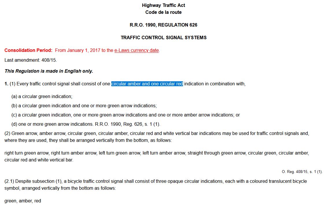

Note that The Netherlands have a RED and YELLOW ARROW traffic signals. Something forbidden in Ontario it seems.
Yeah it's literally the first rule in the Highway Traffic Act Regulation on Traffic Signals (HTA reg. 626):
And yes, I agree that it's a stupid rule.
