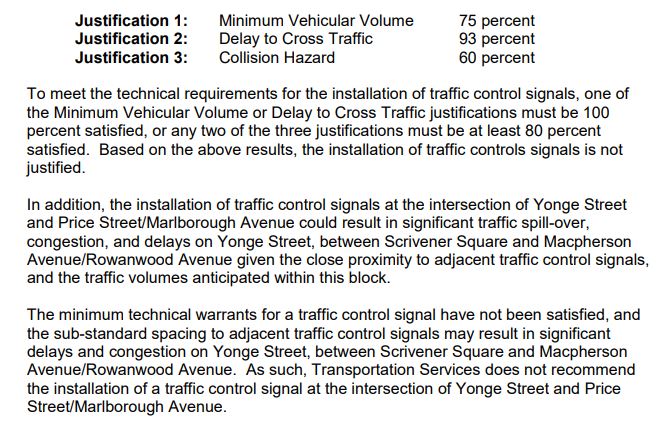

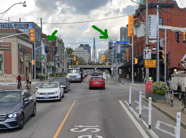

I happened to notice in Streetview that they were installing a new traffic signal at Yonge & Price/Marlborough, which is insanely close to the existing signals at Yonge & Scrivener Square (75 metres) and at Yonge & Macpherson/Rowanwood (88 metres). To put that into perspective, each of these minor intersections is about 30 metres wide, which will leave about 45 metres of space between them.
I couldn't believe that City staff would approve such a nonsensical location for a traffic signal, and it tuns out that actually they didn't.
Councillor Mike Layton requested a signal at that location, since a guy who works on Price Street (a dead end with 8 buildings) is worried traffic will increase with the condo development on the south side of Scrivener Square, and it will take him too long to turn left on Yonge when he drives home at the end of the day. Staff rejected the request for a signal, because it's exceedingly close to the other existing signals, and that traffic from the Scrivener Square development can use the existing traffic signals at (you guessed it!) Scrivener Square.
From the staff report:

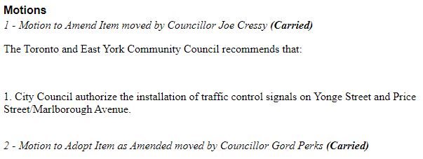

But then during the City council meeting regarding the signal, Councillor Joe Cressy motioned to build the signals anyway, and the motion was passed without a counted vote. So the signals got built.
If this is the way that transport planning occurs - by untrained elected officials disregarding the engineers and planners who have spent their careers learning how to make streets safer - then it should not be any surprise that traffic safety is so poor in Toronto.
In places where Vision Zero programs are implemented thoughtfully and systematically, the intersection would have been evaluated for a variety of intersection changes to improve safety, not just a yes/no on signals. In this case, running a median along Yonge Street would prevent the left turns which were apparently the problem at this intersection, and it would make it safer for pedestrians to cross Yonge. The safety of pedestrians walking along Yonge could also be improved by extending the raised sidewalk across Price/Marlborough, slowing down turning car traffic.

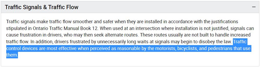

Of course the councillors didn't consider any of these options, because they're not traffic engineers. But apparently they think they are, because they approved the installation of these signals in the name of safety, despite being told by their own traffic engineers that the signals would make the road network less safe by eroding the respect that citizens have for traffic engineering.
It's not just drivers who are frustrated by unnecessary waits, it's all people, especially while walking and cycling. Many pedestrians and cyclists along Yonge aren't going to stop at this signal, they will look at it and decide that it was stupid to have a signal anyway and just walk/bike across when there's no traffic.
