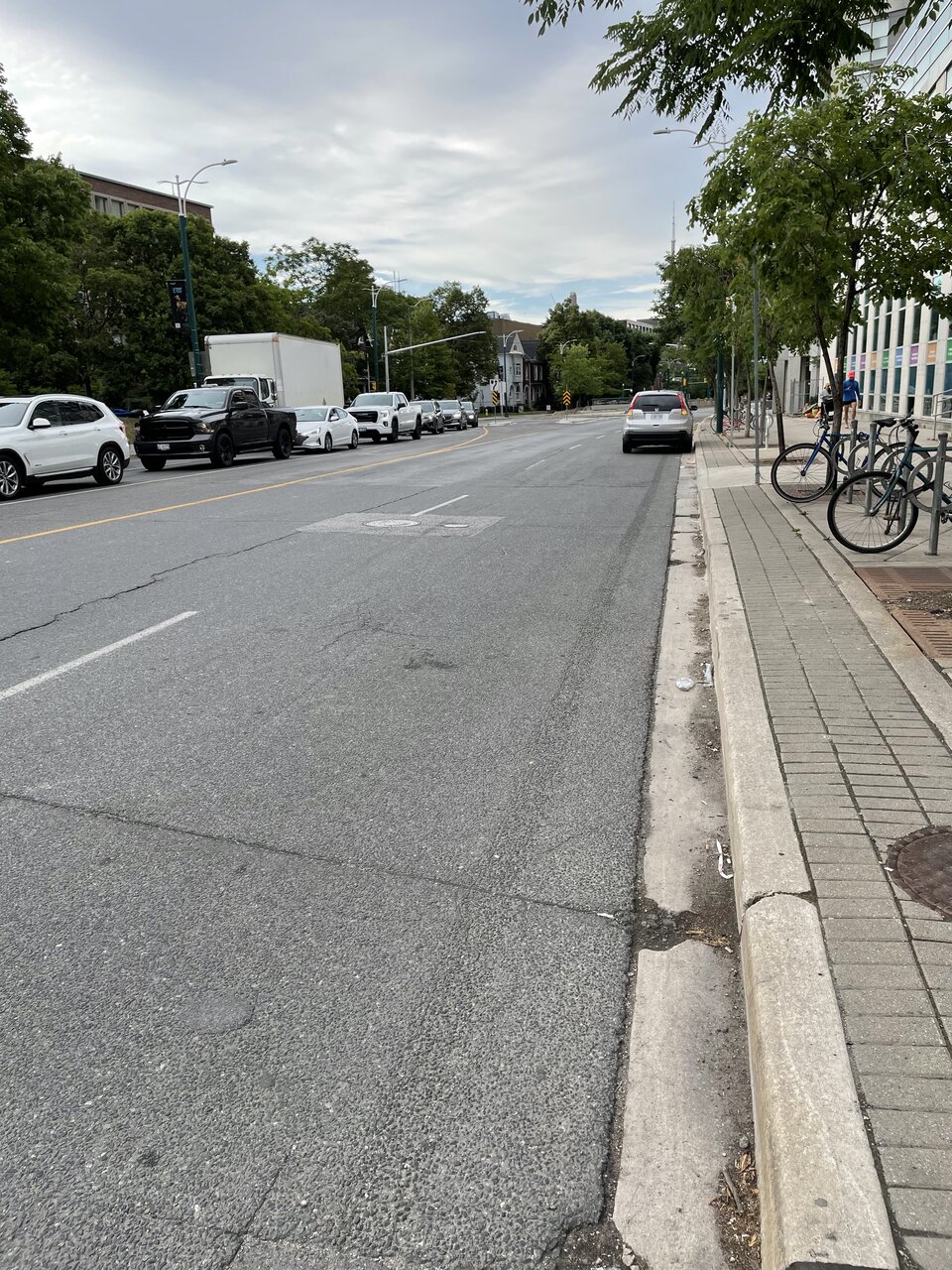

Why is a traffic light being installed literally 50 meters south of Spadina and Bloor?? *rolls eyes*
Just to go back to this one for a second, I took the picture below right from Bloor and Spadina, looking south. The new lights are literally 8 car lengths in distance, and it’s not even a road:

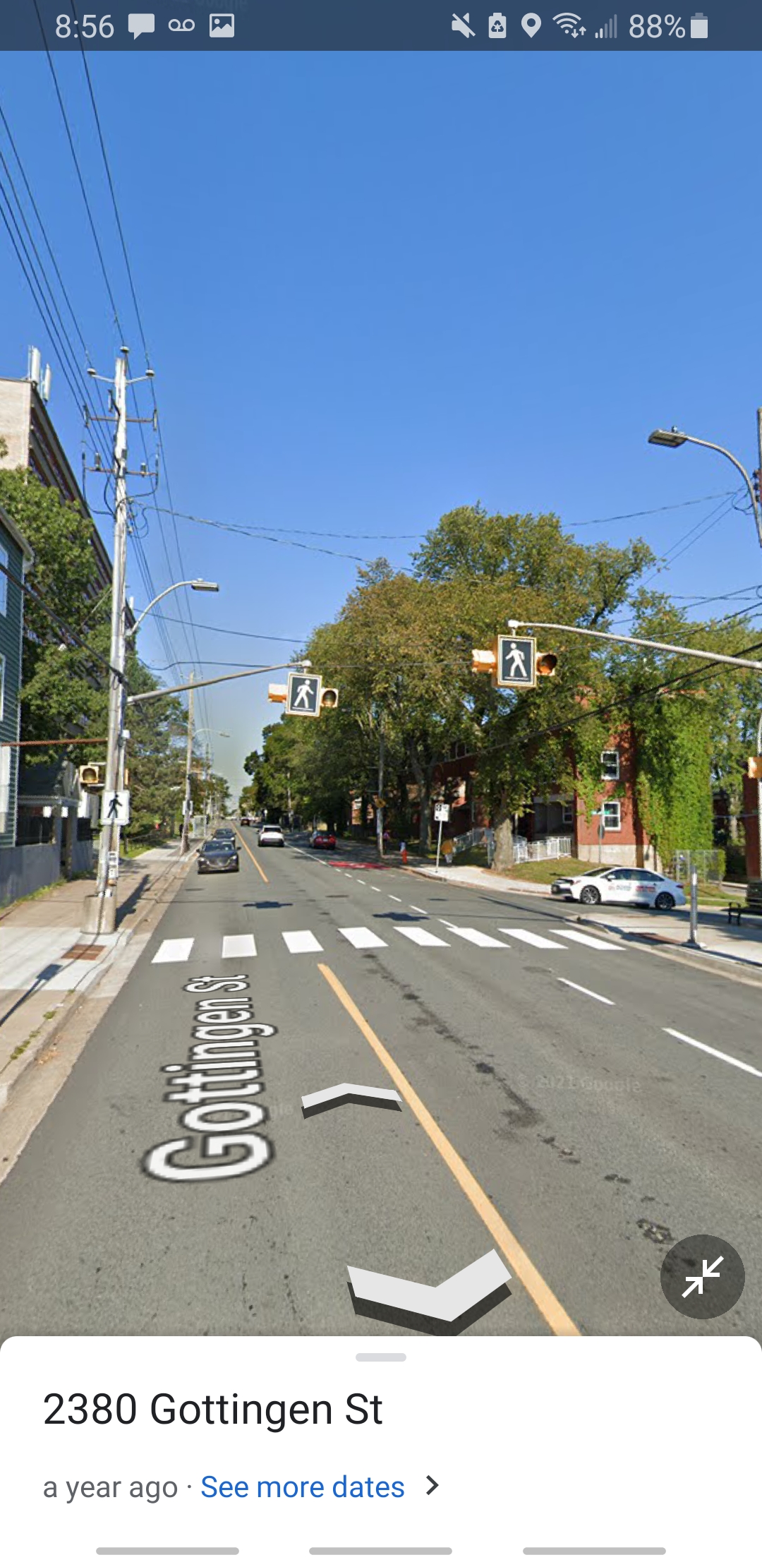

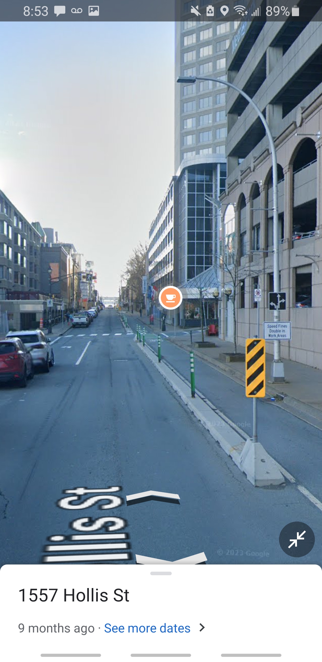

So I just visited halifax and saw how little traffics lights there are. Pedestrian crossing are used very often and allow safe mid block crossing. Traffic moves effectively and is only stopped when required. I am convinced a sizable amount of congestion in Toronto is due to city council and their traffic light spamming. Halifax also is implementing vision zero principles using flexy posts and concrete curbs. Oh and these are not the Toronto ones that are tossed around by a vehicle hitting them. They are bolted to the pavement and have standard height signage attached to the top. Gottingen street halifax is good example.Screenshot_20230810-085328_Maps.jpgScreenshot_20230810-085649_Maps.jpg

I wouldn't say 'safe mid-block crossing' for Toronto. I use the pedestrian crossings with the (many times correct) assumption that cars are not going to stop.

Just because Toronto's unsignalized crosswalks are poorly designed does not mean that unsignalized crosswalks are inherently unsafe.

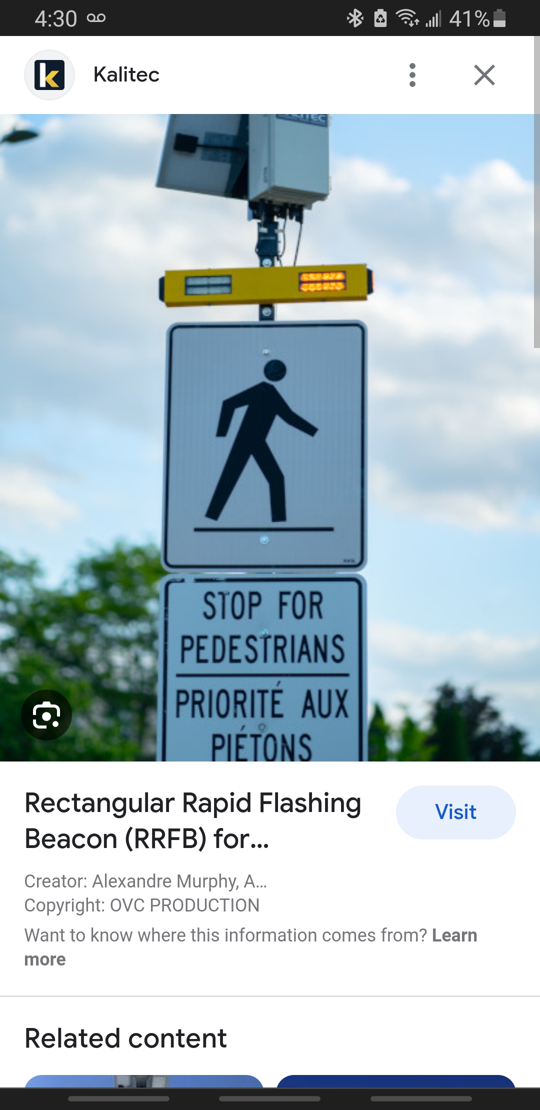

Ya toronto still has not switched to the rrfb signs that are installed all over ontario and North America. The lights are more "aggressive" which increases compliance and safety. View attachment 499085
The problem I have with the 'new' (Level 2) crossover signage in Ontario is the flashing beacons are off to the side rather than overhead in the driver's field of view where they are in the older 'Level 1' configuration. In some cases, because of curb design, trees, or whatever, they can be quite a bit off to the side to the point of being obscured. In a couple of communities that I know of in Central Ontario that originally had this design of crossover (in both cases a built-up area reduced speed zone interrupting a highway speed zone), they have been replaced with full signals.
In my opinion, if they repeated both the signs and lights overhead the lane it would be much safer.

Yes so rrfb signals above the crosswalk with led lights lighting up the area underneath. But as far as I know thats not in the ontario standard. Should be though.

I would like for most of these crossings to be raised to make it easier for drivers to comply and yield to pedestrians.
