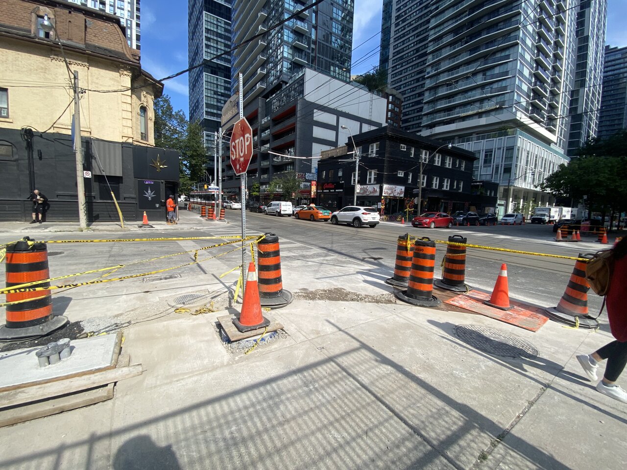

Traffic signals are being installed on Shuter Street at Sackville and Sumach, replacing pedestrian crossovers.
I don’t think these are at all necessary, given the slow speeds on Shuter (it’s a two-lane 30 km/h zone, and there are protected bike lanes and street parking) here.
