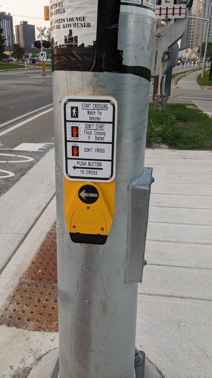

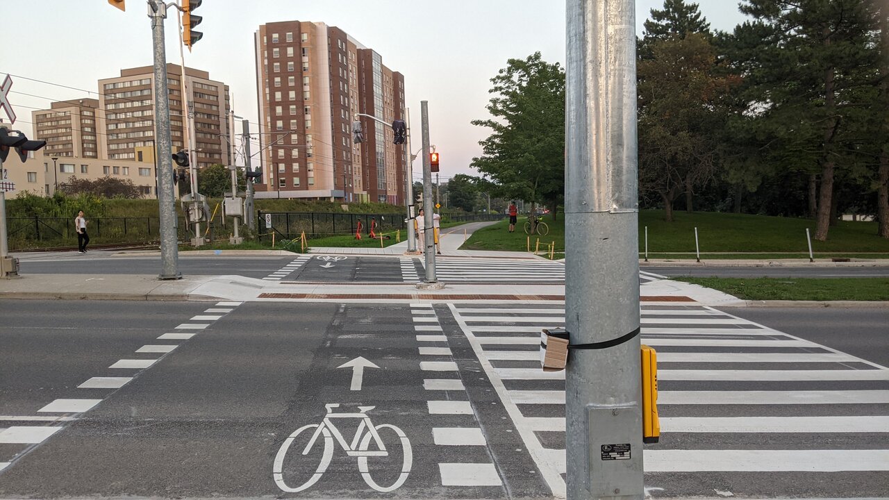

Not Toronto, sorry, but does anyone here know anything about these new pedestrian crossing signals they installed a few weeks ago at the University Ave/Laurel Trail crossing in Waterloo?
They feel much more responsive from the pedestrian end to me (i.e. often pressing the beg button will immediately turn the vehicle signal yellow when there's no incoming traffic, and the ped light will immediately turn green if the button is pressed while the ION crossing gates are down, which didn't always happen before). Would love to know if there's anything meaningfully different with this new system, and whether these improvements are coming to other pedestrian crossings in Ontario.
When the signalling was rebuilt here, they also reconfigured the crossing to be a much wider separated ped + bike crossing, instead of the narrower shared crosswalk it was before. It looks like they've installed a traffic light (and separate beg button?) for bikes, but it's covered up for now.
I used to cross this intersection several times per day, and I still cross it very regularly. It gets a lot of foot and bike traffic. I'm really glad it was improved, the signal timing used to really bug me.

The operation you describe is known as uncoordinated operation. So the signal sits in the main street for some minimum amount of time, after which it responds immediately when someone presses the button.
This is possible with pretty much every traffic signal. It's not an equipment limitation it's just a question of priorities. In most places they don't like it because it can interrupt waves of cars, but it's far better for pedestrians, cyclists and transit priority.
There are some uncoordinated bicycle/ped signals in Toronto (e.g. Finch Hydro trail at Norfinch, Grantbrook and at Talbot), but they programmed a main street pedestrian signal in the timings even though there is no pedestrian signal across the path. So when it detects a pedestrian or bike, it waits 5 seconds for the pedestrian countdown on the non-existant pedestrian signal.
All it would take to resolve this issue is to change the main street recall mode from "pedestrian recall" to "vehicle recall", which is a matter of pressing a single button. But the city doesn't do this because it's not in their procedures. So at all uncoordinated pedestrian/bicycle signals in Toronto, pedestrians and cyclists always need to wait 5 seconds for no reason whatsoever.
