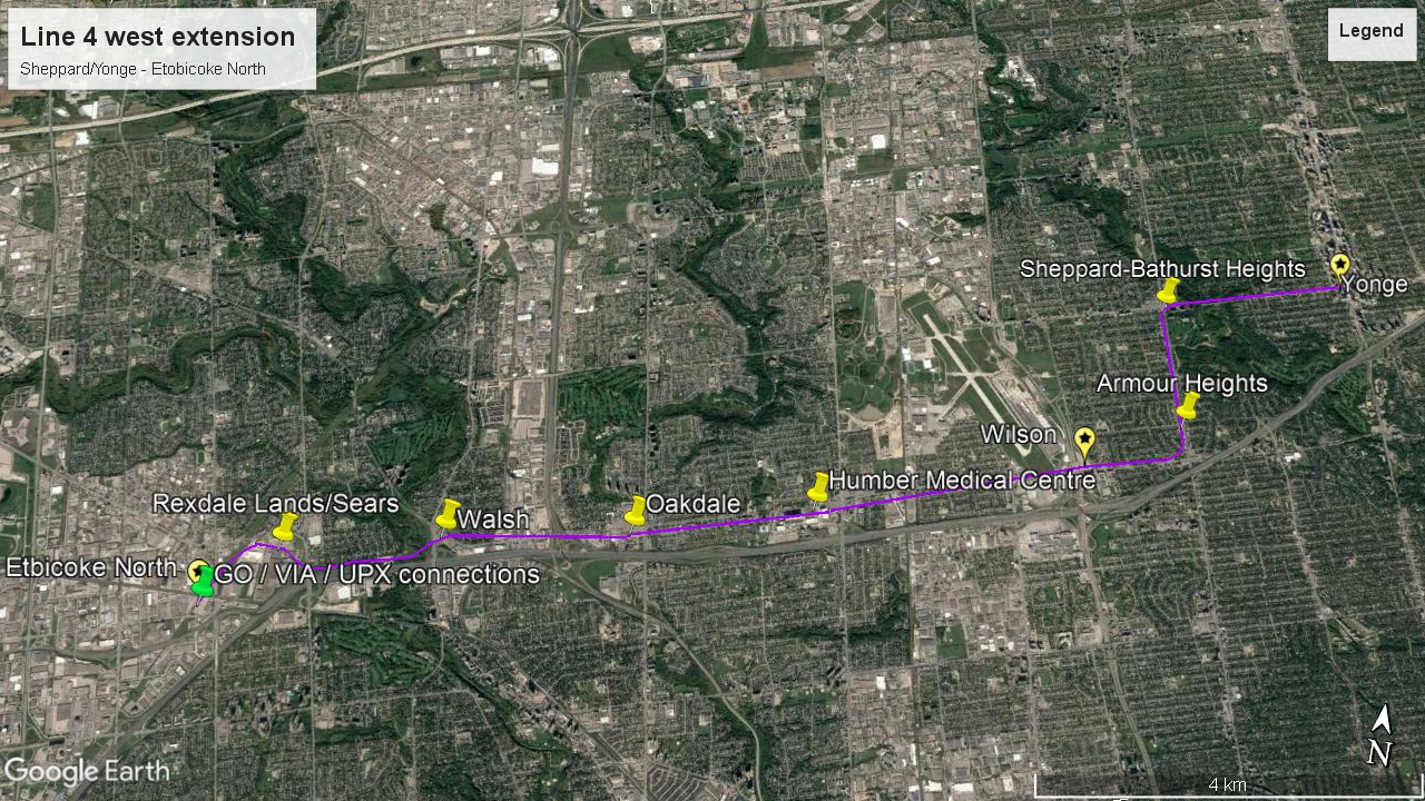

I like your thoughts about connecting Line 4 to Wilson station:). Having an interchange at Wilson makes a lot of sense for a few ways. First of all construction would be less disruptive to Line 1 at Wilson since it has lower passenger numbers than Shepppard West and also Wilson station which has been operating for 40 years without a major renovation is coming due to major renovations and easier access elevator upgrades before 2025. So an upgrade to the existing Wilson Station and brand new infrastructure to create a new underground Line 4 platform level. The other is that Wilson is located in close proximity to a whole bunch of new condos along Wilson and Allen Road. it is also near the Downsview Bombardier lands which I heard that are planning to be sold to developers.
A Line 4 western subway extension from Sheppard-Yonge would serve the relatively dense corridor of Wilson Avenue which is mainly mid rise with several proposals for growth espically in the area surrounding Wilson station. Their is more existing and possible density on Wilson than Sheppard in this area. After Allen Road, Sheppard W. unlike Sheppard E. becomes mostly low rise commercial and residential and Sheppard ends unceremoniously at Weston Road. while Wilson passes through the heart of Downsview, Humber Regional Hospital, the MTO complex, a Seneca campus and several retail centres and mid rise condos. Than Wilson becomes Walsh Avenue before becoming Albion Road.
The would pass under Sheppard Avenue W. until Bathurst where it would turn and run under Bathurst until Wilson where it would curve under into a Wilson Road alignment in the Armour Heights neighbourhood, the line would run underground along Wilson beneath the Allen Rd and connect with Wilson Station on Line 1. It would continue under Wilson, passing Dufferin, the Barrie GO line, Keele, Jane, hwy 400, and Weston Road.
Then the Line 4 alignment could emerge from its tunnel just after Weston and Walsh and cross the Humber river by bridge. then pass by at-grade where Pine Point Park is, then re-enter a tunnel to cross Islington and enter the former Sears warehouse lands in an underground alignment south of Rexdale Blvd. where a mixed-use development is currently proposed. Then the alignment could proceed underground or elevated towards Etobicoke North GO Station where a connection could be made to GO RER as well as possible VIA and UPX service.
This Line 4 extension could be fully designed while being completed in phases like the way Line 2 was completed in phases from 1966 until 1980 when Kipling and Kennedy opened.
The former Sears warehouse lands have huge potential for redevelopment into mid to high density residential and commercial. This site could be well served by a Line 4 west extension.

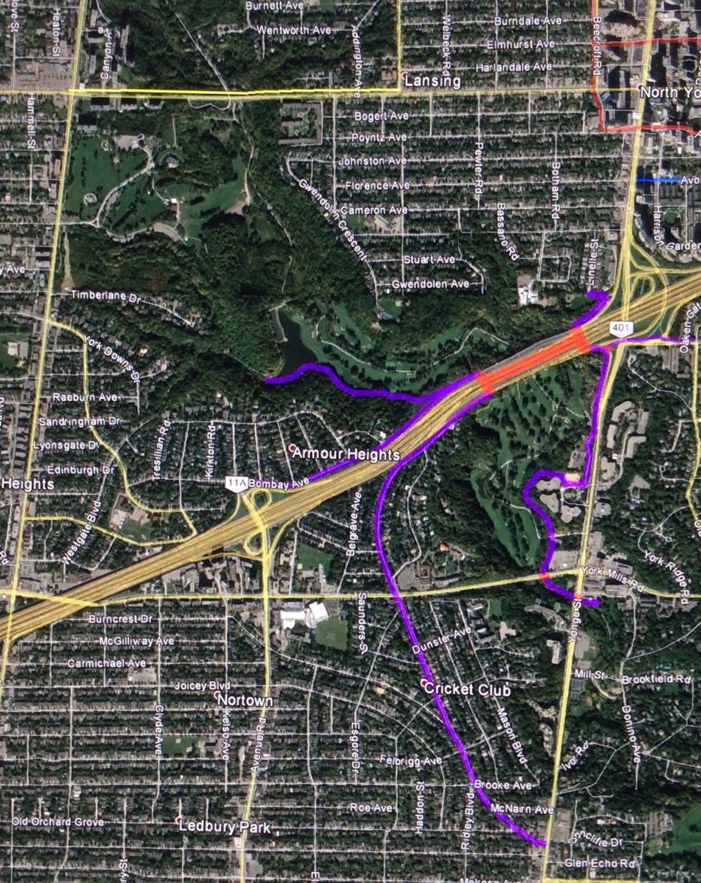

New subway tunnels bored under Highway 401 until it reaches Wilson Ave just east of Bathurst,.. now Bathurst & Wilson will have proper subway station with straight platform below intersection.

I can't see them tunneling under the Don Valley West (Earl Bales Park), it would be just to cost prohibitive and could repeat the Lawrence East issue on the SSE at Bathurst and Sheppard. Is it to much to hope we've learned something from the planning of the SSE?
Tunneling along Sheppard Ave West under the West Don Valley will make one heck of a roller coaster ride! It'll be the TTC's new Vomit Comet!
Anyone familiar with Yonge Subway Line 1 knows from north of Lawrence Station (around Yonge Blvd at valley south ridge), the subway tunnel dips down towards York Mills Station, then the subway tunnel raises up until just north of Highway 401 (valley north ridge); here the ridge-to-ridge distance (Yonge Blvd to 401) is about 2km.
Along Sheppard Ave West, the ridge-to-ridge distance for the West Don Valley is about 0.65km (1/3 of that for Yonge) making any tunnel here super steep! Assuming the tunnel start dipping just west of the current tail-track at Welbeck Rd (just east of Senlac), the distance to a potential Bathurst Subway Station on Sheppard would be 1.5km,... that'll be a very deep underground station,... most likely much deeper than Bayview Station, TTC's deepest station,.. currently.
So tunneling under the ravine shouldn't even be an option, and yet I fear it will be. We made that mistake with the SSE and even further back we made it with the Yonge Extension since York Mills was originally planned to be elevated.
The only option for Sheppard West extension at West Don Valley is a crazy steep tunnel or rebuilding the bridge (about 50 years old and re-decked about 5 years ago) since the current bridge was never engineered to support a subway line.

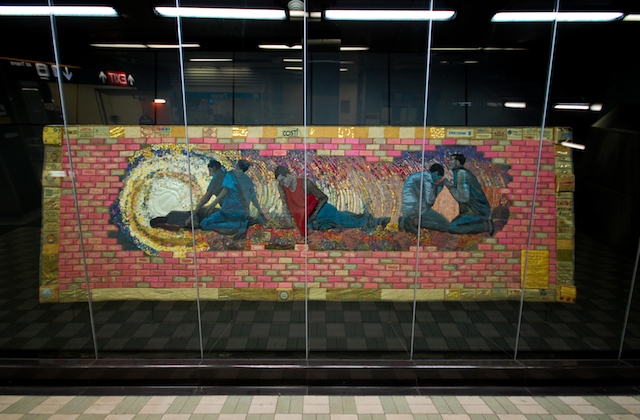

Digging tunnels was very dangerous,... there's a special memorial quilt that hangs at York Mills Subway Station marking the Hogg’s Hollow Disaster.
https://www.thestar.com/news/gta/20...rks_50_years_since_hoggs_hollow_disaster.html
https://torontoist.com/2010/03/historicst_disaster_at_hoggs_hollow/

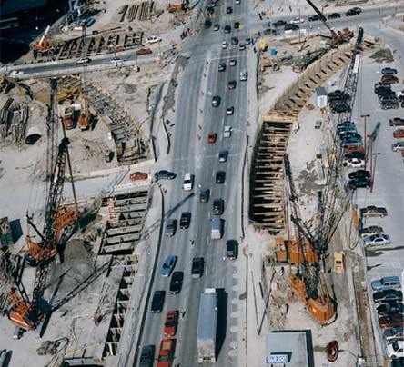

Oh, you mean this elevated subway,... looking southward along Yonge south of Highway 401 - elevated subway line would have ran right through Don Valley Golf Course. Original proposed YorkMills/Wilson? Station would have been 200m west of Yonge. Current underground Subway tunnel runs just east of Yonge Street roadway.
https://transit.toronto.on.ca/photos/images/ttc-york-mills-subway-model-1969.jpg
https://transit.toronto.on.ca/subway/5105.shtml
