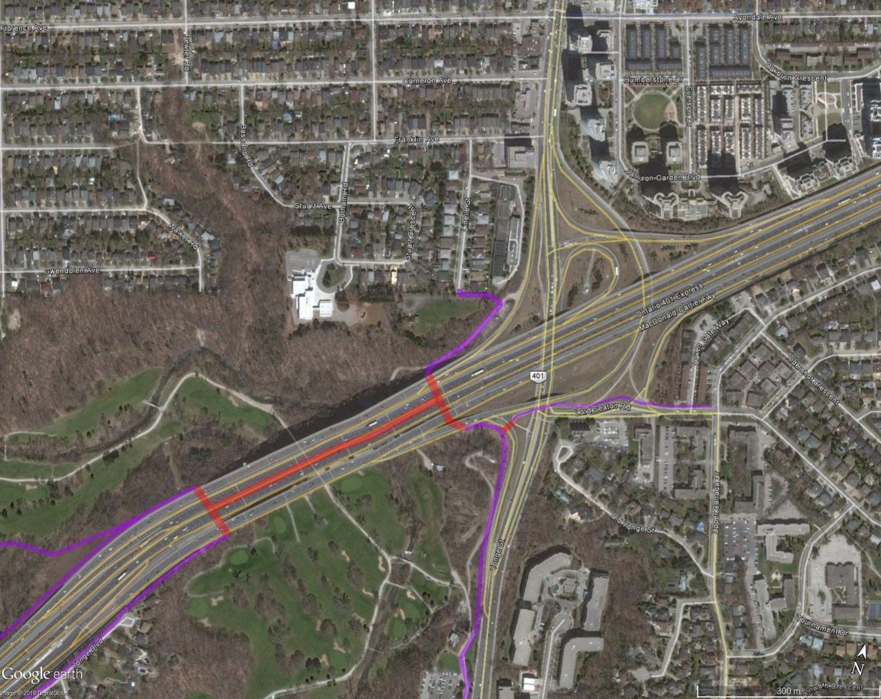

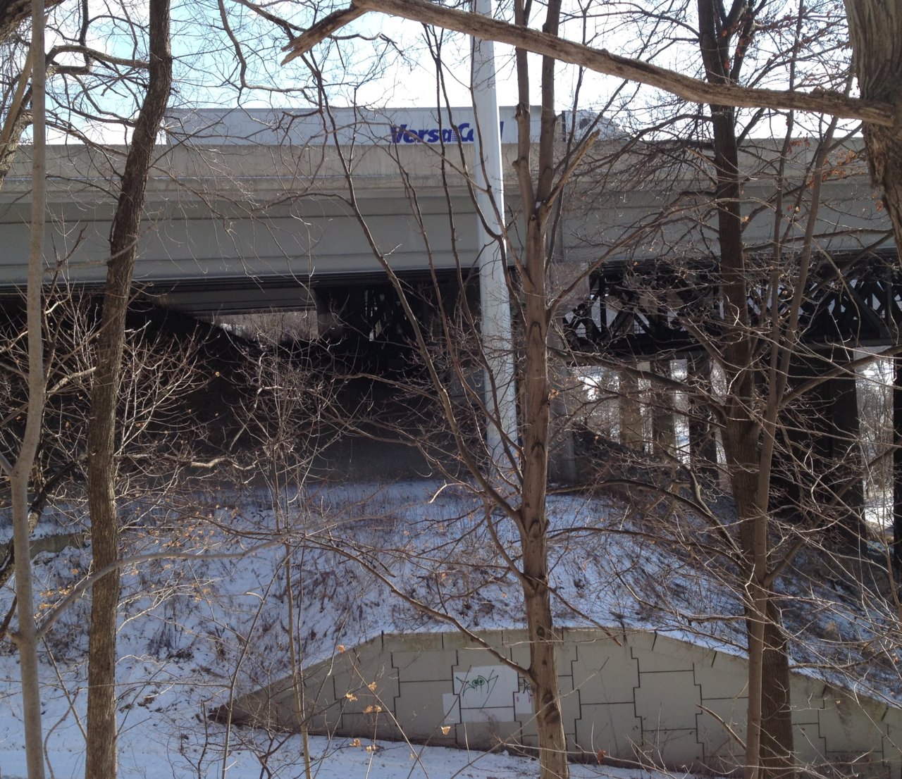

Why build a new tunnel when just 180m west of Yonge,... there's already a safe separate-grade crossing of Highway 401 (as indicated in first north-south red-line); it's really an under-utilized MTO dirt service road where valley ridge meets Hogg Hollow bridges:
This is what it actually looks like from north side of 401 looking south,.... at lower deck level,... about 30 feet high and 25 feet wide with hill side that can be dug out for 50 feet width before hitting bridge structure in hillside:

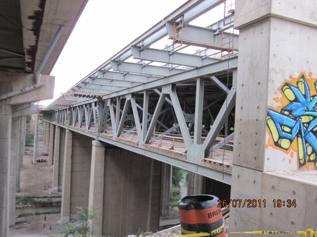

Yes, it's a construction access road used when they do bridge re-decking work - which they finished about 6 years ago,... so it'll be empty for another 20-30 years! Re-decking 401 eastbound express in Summer 2011:
Even though, MTO has CycleON policy as guidelines for municipalities on how to build safe cycling infrastructure near highway interchanges; the MTO has rejected multiple request from the City to use MTO's under-utilized and basically abandoned (as illustrated above) property and infrastructure at Yonge-401 to build safe cycling infrastructure.

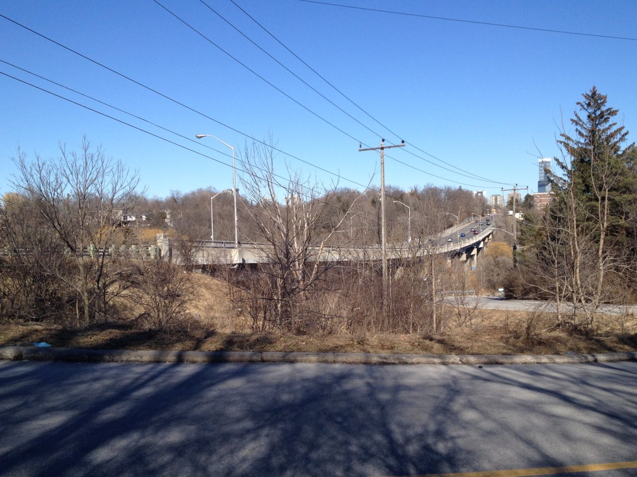

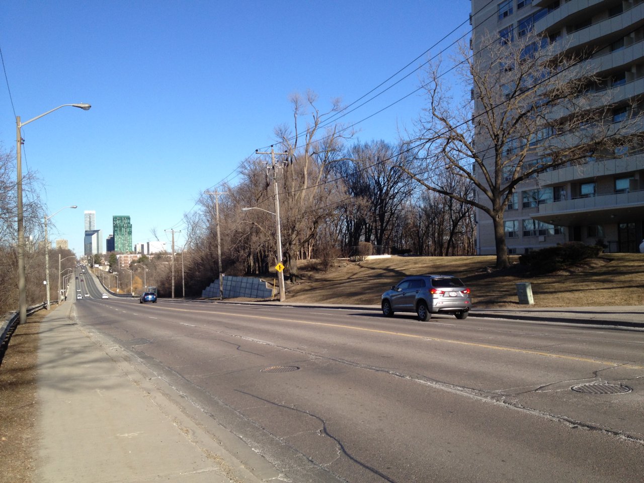

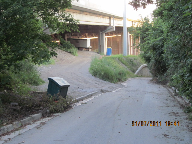

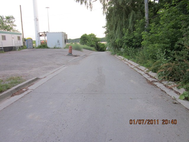

On the southbound Yonge to westbound 401 on-ramp, there's a gate to a Service Road (lead to service emergency TTC exit at bottom of valley) Gate usually locked on weekend and if open Monday to Friday usually MTO/contractor nearby,....
Going through gate and travelling along paved Service Road for about 150m:
Until you reach a dirt trail that goes under bridge structure near valley ridge
That leads to this separate grade crossing of 401,...
Note: the other side requires a bit of hiking to get to Radio Tower which has paved Service Road and then Golf Course driveway leading to William Carson Crescent,....
In the past, I've lead numerous "Jane-Walks" / hiking-tour for various local groups, special interest groups, politicians, City Staff from various departments, and yes,... even MTO! showcasing the potential here; especially since the large infrastructure are already in place, its really just connecting the dots between under-utilized Service Roads and dirt-construction path (used once every 25-40 years!),... so right now, there's lots of in-between places where you'd be carrying a bike!
Now,... define "Tresspassing",...
There's NO Tresspassing signage posted throughout the area around Hoggs Hollow Bridges,... MTO and their contractors, might occasionally have someone there Monday to Friday,.... hmmm,...

From the north (on weekend, the Gate is locked but most can roll under), I would suggest going:
- west along Franklin Ave
- then south along Stuart Greenbelt (marked in dotted purple line); the tributary/river is buried here with old (1940's?) asphalt trail on top that has disintegrated!
- just before you reach West Don River turn left (east) - follow well worn walking/hiking trail
- when you come across the fencing for the Service Road - turn right (south) and go under Hogg Hollow Bridges
- Here, on map - you're following the Solid Purple U-Shape path just east of the river
- follow the dog paw prints south and you'll figure how to go around the fence without climbing! Dogs are smart!

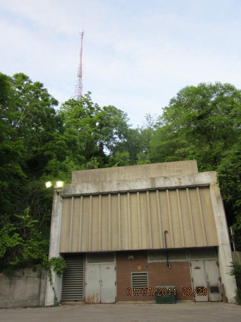

- at the end of the Service Road - bottom of Valley - you'll find this bunker-type TTC emergency exit/substation built into the side of the hill (red-X on map)
- near the top of that same Service Road at valley ridge is the separate grade crossing of 401 just under bridge deck.
