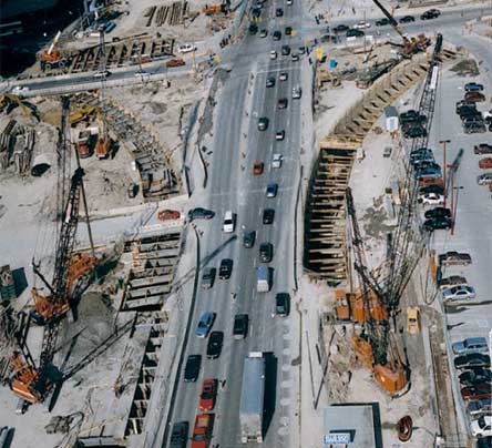

Image looking north along Yonge at Sheppard:
So existing Sheppard Subway Line 4 would interline with Yonge Subway Line 1 between Sheppard-Yonge Station and Highway 401 where it heads west under Highway 401.

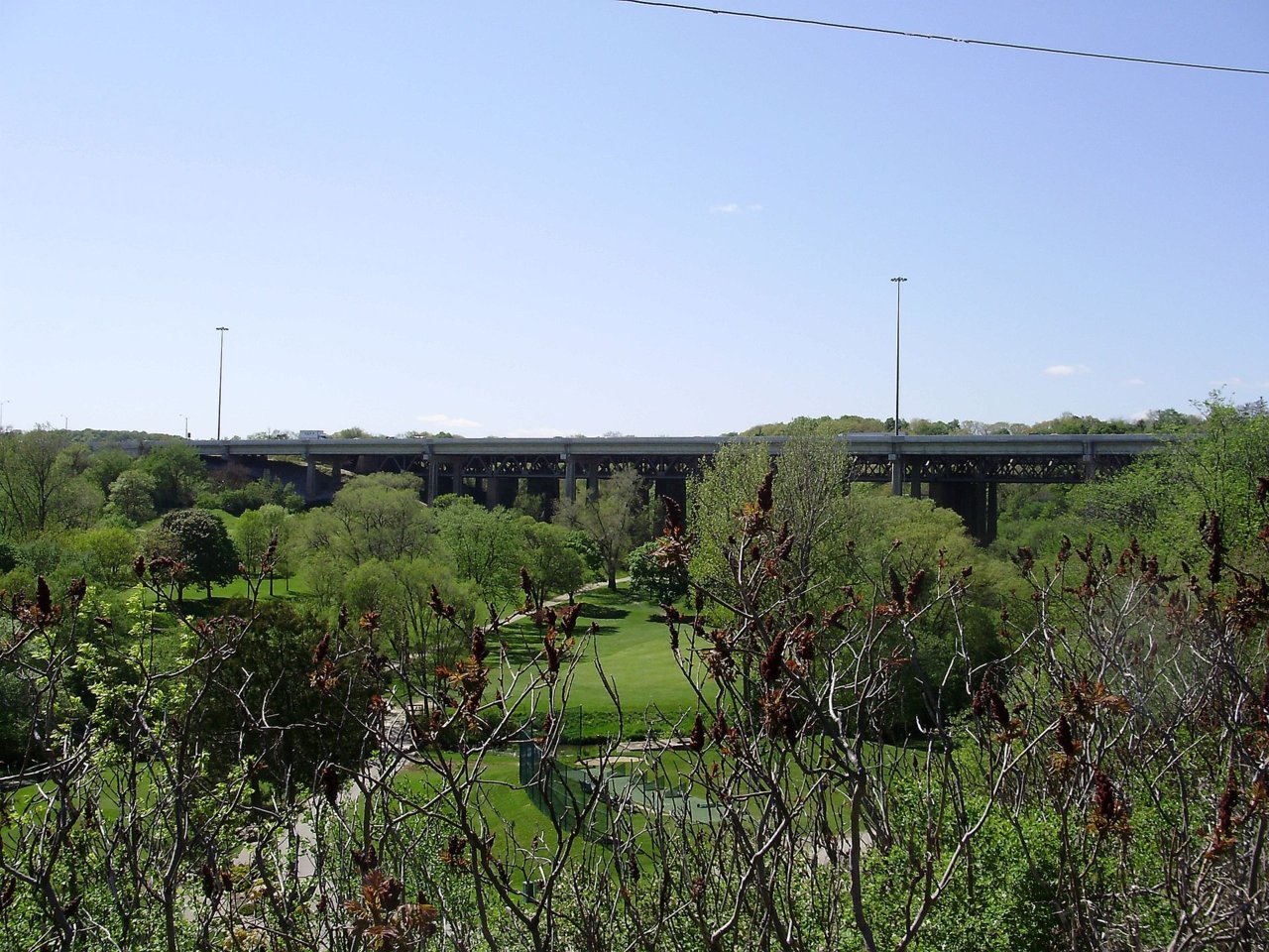

Highway 401 Hogg Hollow Bridges are actually made up of 4 parallel bridges:
- The two in the middle are Double Truss Bridges - upper deck for roadway and lower deck for structural support and currently under-utilized (somewhat similar to Bloor Viaduct is Double Truss with Arc support):
--- one built in 1929 (@ $1million when bread was 5cents a loaf, factor in today's $5 a loaf and I guess you get $100million per bridge!) as Yonge Blvd Viaduct as detour to avoid steep valley hills on Yonge Street - now host 401 westbound express lanes
--- the other double truss built in 1952 for MacDonald-Cartier Freeway - now host 401 eastbound express lanes
You would be right in that,.... these lower deck are NOT weight bearing - they can barely support catwalk - won't support subways! Really just rust flavoured jello!
- The two outer bridges are Girder bridges (like elevated Gardiner Express) built in mid-1960s as MacDonald-Cartier Freeway converted to today's Higway 401 Express-Collector system:
These 2 Girder bridges can host a subway line hanging from it's load bearing deck similar to this:
The new large single deck built between the two Double Truss Bridges (westbound & eastbound express) can also host a subway line hanging from it's load bearing upper deck (space is about 20 feet high and 25 feet wide):
Thus,.... no Hellium or Hot Air required!

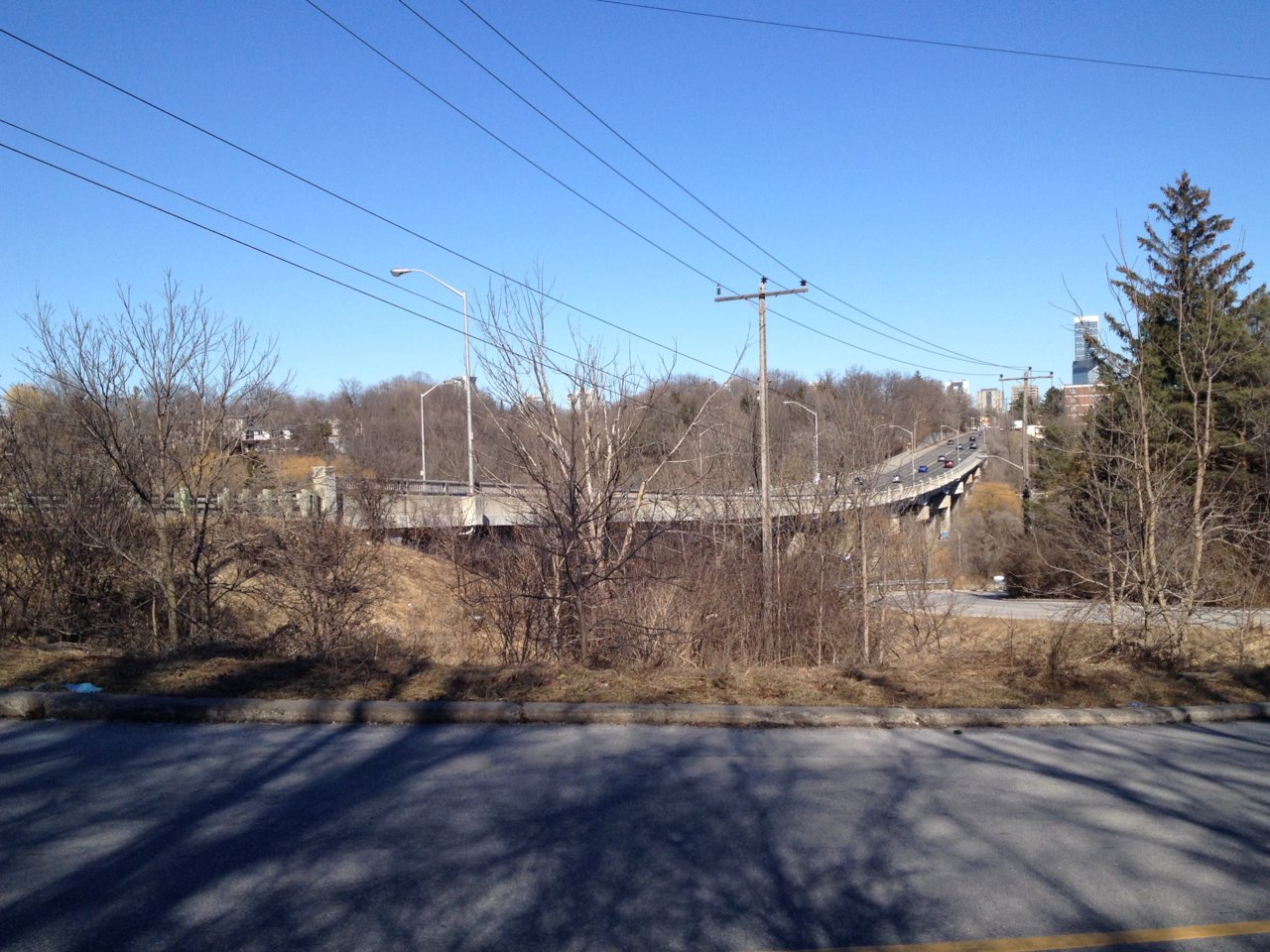

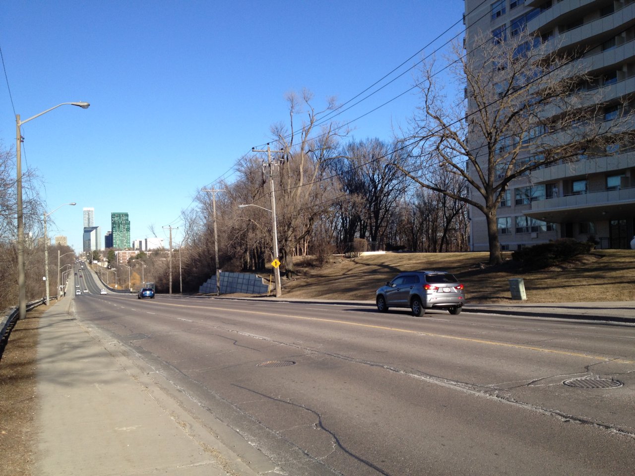

When I last checked over a year ago, mainly due to the technical challenges of crossing the WestDonValley, a westward extension of the Sheppard STUBway line from Yonge (actually Senlac tailtrack) to the current Downsview Station at Allen Road with only one new station at Bathurst was estimated by City Staff to cost $2.3 Billion.
The current 50+ year-old bridge isn't engineered for subway and would require a new bridge,.... and I'm hearing estimates of about $1 billion for the bridge!
Your $100 million per km bridge is sort of in line with our infamous Southbound Yonge to Eastbound 401 Fly-Over ramp,... really a one lane bridge spanning about 600m with estimated cost of $50 million (5 years ago).
Bridge prices will of course vary on height, length, design, material, load requirement, etc,...
The current Sheppard Bridge is a cheap half-bridge in that (as any cyclist is aware) the roadway goes halfway down the valley where you find a shorter and lower bridge,... VS the ridge-to-ridge Hoggs Hollow Bridges on Highway 401 that's so flat you're not even aware you're on a bridge (unless you notice the valley). Subway will prefer a very flat bridge.
With this bridge cost, this will likely reopen that Subway VS LRT debate,... and if Sheppard STUBway should be converted to LRT, and will Sheppard East be LRT or Subway,... hmmmm,... of course all this will be settled on the first day Doug Ford becomes Premier! Three more months to go!
