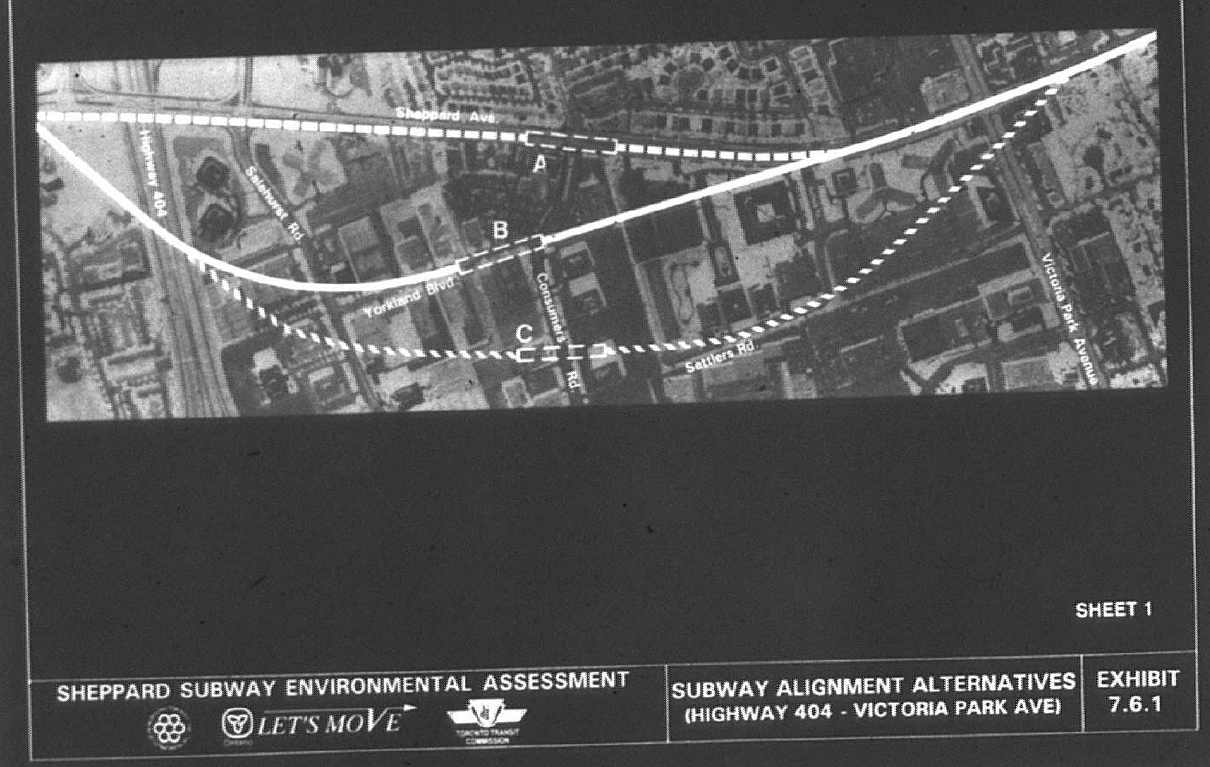

Consumers was always included in the planning back when the EA was done. There were even discussion about moving the station closer to the middle of the zone. I'm not sure how much documentation of that remains, but the illustration below is roughly what I can recall. It's certainly true that the trend now is to have fewer stations given the astronomical increases in construction cost.
These were the studied alignments - your memory was spot on, with the alignment and station at Yorkland/Consumers selected as the recommended layout.
From the Sheppard Subway Environmental Assessment (1992)
