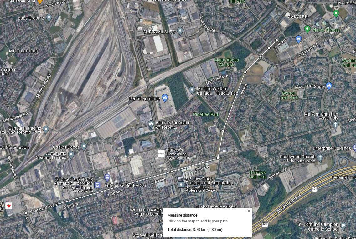

What would be the extra cost of extending the Sheppard subway from McCowan to Malvern Town Center with a stop at Sheppard and Markham Rd
Stations at a very crude level would be the same as above, but you have greater tunnel distance, ~3.7km or so.
That gives you a low-end range of 2B, to a top end of maybe 2.5B
There's a lot of fuzzy in there such as what land is used to build an above-grade station and how large that station is, and whether you could get closer to the surface and maybe cut and cover some of the route.
The route I show below uses the old Canadian Northern Right-of-Way north of Sheppard:

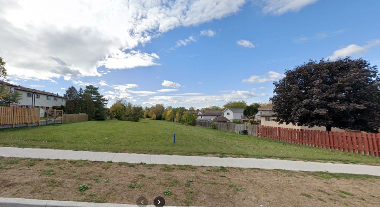

The ROW is 30M wide. In theory, wide enough for tunnel or trench; though you're running between backyards, so people would love that.
The ROW at Street level today:
