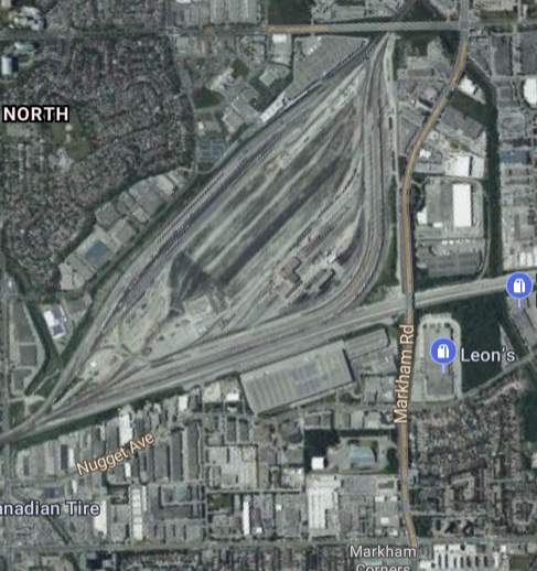

So you want to buy out 27 commerial properties, where people work, resulting in thousands of people losing their jobs? You're going to take part or all of an Amazon warehouse, a Leons, and a public park too!
PS, that'll cost you more than 15M a pop.
Full takings would be equal to 60 hectares of employment lands. Very conservatively 50% more than your high end number, probably more; that also doesn't include any inducements to remain in Toronto and relocate within same rather than close or exit the City.

Since this discussion is going in a loop, I'll repeat the "what about" concerning the huge and difficult to repurpose empty section of the rail yard located to the north-east.
