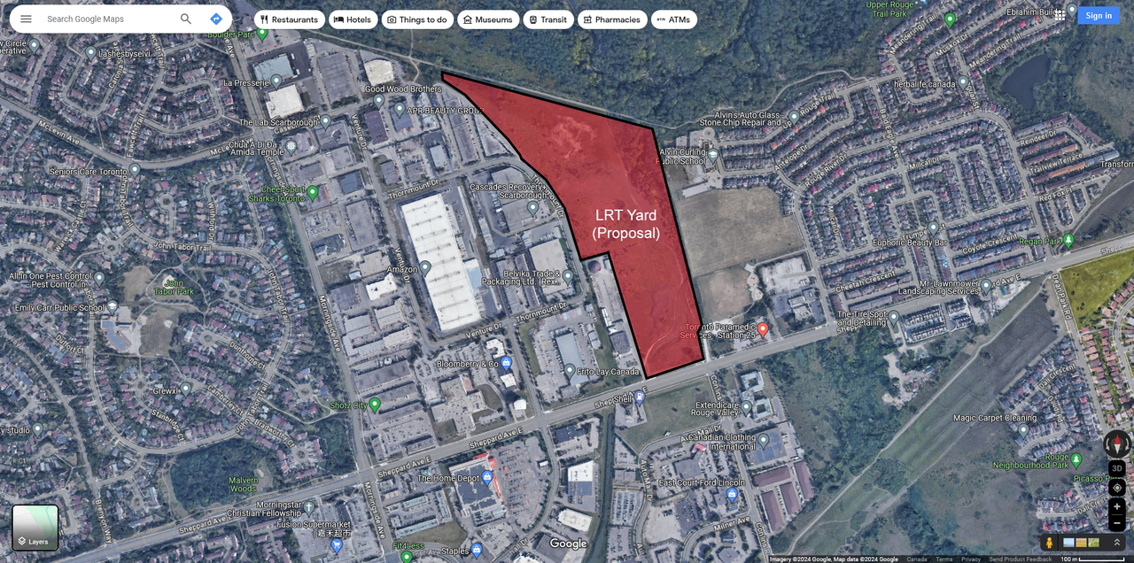

The yard for the Sheppard East LRT (and Scarborough Malvern LRT) was to be along Sheppard just east of Morningside Ave. I believe that is still the plan today for the Eglinton East LRT.

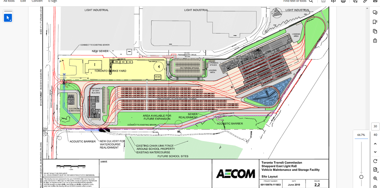

Just to add on here is the official plan from the Sheppard East LRT EA.
Going to the planned LRT MSF would add 6 km,so the line would be extended about 14km. That is almost as long as the current (under construction) line 5 is. If it could be done in 2 phases, it might sit better with the politicians.

EDIT: the proposed LRT yard was at Sheppard and Conlins.

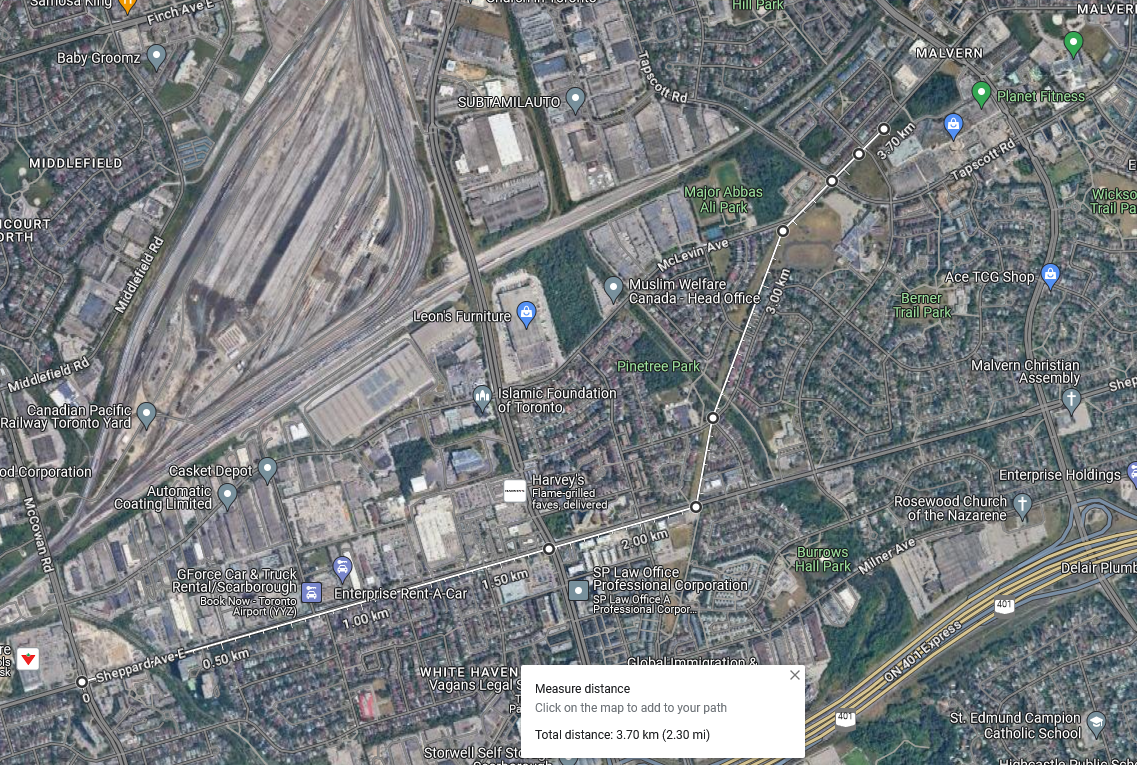

Stations at a very crude level would be the same as above, but you have greater tunnel distance, ~3.7km or so.
That gives you a low-end range of 2B, to a top end of maybe 2.5B
There's a lot of fuzzy in there such as what land is used to build an above-grade station and how large that station is, and whether you could get closer to the surface and maybe cut and cover some of the route.
The route I show below uses the old Canadian Northern Right-of-Way north of Sheppard:

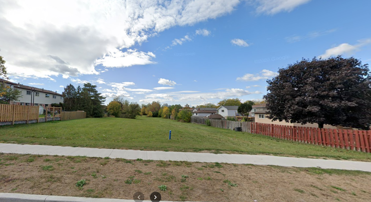

The ROW is 30M wide. In theory, wide enough for tunnel or trench; though you're running between backyards, so people would love that.
The ROW at Street level today:
Although, if the goal is to get a subway to Malvern Centre, then it might be easier to send Line 2 there. In the tunnel to the south of CP corridor, then turn parallel to the CP line, and continue at the surface level.
The area between the CP corridor and Nugget Ave / McLevin Ave is commercial, and can presumably be bought out, simplifying the construction.
The subway could switch to undergrpound somewhere between Markham Rd and Tapscott Rd.
Another possibility is connecting the McCowan subway station to Malvern Centre using LRT, and routing that LRT either south of the CP corridor or on the north side of Nugget Ave / McLevin Ave.
