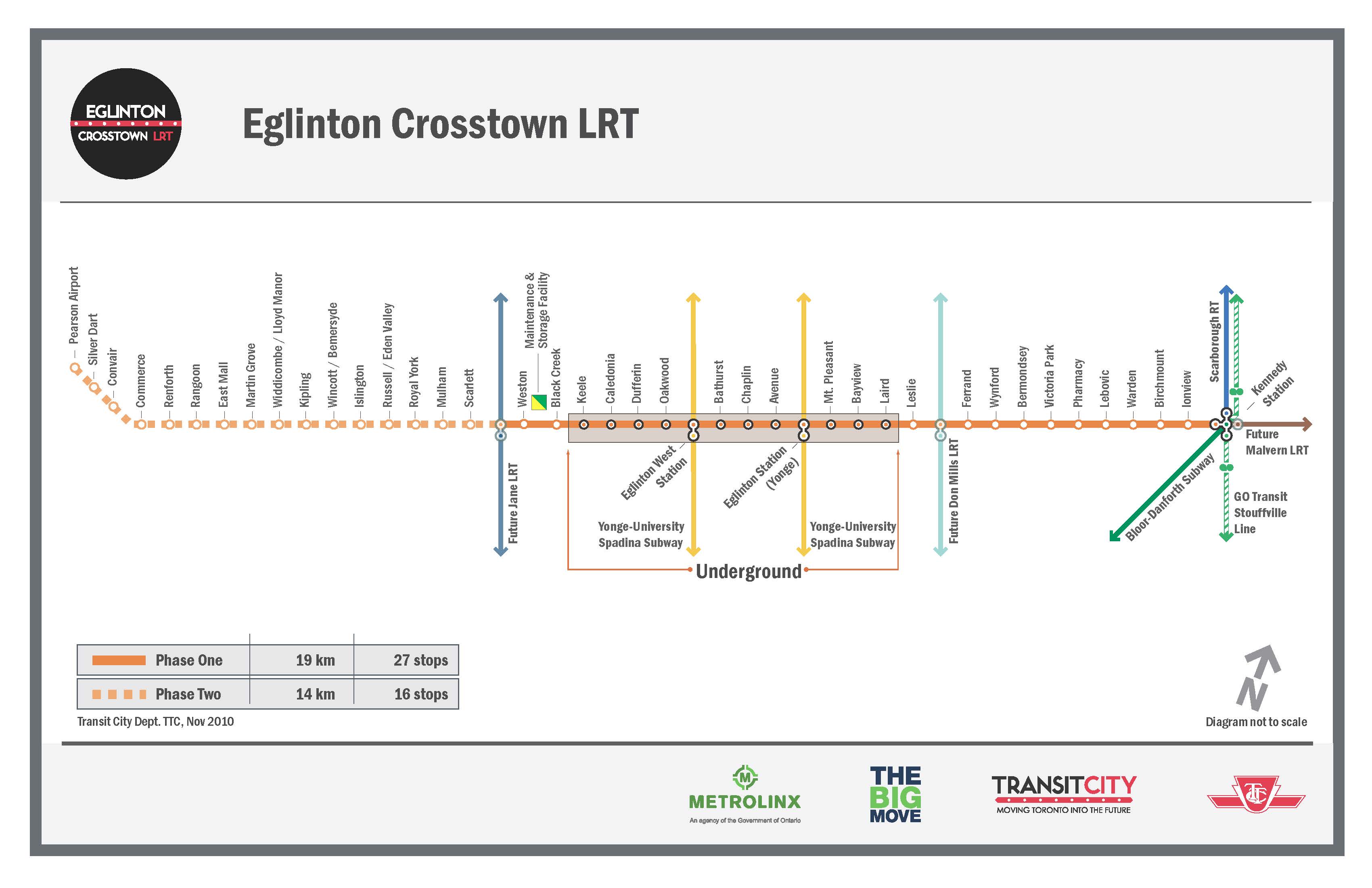

I highly doubt people would be transferring from a SmartTrack Eglinton West to the Eglinton LRT. If anything, there would be counter-flow traffic from people on the Crosstown transferring to SmartTrack for a quicker trip downtown.
Even if the goal is to send the western SmartTrack to Square One, it does not necessarily mean it has to run along Eglinton West.
Another possibility is to stay in the Weston Sub corridor up to the Etobicoke North station, then split off and continue south-west, roughly in the 401 corridor, reaching the Airport Corporate Centre.
Routing through Mississauga is a subject of separate debate, but the Toronto portion can probably be much cheaper if such route is accepted.

I have to agree with many on here regarding the Eglinton routing of SmartTrack; it makes no sense to run a heavy rail line on Eglinton West. The major assumption that an Eglinton alignment was based on; that the Richview corridor would still be publicly-owned land was flawed. A 2km tunnel under a quiet residential street with no intermediate stations would certainly be far less costly than tunnelling for 7-8km under a major urban arterial with multiple intermediate stations. Eglinton West will have its LRT extension.
Why not? If you're travelling to Yonge & Eg, or North York centre, or York U, you would.
At the December 11th meeting of Metrolinx, GO CEO Greg Percy states that the Crosstown will be used for the Eglinton portion of Smarttrack.
"The intention is use of the kitchener and stouville corridors, and eglinton crosstown west of mount dennis"

OR, OR...(and take this with a grain of salt because its logical, something Toronto is not familiar with as far as transit) we could just scrap the Eglinton West portion of Smarttrack and extend the Eglinton Crosstown LRT west along eglinton as it was originally intended to do.
A partly elevated and trenched extension is superior, imo. It would be far faster than the LRT as proposed.
It already has an EA completed (would need to be updated but is less work than a brand new one) and it fits with the geography of the area. Plus, it extends the Eglinton LRT along Eglinton. What a crazy thought.
We already are going to have two insane, poorly planned transfers in Toronto (the Sheppard subway requiring you to transfer to an LRT mid-trip, and the Scarborough RT requiring you to switch to a subway mid trip) lets not put another pointless transfer just to shoe horn an incorrect transit method down an already tight area.
Eglinton is a street, with residential development, and is more suited for an LRT, which already has been planned out.
Agreed.
However, we might be able to have both; Eglinton LRT in the street proper, and SmartTrack in the Weston sub corridor and then in the 401 corridor. Both combined might end up being cheaper then pushing SmartTrack heavy rail along / under Eglinton.
The LRT would provide local service, the heavy rail would provide an express connection to the airport business hub and Mississauga.

Took a deeper look at whether Eglinton can in fact fit a trenched Smart Track, and it may be possible, even if it ends up being a little tight.
Even if there is room to fit a trench, what about the not so minor issue at Mt Dennis? How will it curve from the rail corridor onto Eglinton? According to the G&M, "if the train goes underground at Mount Dennis, it cannot come above ground until just west of Martin Grove".
Make Eglinton West just an extension of the Eglinton Crosstown and have SmartTracks take over the entire UPX with half the trains {shorter one} heading to Pearson and the other longer trains going to Malton. NO one in Toronto is going to cry at the demise of the UPX.
A very good point. I forget how the Crosstown EA proposed to deal with the gradient of the Humber River valley, and I'm not sure if the G+M statement is accurate, but LRT specs for curvature and gradient are a lot more forgiving than heavy rail specs. The east side of the valley is the steepest - how you would engineer heavy rail to permit a station at Jane is beyond me.
