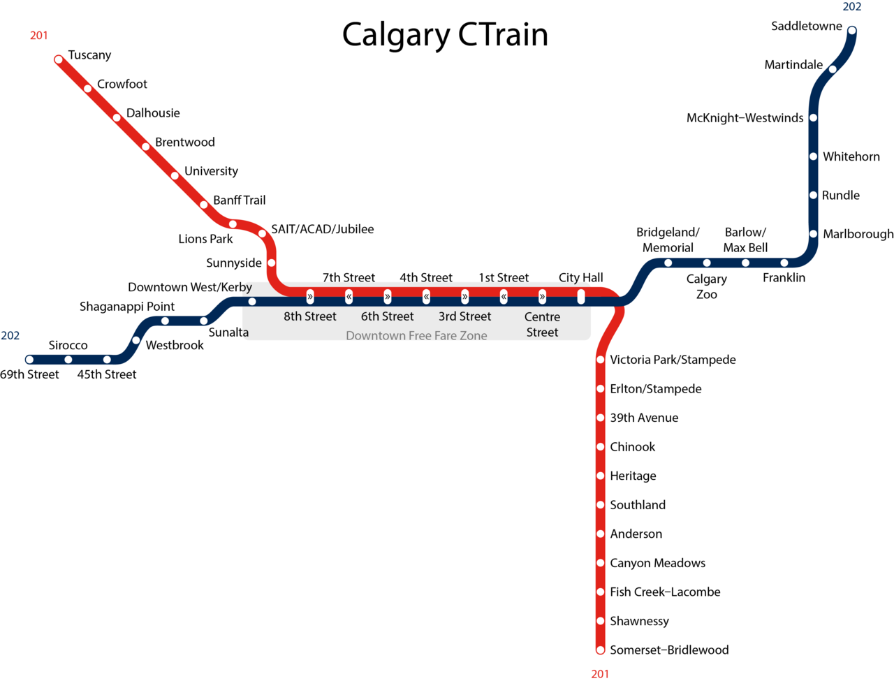

What happens is the central segment of rail is overlapped and highly frequent service in the core area, but diverges alternatingly on different spurs in the outer area.
Example, SmartTrack will alternate spurs, like C-Train:
(credit: wikipedia)
Metrolinx/Ontario says SmartTrack will behave like this -- All current indictions, is if SmartTrack proceeds, then every identical SmartTrack train will alternatingly take the airport spur direction versus the Bramalea direction. Same look, same train, same fare, same stops.

So if they choose 15 mins for the core segment and 30 minutes for the spur (taking turns). If N = 15 minutes, then every 30 minutes to Bramalea and every 30 minutes to airport. Recent Metrolinx information have been suggesting this is going to happen exactly, or almost exactly as, as I describe in this post. With further refinements, to corridor capacity, it could be N = 7.5 or N = 10 instead.
SmartTrack and GO RER (along SmartTrack route) is no different. The fare will be the same along the Bramalea-Unionville segment versus SmartTrack stations.
