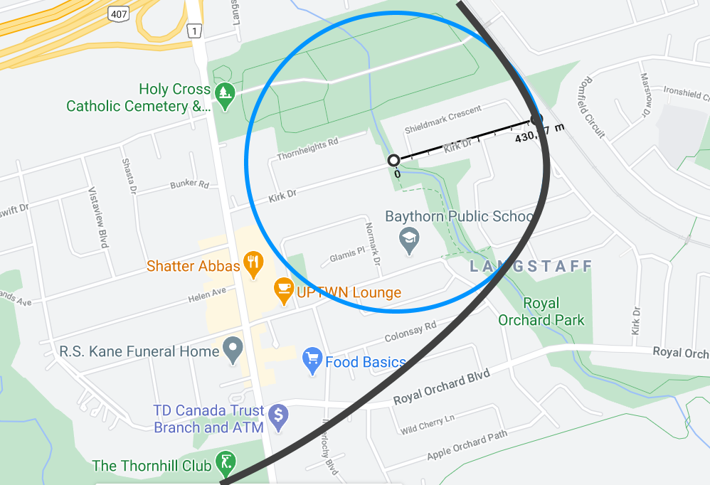

-Your hard left turn once it reaches the rail corridor is probably impossible for a subway to make.

You can make the radius of the left turn bigger if you want. The room is there. Alignment 3 in the Initial Business Case is actually, unbeknownst to me, a similar alignment to my map of having an acute angle turn along the rail tracks. It's not impossible for the train to make, atleast according to Metrolinx, it's pretty possible.

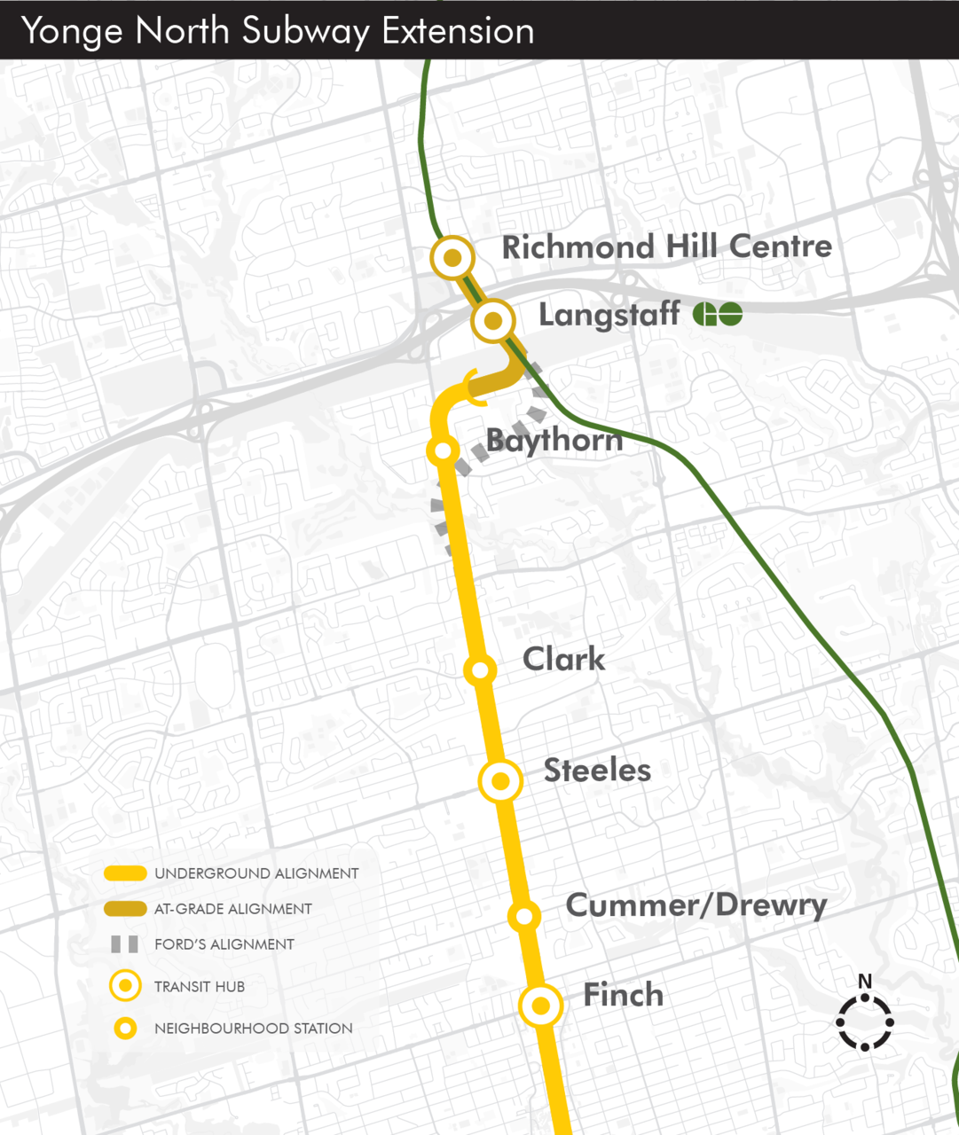

Quick map I made of what I think the Richmond Hill Subway extension should be instead.
An in-between the original all-underground alignment and Ford's new less-undergound-as-possible alignment. From Finch, it would go up north and turn east at the border of the Holy Cross Cemetary. It would come up to surface and then turn north when it comes to the train tracks to Richmond Hill Centre.
Obviously build Cummer/Drewry and Clark stations. A recent York Region News article outlined that residents are already unhappy with Ford's alignment of tunnelling under the neighbourhood near Royal Orchard. They would be even more unhappy if Ford tunnelled under their neighbourhood and does not even build Royal Orchard station to serve them. Royal Orchard Station was previously dropped from the original subway plan because it would have lower than Bessarion levels of ridership and growth. I propose putting a station slightly north at Baythorn to add more ridership closer to more existing homes and would allow more developable area, where there are many strip malls ripe for condos. It would be a shame if this neighbourhood gets zero rapid transit and just skips over, or under, them.
The residents complaining suggested digging under the cemetary instead as that would only disturb dead people. So I would suggest the subway to dig north and come out from the cemetary, thus saving tunnelling costs as per Ford's request. Then a station at Langstaff below Highway 407 as that is a high density urban plan area and would connnect to Langstaff GO Station. A station across the highway at Richmond Hill Centre would serve the high density urban plan area there and connect to Viva. The spacing in my proposal between these two stations would be closer to 700 to 800 metres as opposed to Ford's plan of High Tech and Bridge stations at 400 metres spacing.
I know you keep referring to this as "Ford's alignment", "Ford's request," etc. but I doubt he personally has interest in micromanaging subway alignments in the same way that us transit nerds do. This and the Ontario line both show the same kind of institutional thinking at Metrolinx that was present before Ford was premier. The original "Option 3" alignment was originally proposed back in this 2013 report, long before Ford was premier. So I don't think the "Ford's benighted map scribble vs. my enlightened subway solution" is a helpful framing.
Your map was posted a couple pages back and commented on but I'll repeat some messages:
  1. Tight curves are a bad thing for subways because it results in more tunneling, slower trains (since longer distance + slow speed for navigating curves), and more maintenance. The TTC has a design standard for curves for new subways that even the old Union station doesn't meet. The extreme curviness of the Option 3 alignment is from the constraint of not tunneling under the cemetery. Your alignment is even curvier, yet manages to be the most disruptive to the cemetery since it involves digging up the surface of cemetery. The original option 3 avoids the residential neighbourhood, but still avoids moving corpses.
    For the amount of corpses you are proposing to reinter, you might as well move the cemetery in its entirety across the street to the vacant plot on the west side of Yonge. Then you could run the subway diagonally in a trench and open up all the near-station land for more development in the Langstaff Gateway.
  2. The current "Bridge" location has the advantage of direct connections with the Highway 7 Rapidway, Langstaff GO (which has platforms north of Highway 7), and the future Highway 407 Transitway. Shifting Langstaff station south means that all those buses need to divert off of Highway 7/Highway 407 for a jog up to RHC, and it makes the transfer to Langstaff awkward.
    I agree 100% that RHC and Bridge stations are too close, but instead of shifting the Langstaff station south, I think it makes more sense to shift RHC north.
  3. If the main goal is to have a station at Baythorn and the Langstaff station further south, then returning to the alignment options that stay on Yonge is probably a better way to do it since the neighbourhood station (Royal Oak/Baythorn) constrains the curve for meeting the rail corridor.
  4. Personally, I would name the station "Thornhill" instead of "Baythorn" since it is on Thornhill Ave and is the only station in the middle of Thornhill. But Thornhill residents at Centre and Dufferin might disagree with that.
I'm not clear about your comment about cemeteries and sprayed chemicals. Generally cemeteries are treated as usable green space, used by joggers/walkers. I agree that they can be out of place sometimes, since many were built back when that part of the "city" was vacant and/or farmland, but I think we should still treat them with respect. But maybe banish any new cemeteries to the Greenbelt so we don't end up with conflicts like this.

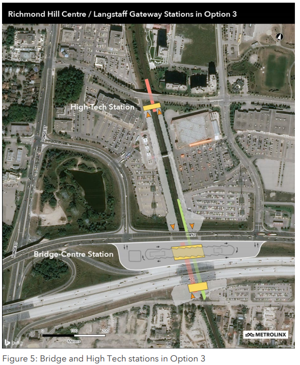

*No, that's false. Bridge Station is only connecting to the Langstaff GO Station. It is proposed to be right in line with Langstaff GO Station. If Bridge was slightly northwards, it would have a connection to the YRT Viva Bus terminal, but that would mean it's further away from the Langstaff development area. I've used Langstaff GO before. It is not connected to the bus terminal at all. It's long long walk there especially with the overhead pedestrian bridge. High Tech Station is the station that would have connections to Viva and the Highway 407 Transit way. The bus terminal is much closer to High Tech than Bridge stations. The Bus terminal would be around 100m from High Tech and possibly 300m from Bridge Station from where the alignment map shows the station. Bridge Station's advantage is for a GO connection, not a 407 or Viva bus connection. High Tech is what will have the more consequential connections.*
EDIT: I did not notice that the bus bay would have moved to a new location. Please ignore. Apologies.
Shifting Langstaff subway station south would mean the station would be in greater proximity to most people in the Langstaff development area. Bridge Station is literally inbetween two highways. A lot less people can access Bridge Station if it was there than let's say Langstaff station right in the middle of the the development area and connecting to the Langstaff GO station as well. A Langstaff subway station could very well be just immediately south of the GO station where the northern edge of the subway system could reach the GO station.
Shifting RHC/High Tech Station even further north as indicated in the alignments, would mean High Tech Station would be north of High Tech road. It'll mean it's much closer to the single family homes and less proximity to the mass of dense development at RHC closer to Highway 7. Making the northernmost station further north is a bad idea.
Good idea on Thornhill station naming.
I've no idea what cemetery you've been to that's as used daily as a park let alone a mass of joggers and walkers. A cemetery is one of the least usable green spaces (and with the chemicals used, it's not really green). Because you know, there are graves everywhere. I mean I guess you can pass around a ball between gravestones. Cemeteries are a waste of space that could be used for more housing or more park space. A cemetery is not a park, let alone many of them are gated. See this is where the generational and cultural divide comes in (I'm assuming). I don't see the need to respect cemeteries for wasting valuable land in a major city and a scourge on the environment with bodies releasing water and chemicals, the coffins releasing the varnish chemicals and the chemicals sprayed on the grass surface to keep the graveyard in keep. There have been many studies devoted to the effect cemeteries have on the environment. A WHO studied claimed that cemeteries are conceptually a type of landfill. Which they are. What if all the past cemeteries in New York City, Tokyo and Paris were still kept today because of respect? There would be much less space I can tell you that.
Please read the business case before making statements like this. Below is copy and pasted from page 37 of the business case here.
Bridge Station is the name given to this concept in the IBC. It would be an integrated transit facility located under the Highway 7 and 407 corridors. This location allows it to be accessed from both the Richmond Hill Centre and Langstaff Gateway development area. While the design has not been finalized the station has an opportunity to serve as link between adjacent urbanizing communities.
Perhaps most importantly, the Bridge Station has the potential to optimize and centralize subway access for the Langstaff Community. While previous concepts have included a subway entrance south of Highway 407 at Yonge St., this access has been challenged by being located on the western periphery of the Langstaff Gateway development area. The Bridge concept in Option 2 pulls the station entrance further east, while in Option 3 the station is in an even more central location adjacent to the rail corridor. As will be demonstrated in this IBC, in either of the options the western half the Langstaff site is more effectively served, while bringing far more of the developable area to the east within walking distance of the subway.
The station will feature significant bus facilities to serve Regional GO Bus Routes, and local York Region Transit routes. An advantage of the Bridge station location is the opportunity to integrate the frequent VIVA BRT routes into the terminal design, optimizing the connection between higher order transit modes. The Bridge concept puts not only the subway at the connection point of the two development areas, but it puts the full transit hub at the same location. Residents on both sides of the highway corridor have access to local and regional buses serving York Region and the wider Greater Toronto Area.
The Bridge station is also well positioned to provide a seamless connection with the Langstaff GO Station. This connection is valuable for not only transit users transferring between the Subway and Richmond Hill GO Corridor but will also allow GO rail customer to access the station with a common conveniently located bus facility.
The other strength of the Bridge station is that it seeks to take advantage of lands that are constrained for other uses. The Bridge Station and its associated transportation infrastructure are appropriately contained within the existing Highway 7 and 407 corridors, leaving as much of the adjacent development areas as possible free for placemaking development.
Oh thank you for pointing that out, I must have missed that part in the IBC, my apologies. Disregard my points about that. Then my criticisms of althe YRT bus bay like that is that it's not necessarily close to the population, it's abutted in-between Highway 7 and Highway 407. But I suppose that's a usable space for it. But if the bus bay was moved further north, yes, there would be possibly more turns, but much more people would be in proximity to it. Which just comes back to the point that the placement of Bridge and thus the bus bay is sandwiched between two impermeable highway infrastructures that reduces the possibility that more people will live around Bridge and the bus bay.
And the criticism of the placement of Bridge Station still stands in that it is much further north and away in proximity to most of the Langstaff development area. Seems like Bridge Station is there for the first thought of connecting to the bus bay as proposed rather than having more people live in close proximity to it.

Again, my curve is very similar to Option 3. Again, my map could afford a wider radius. There is room for that. I'm looking at my map and the zoomed in map for the Alignment options in the IBC and your suggestion that my curve is much more acute than Option 3 is not believable. They are quite similar in angle and radius. And Option 3 does dig under the cemetary, so there would be disruption to the cemetary anyways. Don't tell me the radius is impossible for the subway to handle, tell Metrolinx, because as you say, they've had an acute angle turn since 2012 and still continue to propose it.
This is Metrolinx's curve
Eyeballing it looks like a ~430 meter curve, which is already not great.
This is your alignment, the curve seems to be a little over ~150 meters. The cemetery is only ~300 meters wide and you are turning more than ~110 degrees, so for you to do the turn entirely within the cemetery means that <300 meters is the maximum minimum turn radius. But at that point you would just be cutting across it, not staying to the one end.
So yes, the curve is tighter with your alignment, which is natural when you only have a strip of land to work with vs. an entire neighbourhood to tunnel under.
The the bigger question is: You've avoided the disruption of tunnelling 25 meters below some people's homes to instead:
I'm suggesting moving it to Bantry, so it would be spaced evenly between Highway 7 and 16th Avenue. The two stations could have overlapping walksheds in the RHC area and "bookend" the development there. It would put it next to a bunch of highrises, not single family housing. But it would lose the direct link with High Tech road. High Tech road and Highway 7 are ~400 meters apart, so it's not really possible to have subway stops serve both without being close together.
