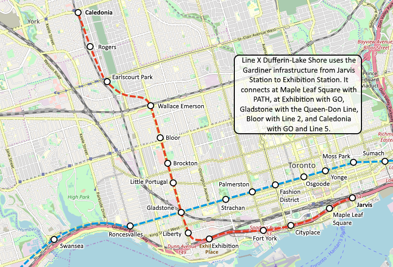

After reading through most if not all of the threads for various HRT and LRT extensions, I've picked up the habit of designing fantasy lines and extensions in my free time.
Here I drew out a westward extension of the Relief Line down Queen into southern Etobicoke, while a Dufferin-Caledonia LRT connects the line to Bloor east of Spadina. This route would then ride along the Gardiner Expressway (or outright replace it) from Strachan to Jarvis, with potential extension to Cherry Street or across the Don River. It would also connect to both Line 5 and the Barrie GO at Caledonia.
It is a good alignment, however I envision that line more as a subway than LRT since it will likely need to be tunnelled along Dufferin and other places.
If the line terminated at Caledonia Station on Line 5, then that would be perfectly fine. However, I do question where north of Eglinton it could go. I suppose it could veer west to Keele up to Downsview and turn west and interline with the Sheppard Subway. It would have to build up a lot of ridership through development activity along Keele. (Keele and Wilson area looks especially ripe for development)
While following the Gardiner makes a lot of sense, I wonder if maybe between Exhibition and Fort York stations, it could dip south to Lake Shore, to support future opportunities at Ontario Place.
Overall, I like this line a whole lot, because: A) I think Relief Line should go to South Etobicoke, that is where future growth potential resides; B) Dufferin needs an upgrade from surface transit at least all the way to Dupont; C) It addresses the transit needs of the waterfront east and west, which appears to be basically forgotten by the powers in place.
If the Exhibition station is kept (to connect to GO) and Fort York, I'm skeptical about whether a station at Strachan/Lake Shore would provide enough benefits to justify the cost. I would instead reroute the Spadina streetcar line to stop there, with a transfer at Fort York. Especially if this line is a full-on subway line.
I chose to terminate it at Caledonia because of the low density north of St. Clair, let alone in North York. I also didn't want to have it compete with a line on Jane. But if it is extended northwards, I can see it being routed through Downsview Airport to encourage transit-oriented development there, and then continuing into Line 4.
