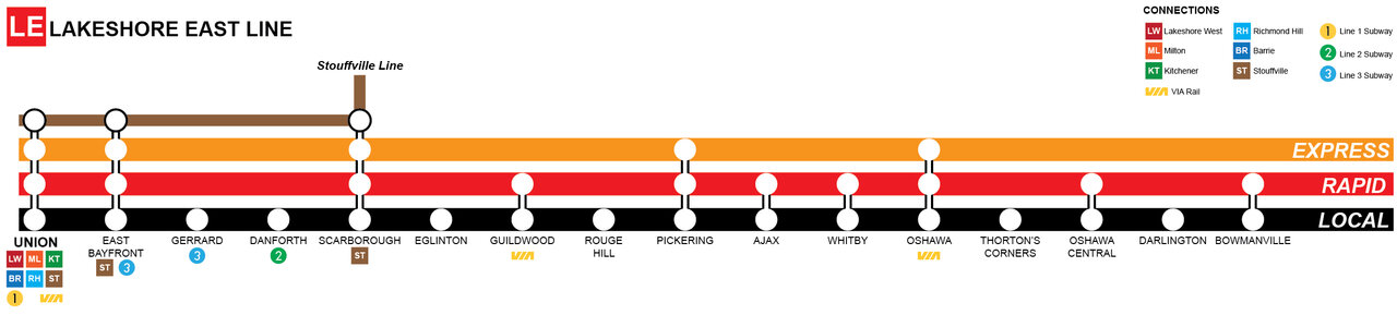

So I made this hypothetical service map for the Lakeshore East Line as part of GO RER just to see what could be done if we put our minds to it. Its based off of the service maps you would see in Japan; for example here's the map for the Odakyu Railway (https://en.wikipedia.org/wiki/Odakyu_Electric_Railway#/media/File:Odakyu-linemap.svg). Barring in mind the technical side of this type of service pattern, I split the line into 3 services; Local serving all stops, Rapid skipping some stops, and Express which skips the majority of the line. Locals and Rapids would operate all day in both directions, while Express trains would be peak-direction only. I don't think any of the other lines would have a 3-tier split in its service pattern save for the Lakeshore West and Kitchener Lines as they are probably the only other lines with the ridership/ridership potential to justify it. The other lines would probably be just fine with a basic Local and Rapid "skip-stop" services. I plan on making more of these for the other lines, so if you want to suggest better stops for the different services go ahead.

How many additional tracks would be needed to ensure Local could be kept at 2WAD 15 minute service without loosing any existing services? Does the line have the space for those extra tracks?

Well you really don't need more than 2 tracks to pull it off so long as you have enough stations on the line with passing capability and good scheduling. Since I am using Japan as an example for that map I will also use them for the explanation. That being over in Japan the overwhelming majority of train services only use 2 tracks; the various express services are maintained through the aforementioned stations with passing capabilities and some really good scheduling. In fact a single line using 4 tracks is almost unheard of over there with the only example coming to mind being the Odakyu Main Line, everyone else just uses 2 with some 3/4 track stations sprinkled in along the line. If we could pull off a Japanese style schedule or even something remotely close we would be spoiled for time slots along the line with 4 tracks when you consider what the Japanese can do with 2. Thus to me the complication isn't with track space as we have enough of that, but just adding some more track space to certain stations. Which ones depends entirely on the level of service we want to provide.

As aweful as that connection is. I think it's important to have at least rapid service stopping at Danforth, if not the Express service as well. Perhaps guildwood could be dropped instead

Do we have the space to add track at those stations?

I like the format, it's clean and easy to read. A few comments though:
1) It's unlikely that the local service would extend all the way out to Bowmanville. If anything, the service would be layered, with routes running local on the outer stretches (say Bowmanville to Pickering), and then running express or semi-express to Union. The local service will likely terminate at Pickering.
2) There's no large 'anchor' community like Hamilton on the other end of LSE, so it's unlikely there will be demand for the express route that you depict. LSW, Kitchener, and Barrie would likely be the only 3 routes to feature such a service pattern, given the size of the cities at the ends of the line.
3) Gerrard is unlikely to be warranted, given the connection between LSE/STF and the OL will be made one stop down the line at West Harbour, and that the Gerrard site will have an OL station.

2) I would argue that Oshawa is the anchor, even though it is not the end of the line. Just like LSW actually extends to Niagara Falls, but the anchor would be Hamilton.

It is, but it's nowhere the size of a Hamilton or a Kitchener. The population and ridership in Durham is pretty evenly distributed between the 4 stations there. Oshawa may have the slight lead currently because it's the EOL and sees a lot of drive-in traffic from further east, something that should diminish when the Bowmanville extension comes online.
By contrast, once frequencies to West Harbour increase, I think we'll see a significant increase in the amount of people using that station, and that's something that won't really be affected by the opening of Confederation or Casablanca or any of the other stations on the Niagara extension.
