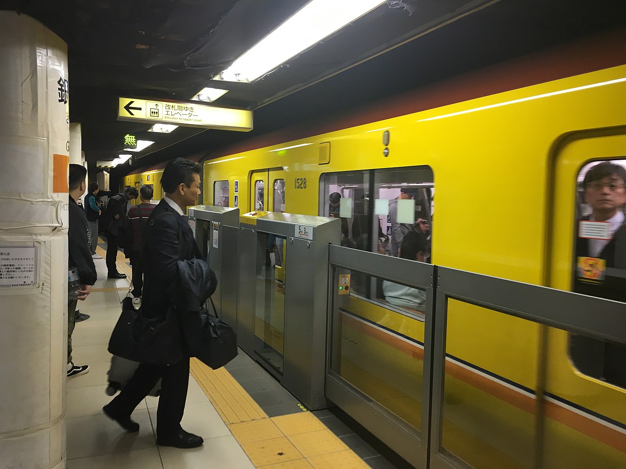

If we use "pretty" platform screen doors, it may hide those stains. Just put the station name on the screen doors. As well as transit information, along with advertising space for the accountants.

I honestly think we are making this out to be harder than it needs to be. Retrofitting the current network with full height doors is an nonstarter due to the high cost of having to install complicated ventilation work down to platform level. On the other hand using half-height doors would fix this issue and eliminate what would be the biggest expense. It would still be expensive since platforms would still need to be reinforced to hold up the doors, but at least we wouldn't need to deal with airflow issues. Newer stations which were designed with full-height doors in mind would obviously still get them, while the old stations would get half-height doors.
You are certainly correct that half-height doors would be far cheaper to install and would work almost as well.
