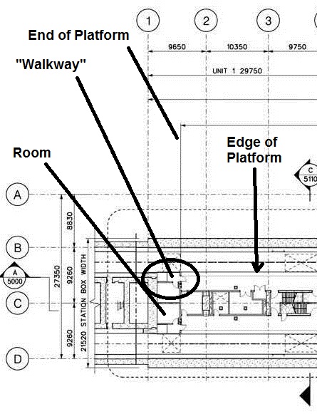

  1. Can the platforms actually be extended? I found this drawing for the Sheppard West (at GO) Station. It shows a platform length of 500' (152.4m), but it also shows two rooms about 4.0m long and 3.5m wide. It also shows a 2m wide x 4m long "walkway" a beside these rooms. It appears this "walkway" is the walkway for emergency exits from the tunnel - and not used for any equipment. Thus, this "walkway" would simply be converted to a platform. Due to its narrow width, this one set of train doors would only be for exiting cars and not entering. It appears that only one of these "walkways" is needed (i.e. at one end of the platform only) since they are longer than needed to fit the last set of doors. So the answer is, for this station, it appears the platform can be extended enough. Is this a typical station? Can it be done with the other stations? Do other stations have curved track immediately adjacent to the platform? I am not sure, but it is looking like the answer is yes, this can be done.
  2. Can this new 7 car train fit on the TTC track network. All tracks are switching to moving block in anticipation of ATC. Thus, any length of train will work and the signalling system can keep track of the front and rear of each train - not simply knowing which block the train is in. The last remaining concern is the various storage tracks in the network. This includes in yards, as well as pocket tracks. This is one thing I do not have an answer to - as I could not find any such drawings online.

Most Platforms cannot be expanded to fit a full 7 car train.
Closing off doors at the ends will only delay operation more at peak time.
Since the driver is to have full control and operation of doors, very hard to have screens in the tunnel for them to help in closing the doors.
What should happen when the new TR are move over to the BD, a new full 7 car train of equal length car be built that will fit the 500 feet platforms. Should had happen from day 1 for the new ones.
Going to a shorter 7th car will only have 3 doors and a different setup internally. Will be place in the centre of the current train.
