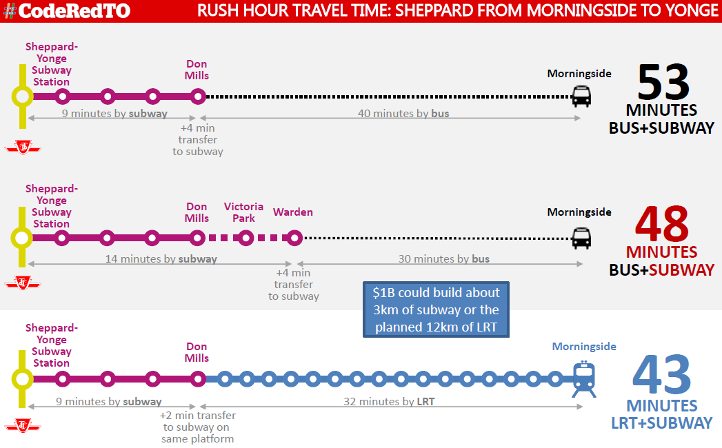

And yet it is faster than the bus. And even faster than instead extending the subway.
Note that this is AM peak, using 40-minutes from Morningside to Don Mills of 40 minutes. It's scheduled as 49 minutes at PM peak - if it's on time.

But analyze this from their point of you.
Does 8 minutes difference between LRT and bus warrant such an expensive project?
Does 8 minutes difference between LRT and bus warrants all the road disruptions and further paralyzing Sheppard Avenue East?
Wouldn't a proper BRT be able to reduce that 8 minutes gap?
People actually preferred the Sheppard line to be extended further East and keep the bus. That's 2 Minutes differences in bus service without disruptive work on Sheppard East except at the site of the new stations. It was clear that they had an agenda with Sheppard East and people got hostile to the idea.
Instead of telling people that they just don't understand and they will never get the subway, they should have listened to the feedback and cut a few stops while running local buses. Why not add some grade separation at major intersection to increase the reliability of the line and further increase the speed? If that 8 minutes gap became 15 minutes, It would be either under construction right now or in service. But they were too busy acting like they knew better than everyone else.
The LRT itself wasn't a bad idea, but it was poorly planned and sold to the population. Sorry but subway + bus made way more sense to me and most people in the area than 100% LRT the way it was designed.

8-minutes was the then-current AM peak travel time. It's 17 minutes for PM peak.
Remember that the whole point of Transit City was to deal with the forecast deterioration of travel times by 2031. Traffic on Sheppard East is forecast to get significantly worse, if nothing is done.

The time difference is a best case scenario. Also, people were puzzled about the city not considering a combo of BRT and subway or enhance LRT with local stops provided by bus. But they wanted their project and rejected everything else. You're having the exact same attitude. You're adamant that this is the best project but you refuse to recognized that the LRT could and should have been enhanced for greater speed.

You have to take into account the slight loss of time and extra inconvenience for those transferring for bus to LRT to subway who previously went bus to subway. Especially West of McCowan. Elderly, Handicapped, Parents with young kids not much savings and not an improvement in convenience.
I can understand some support and slight time savings from East of McCowan, but even then the bus is not too bad on that side to begin with. But for those who now have to take and extra transfer in their commute, it makes little sense.
