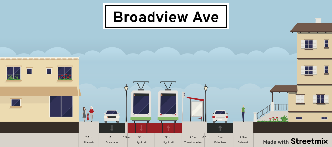

Didn't know about the sidewalk minimum thanks! It is a tight squeeze when accounting for stops and shelters though midblock there is totally room for wider sidewalks and even other street furnishings.View attachment 475832

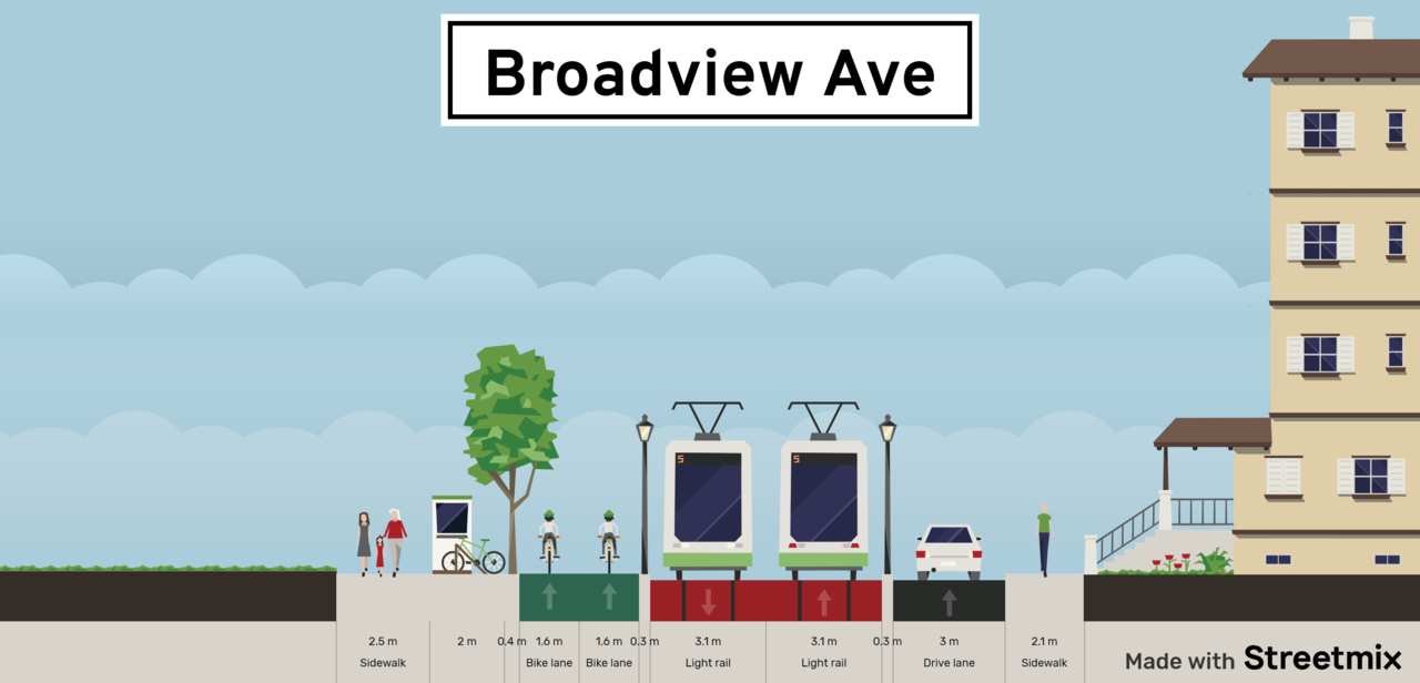

I should note the broadview idea was just for north of gerrard by the park. South of gerrard there are enough businesses that likely need deliveries that I think road access should be maintained on both sides, though they would be low priority. View attachment 475833
that 2nd pic is exactly how every street that is 20 meters wide with a streetcar route should be organized.
the key point here are that those narrower older streets downtown can accommodate a ROW for bi-directional streetcar traffic, as long as street parking is non existent.
great job.

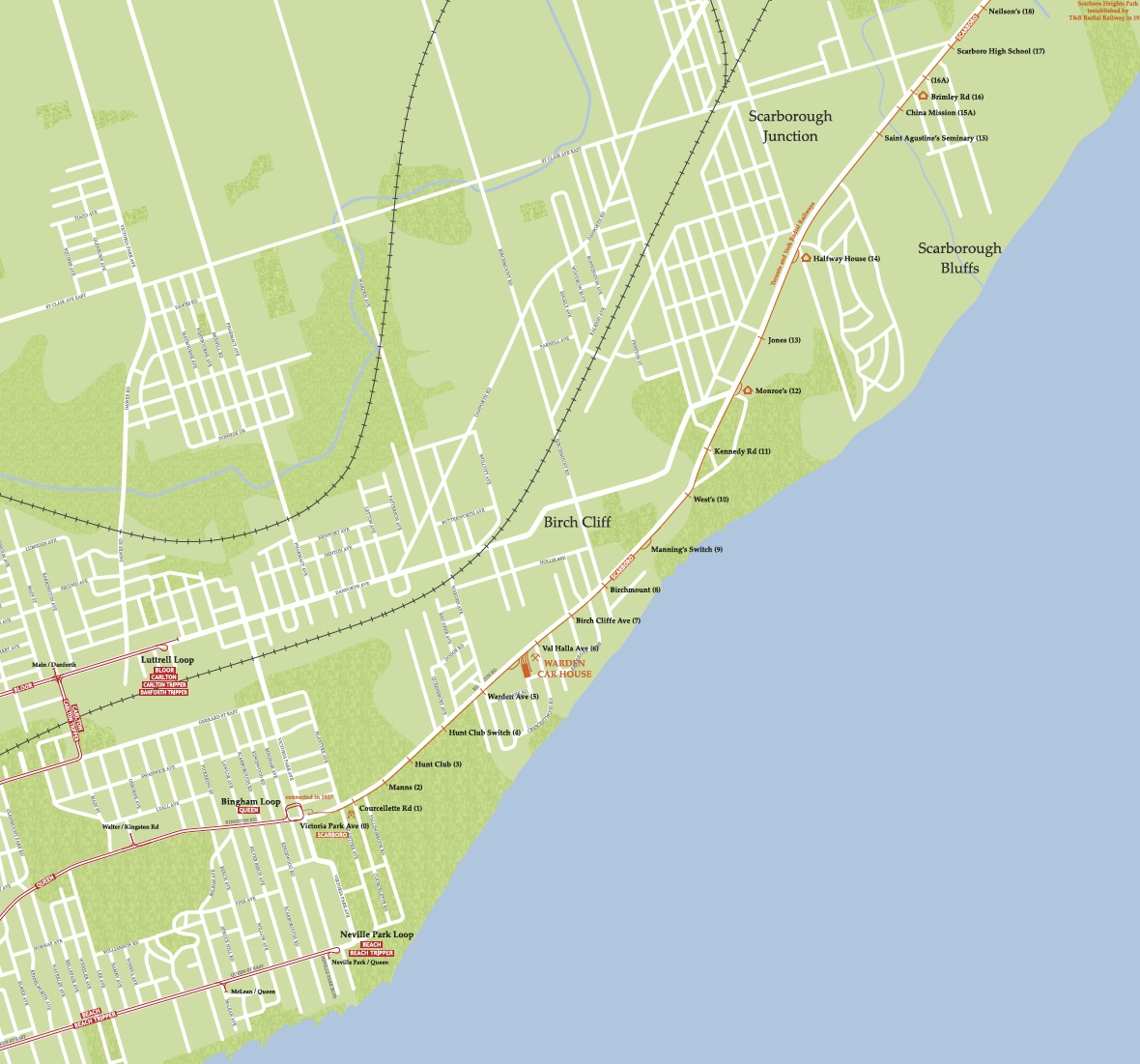

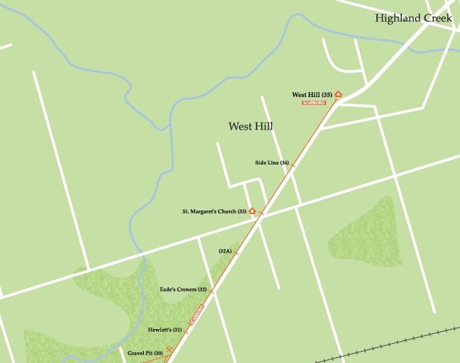

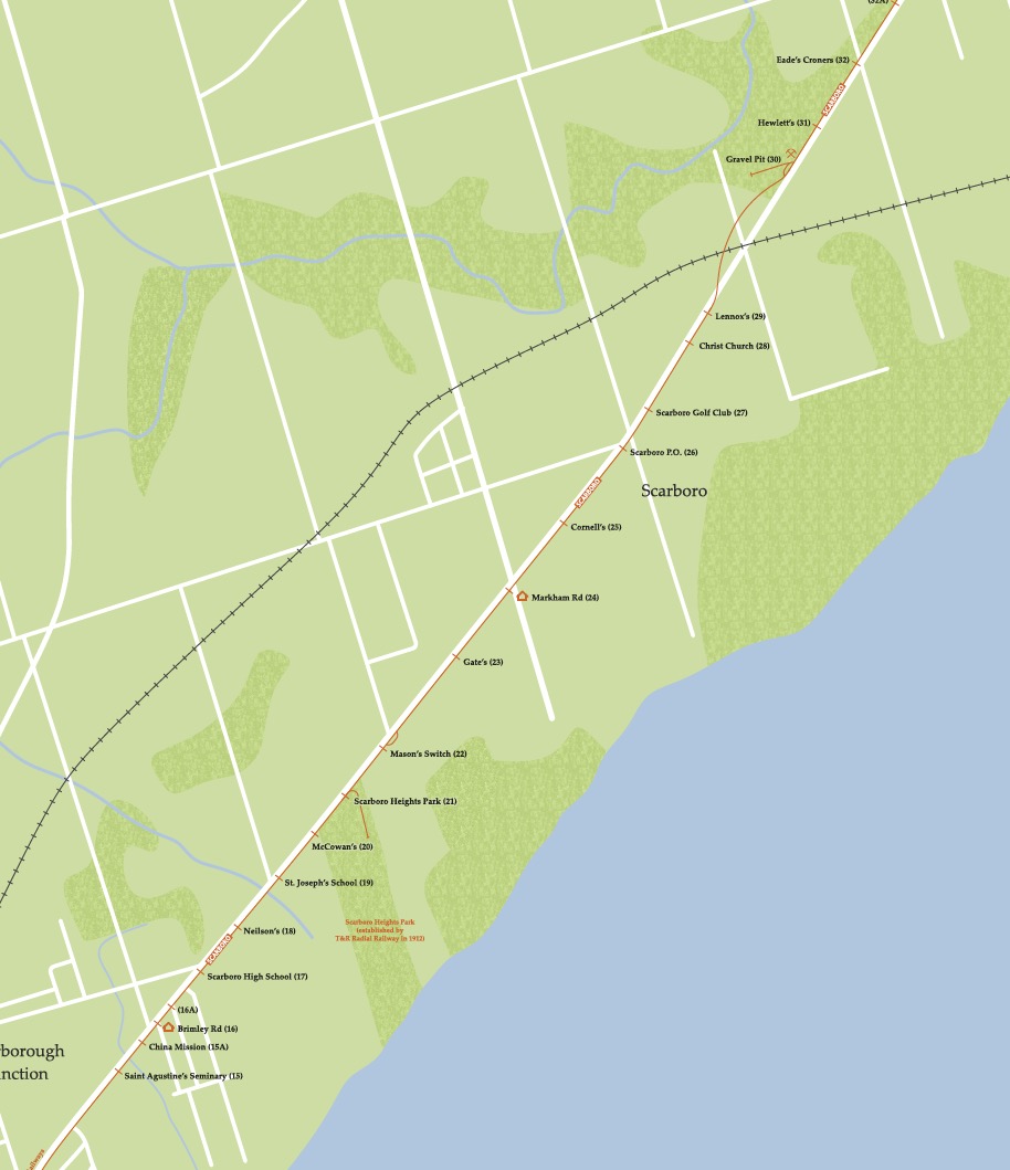

Now the proposed Eglinton East LRT (from link)...
FwQbwIRaAAchevV
Why don't we extend the Kingston Road streetcar tracks to Eglinton & Kingston Road to meet up with the Eglinton East LRT (shown as "Scarborough PO", stop 26)?
