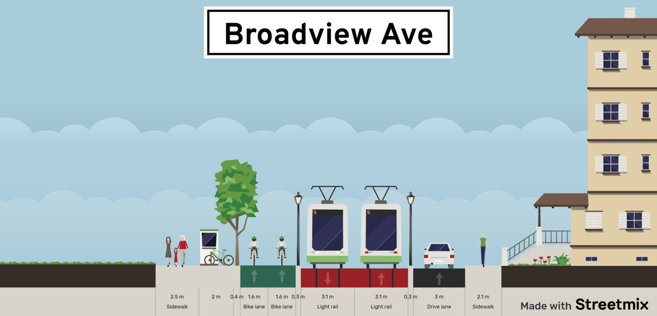

I have witnessed on multiple occasions on the projects I work on where the City has justified using the "constrained" minimum or use of MUPs to reduce sidewalk width. I would certainly be disappointed if they took an approach in the suburbs and refused to budge on narrower right of ways.
I applaud the ambition, but just to note, the City's minimum standards for accessibility require all sidewalks to be 2.1M wide at the minimum.

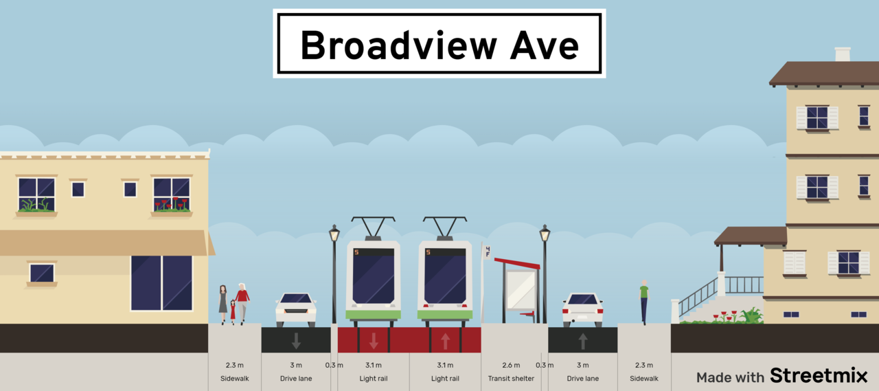

Didn't know about the sidewalk minimum thanks! It is a tight squeeze when accounting for stops and shelters though midblock there is totally room for wider sidewalks and even other street furnishings.
I should note the broadview idea was just for north of gerrard by the park. South of gerrard there are enough businesses that likely need deliveries that I think road access should be maintained on both sides, though they would be low priority.

@KhalilHeron
Good work.
Another note for you for any future work.
In general, the minimum width for a space containing trees is 1M wide. (more is preferable)
(if you're thinking of an open boulevard).
If you want the trees in pits so that you can encroach further, you need to think of how to sustain tree (likely an open grate system over the pit that you can walk on); and silva cells underneath to create more room for root growth.
The grate would still need to be 1M across, minimum, but it can be fairly easily walked over by most people. However, it would interfere with an MUP (wheels and grates can be an issue), and may also pose a problem for those with mobility aids (walkers etc.)
