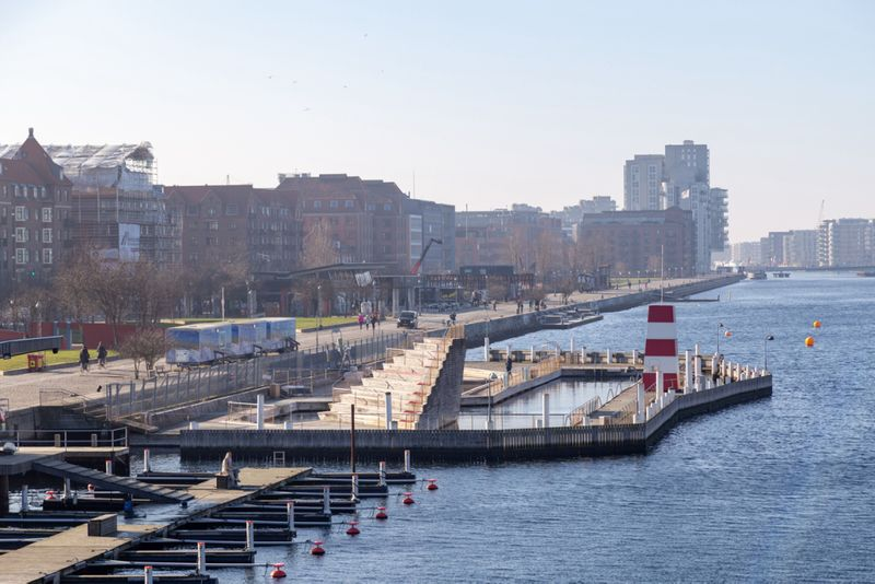

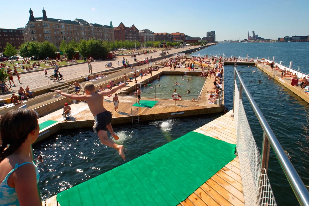

I hope some of the swimming ideas happen from this concept. Swimming plus accessible (portable, probably) saunas would be awesome. Something that works like Havnebadet Islands Brygge in Copenhagen would be ideal.

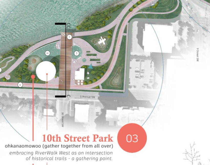

The plan calls for a heated outdoor pool actually:​
Wouldn't that cost a lot to operate in the winter? I wonder if this gets cut for funding purposes or just becomes a typical indoor pool, that area could use it too. We sorely need another round of recreational investment, this time not at the edges of the city.

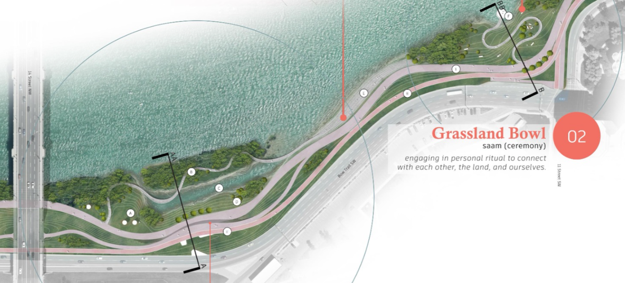

It seems the city has quite a bit of land to play with on the south side of 5th Ave, so it would be pretty easy to re-route everything to 5th Ave and 11th St (though it wouldn't really take any more space than the existing sidewalk that is pretty useless). How big of a loss would the Pumphouse AM lane reversal be? It wouldn't be impossible to keep it, but it would be nice to snap our fingers and have the pathway twinned
CalTRACS says 1200 vehicles peak peak westbound in the PM, 800 eastbound in the AM peak hour in May, 2024. That is a marginal drop from pre-pandemic.
Peak hour on 9th east bound (west of 11th) is 4900 vehicles (May, Wednesday). Left turns 500, straight 2400, right turns 350 (August, Thursday). So, raising those by 50.7%, 753 left, 3617 straight, 528 right.
I can see moving those 800 vehicles from the reversal to 9th could push that intersection much closer to failure. Have to remember that before the reversal was in place that many many more vehicles traveled into Sunalta during rush hours.
The concept, keeping in mind that's what it is and it is not a plan, shows the reversal lane being used as a bike path (pink pathway beside Bow Trail). Could the actual plan still use a reversed lane on Bow Trail to dump cars onto 5th Ave at the corner of Bow Trail and 11st St. I think so and don't see why not?
For reference, the concept reduces the five lanes to three on 5th Ave west of 9th St.
