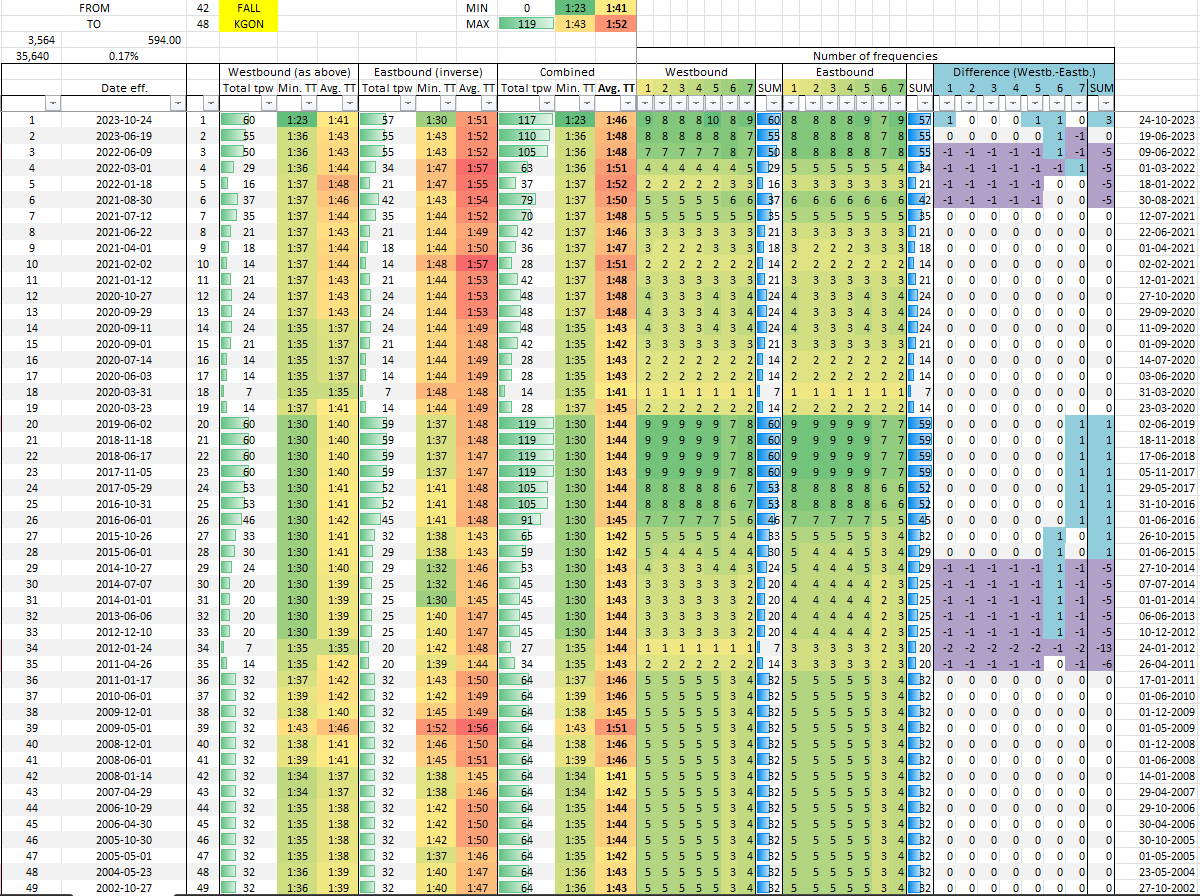

Interestingly, a travel time of 90 minutes between Kingston (dep.) and Fallowfield (dep.) has already been achieved with Train 42 in the January 2014 schedule. Even more ambitious, however, is the planned travel time of 83 minutes between Fallowfield (dep.) and Kingston (arr.) for train 43, which already achieved 90 minutes for the last few pre-covid years:
This is an older, incorrect version of above table, as pointed out in the two posts following this post:
Compiled from: own VIA Rail timetable archive

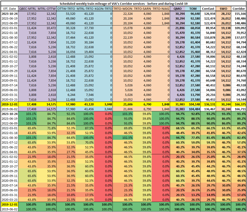

More generally, we are up to 93.3% of pre-Covid timetable volumes:
Wow that 83 minute travel time for the new VIA 43 is absolutely wild. That's a 141 km/h average, which seems quite unrealistic given those slow zones in Brockville and Smiths Falls. And unlike VIA 644 where the ambitious Kingston-Fallowfield segment is followed up by abundant padding, the rest of VIA 43's schedule to Toronto seems very ambitous.
And what's happening in 2012-01-24? In the table there is only one train per day from Fallowfield to Kingston, but in the timetable from your archive, I see:
VIA 41: dep 05:55, arr 07:30 | MTWTF__
VIA 641: dep 06:58, arr 08:34 | MTWTF_S
VIA 51: dep 08:56, arr 10:31 | MTWTF__
VIA 643: dep 09:20, arr 10:55 | ______S
VIA 55: dep 12:45, arr 14:35 | MTWTFSS
VIA 657: dep 15:32, arr 17:13 | MTWTF_S
VIA 649: dep 18:36, arr 20:20 | MTWTFSS
So 6 trains per day on weekdays, 2 on Saturdays and 5 on Sundays.
Thanks for pointing this out! I had "indirect trains" (e.g. T-O-M trains) deactivated, which is only useful when you don't want T-O-M trains show up for queries like MTRL to TRTO. I've swapped out the table, but kept the old table in a Spoiler for reference purposes...

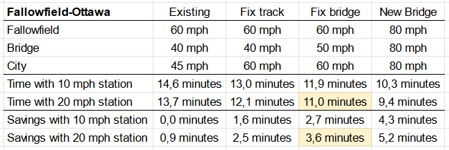

To get a sense of how much time could be saved by fixing up the tracks between Fallowfield and Ottawa, I made a quick model of the line assuming linear 0.3 m/s/s acceleration and 0.6 m/s/s deceleration
Here's the existing conditions:
I looked at a few scenarios:
- Fix up the tracks from the Rideau River to Ottawa Station to be 60 mph instead of 45 mph, which is already possible with the existing alignment.
- In addition, get the Rideau River bridge up to 50 mph, which was its historical speed according to @crs1026.
- Get the whole thing up to 80 mph somehow, which would include lots of infrastructure work namely a new bridge.
For each option I also separated out a sub-option where the limit within Ottawa Station is raised to 20 mph rather than 10 mph.
The main takeaway here is that there are diminishing returns as track speeds increase. The biggest bang-for-the-buck appears to be fixing up the Ottawa Station rail corridor to allow 20 mph, since that saves nearly a minute with what is presumably only signal work. Replacing the bridge with a new alignment doesn't seem like a worthwhile expense given that most of the savings can already be achieved with the existing alignment which would be orders of magnitude cheaper to upgrade.
So my preference would be to upgrade the existing alignment to its fullest (highlighted).
