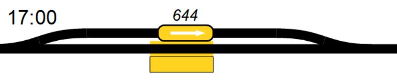

Here's how the meet works between trains 644 and 647:
At 17:00, train 644 arrives and serves the station. I don't know which track it uses, but let's say it uses the siding.

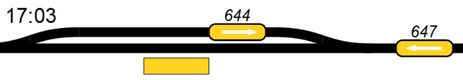

At 17:03 it departs, but the single track ahead is occupied by train 647 coming westbound. So it can only roll forward to the end of the siding.

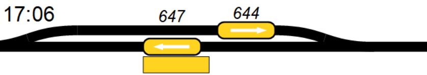

At 17:06 train 647 arrives at the station on the main track which is now available because train 644 has finished loading.

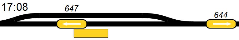

Finally once the switch is thrown, train 644 can proceed eastward.
As you may have noticed, this manoeuvre only creates about a 5 minute delay, which is far less than the 30 extra minutes in train 644's schedule. But this manoeuvre only works if both trains are exactly on time. If train 644 is any more than 3 minutes late, it wouldn't be able to clear the station in time for train 647's arrival. It appears that the other 25 minutes of extra time in 644's schedule are schedule padding which allows VIA to always prioritize train 647 over 644 (which makes sense since delays to 647 could have cascading effects down the line).
So in the very likely event that train 644 is more than 3 minutes late, it wouldn't be able to start unloading until 17:09 when 647 clears the platform. So it wouldn't depart Fallowfield until about 17:13 at the earliest.
This situation could be improved by building a second platform at Fallowfield station, allowing two trains to serve it at the same time without delaying each other. Extending the double track eastward from Fallowfield to the Rideau River would further reduce the delay caused by train meets by providing a larger margin of error for timing the meets. Increasing the track speeds to 60 mph along the current 45 mph zone from the Rideau River to Ottawa station would reduce the amount of time trains need to occupy the single-tracked segment, additionally reducing the delay caused if two trains meet at the single-tracked segment.
As you may have noticed, this manoeuvre only accounts for about a 5 minute delay, which is far less than the 30 extra minutes in train 644's schedule. But this manoeuvre only works if both trains are exactly on time. If train 644 is any more than 3 minutes late, it wouldn't be able to clear the station in time for train 647's arrival. It appears that the other 25 minutes of extra time in 644's schedule are schedule padding which allows VIA to always prioritize train 647 over 644 (which makes sense since delays to 647 could have cascading effects down the line).

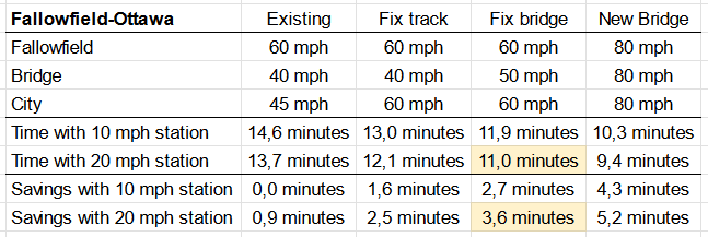

The main geometric constraint I see along the line is the bridge over the Rideau River, which appears to be a double-track structure with single-track spans and fairly sharp curves on both ends (which currently have 40 mph limits). If not for these curves, this would be where trains could be travelling the fastest, as it's halfway between the two stations.
There are three main options here:
1. Leave the bridge as-is, with single track
2. Add a second span to the existing bridge, or
3. Bypass it with a new double-tracked bridge which would allow continuous 70+mph operations.
Conceptual alignement for a new bridge in yellow. Would require acquisition of 2 industrial properties and 2 residential properties.
^Building a new bridge is probably beyond the scope of a "quick fix", but it's exactly what a proponent might decide to do down the road.

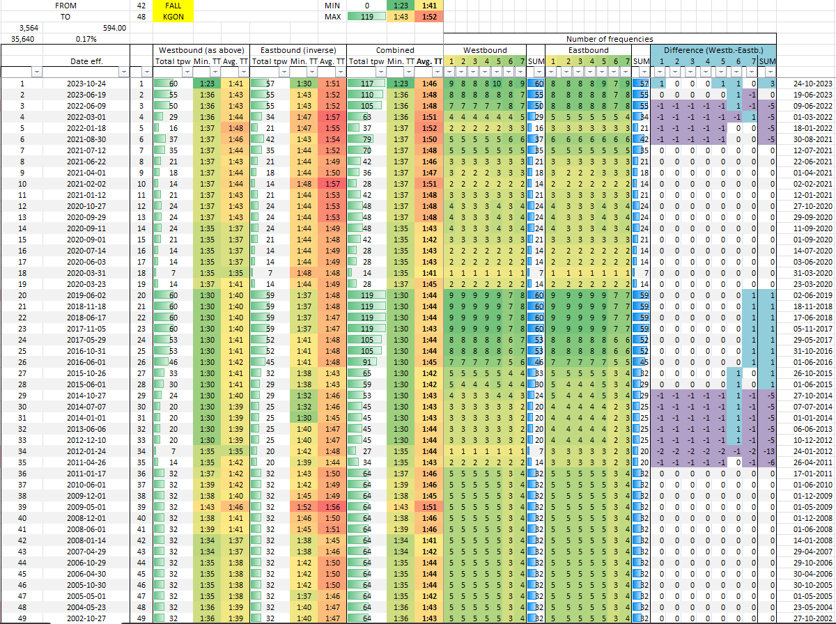

I don't know where reaperexpress found that wonky schedule with 50 minutes from Fallowfield to Ottawa but it doesn't seem to be valid. I checked VIA's site for that day and there is no train from Kingston at 1530. There are trains at 1447 and 1638. Both show 17 minutes from Fallowfield. Which is too slow but only by 5 minutes or so.
