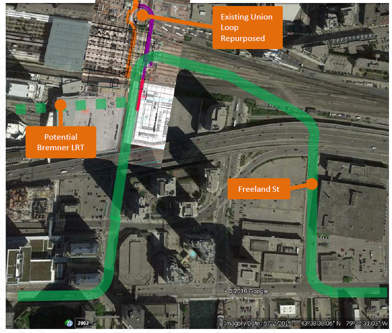

Quite possible - also I don't know for which configuration. Some versions include even more platform space for the Bremner streetcar line ... I don't know what happens to that if they turn Bay Street into a walkway (probably a underground loop west of York and Bremner, or turning up and/or down Spadina to King or Bremner, looking at the various June 2016 options.
I don't hate the Bay/Freeland proposal ... is that still floating around? It solves the through traffic on Queens Quay versus Bay Tunnel dilemma, with a simple everything runs though but no loop solution.
