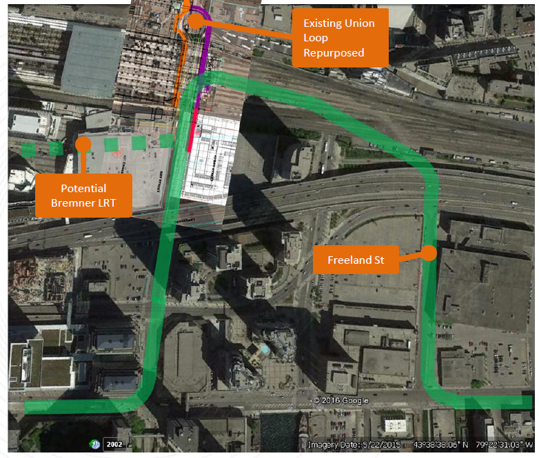

Quite possible - also I don't know for which configuration. Some versions include even more platform space for the Bremner streetcar line ... I don't know what happens to that if they turn Bay Street into a walkway (probably a underground loop west of York and Bremner, or turning up and/or down Spadina to King or Bremner, looking at the various June 2016 options.
I don't hate the Bay/Freeland proposal ... is that still floating around? It solves the through traffic on Queens Quay versus Bay Tunnel dilemma, with a simple everything runs though but no loop solution.
Something like this is the best by a long shot, and I really do hope it's still floating around. Solves a lot of issues, still Union-centric but would offer high vehicle/pass. throughput considering the lack of a loop. I can't envision a surface transit mall working well at all, and the moving walkway is simply silly. A continuous underground tunnel with a repurposed loop however...it's a winner. I don't think we've seen it costed though, but I can't imagine it being all that much more than the original loop expansion.
I can see the transit mall working but I don't see the need for double ended cars. A loop could be formed going around old city hall and/or via Richmond-Sheppard-Temperance. It also allows for many other operational routing options. New routes could be formed by turning off Bay onto King using it is a quick return to Spadina. You could have a scheduled downtown loop run in the AM or PM rush depending on the origin-destination demands. As Union I would:
If you shifted the E-W part of the tunnel so it was north of the rail corridor, you may be able to tack its construction onto the development of the 3rd Bay Park tower, or whatever is done by the new owners of the Dominion Public building...build the tunnel and station into the lower levels of those towers.
