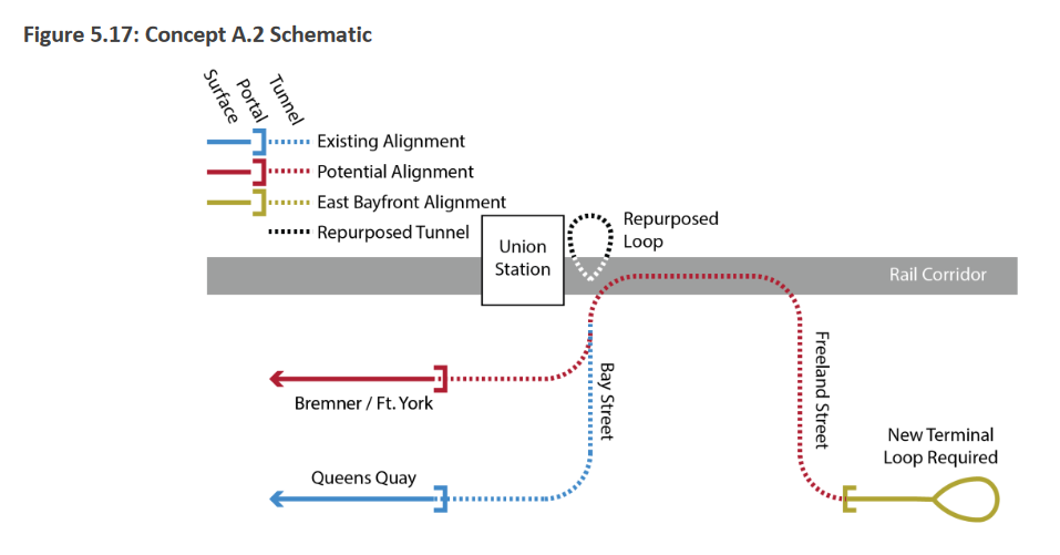

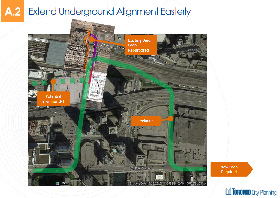

I don't think extending the loop east was in the EA. Seems a fairly fresh concept, and one reason I laud the Reset. And if I had to argue which was more of an 'expansion', the old plan or extending the loop east, I'd say the latter. The amount of breathing room offered is way bigger...it's the real expansion. I guess we'll find out if it survived Phase II (I think it has).
This requires digging a tunnel below grade along the path of the rail corridor. From what I understand, that would be a very expensive endeavour (I hope you can prove me wrong).
