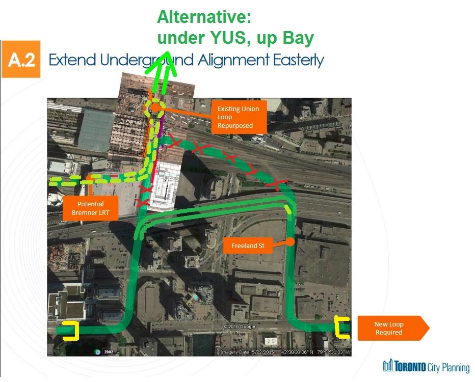

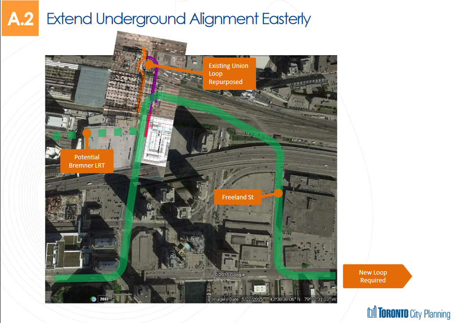

I don't think extending the loop east was in the EA. Seems a fairly fresh concept, and one reason I laud the Reset. And if I had to argue which was more of an 'expansion', the old plan or extending the loop east, I'd say the latter. The amount of breathing room offered is way bigger...it's the real expansion. I guess we'll find out if it survived Phase II (I think it has).
Is abandoning the loop not the same as abandoning the SRT - we are subtracting transit instead of adding it.
Can QQE and QQW not divert up (underground) to Lakeshore? The cuts the walk down to a reasonable amount.
The Bremner line would use the loop, or possibly get extending north via the loop to under Bay (and under YUS).
Not sure, but can Bremner/Fort York not go onto Fleet and go to the north end of Exhibition. Then QQW could follow Lakeshore or Princes' to serve the south part of the Ex and/or Ontario place - and continue on to be the WWLRT.
