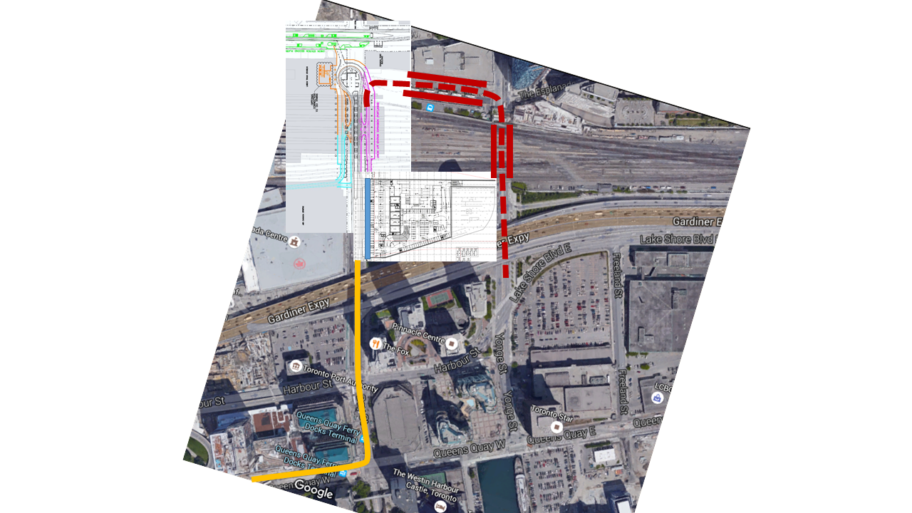

Esplanade has the Backstage/L Tower pedestrian tunnel at the p3 level, so that one would be hard to manage. Below I threw all the current drawings together. Looks like 45 Bay contemplates a platform much further south than the original loop expansions.
Also, you could likely get an agreement to build a station in the basement level of 141 Bay, right behind the Dominion Building. I'm not sure the sewer situation on Yonge, but you might be able to bring a tunnel back down under the Gardiner and get to ground level by Harbour.

Great work overlaying these images. Definitely makes it easier to understand what's going on in the area, or at least much better than any of the presentation images provided by the City. If you were to add to this, might I suggest also overlaying the future road network as proposed in the Lower Yonge Precinct's TMP.

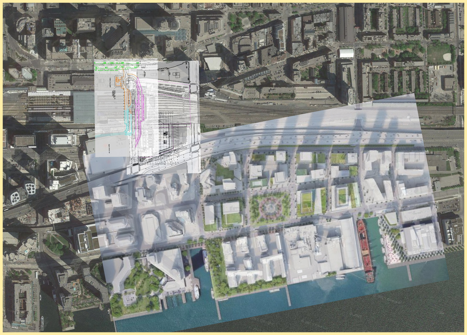

The lynchpin in the whole plan IMO is Union. To add onto @jcam 's post further up I created an image awhile back that shows the Union connection overlaid with the Lower Yonge Precinct plan, new roads/connections, 45 Bay, and original loop proposal. It doesn't do the area full justice though because we now have a better idea of what's proposed on the LBCO lands, the extent of development spreading east of Jarvis, and that an oblique angle would naturally do a better job at showing the enormity of heights/density envisioned. Still, if anyone wants to use it as a template to create a fantasy proposal of how the line could connect to Union, they're more than welcome to. When looking at the last report it's clear that as of right now the City/TTC is actively exploring alternative ideas in place of the original loop expansion.
