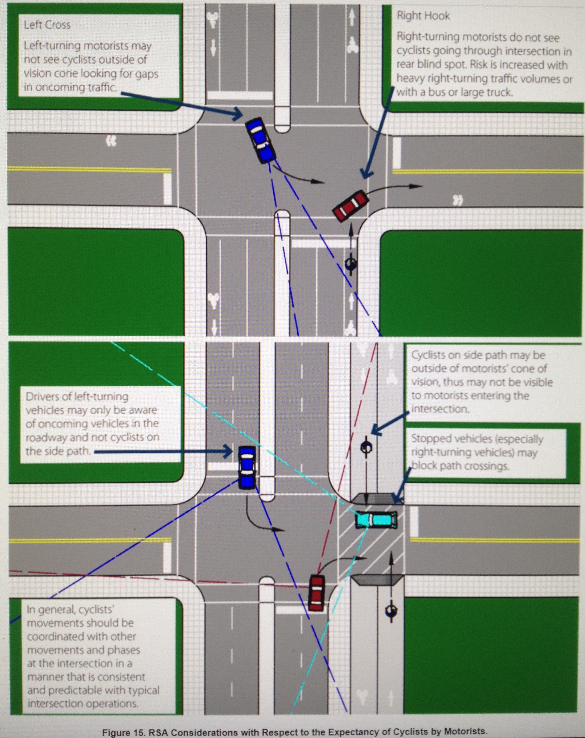

One of the fundamental principles in Traffic Engineering is conflict points of path between different road users (pedestrian, cyclist, vehicules) and within each of these modes especially with different traffic movements (turning traffic vs straight traffic). Traffic engineering focus on number of conflict points, severity (head-on, T-bone), traffic volume, visibility, etc,...
https://safety.fhwa.dot.gov/ped_bike/tools_solve/fhwasa12018/

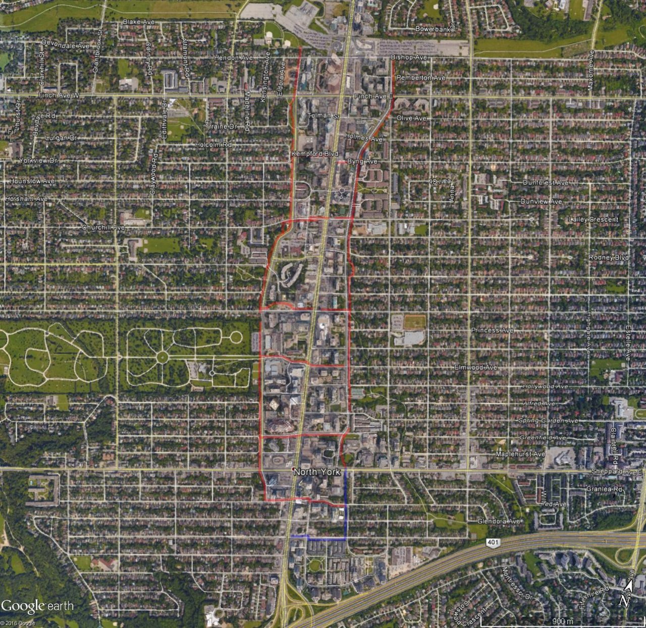

Now lets focus more on the cyclist-vehicle conflict points themselves - at the intersections!
- Along Beecroft & Doris, practically all cyclist-vehicle conflict points are at current or future signalized intersections where you have red (stop), green (go) or yellow (stopping) light - no ambiguity
VS
Yonge Street where the majority of cyclist-vehicle conflict points are at in-signalized intersection (stop sign only for side street), where vehicles coming out of side streets are constantly jerking forward looking for gap in Yonge St traffic. Here, cyclist are at mercy of driver's (often poor) judgement.
- Yonge corridor full of high density development producing higher volume of turning traffic onto Yonge Street
VS
west side of Beecroft & east side of Doris service low density residential neighbourhood with lower traffic turning volume
- Side street along Yonge St have higher volume and percentage of turning traffic (more accident prone traffic movements - right hook, left cross, pull out) VS Beecroft & Doris
- Along Yonge Street, building structure built out to City's Right of Way reduces sight line visibility for cyclist & drivers looking for turning traffic,...
VS
more open space intersections along west side of Beecroft & east side of Doris creating better visibility
- Yonge Street is full of distractions and more pedestrian traffic volume and unpredictability
- exhaustive stop & go cycling on Yonge Street with much higher cyclist-vehicle conflict points create exhaustive stressful cycling where cyclist are more prone to mistake (their's or drivers')
VS
long continuous relaxing cycling on Beecroft & Doris with more greenspace
Previously, already established that cycling infrastructure along Beecroft/Doris would be about 30 to 50 (6x5 to 10x5) times safer than Yonge Street! Using risk management, factoring in the above issues, my initial 60 to 100 times safer range would seem,... conservative! This exercise easily shows cycling infrastructure along west side of Beecroft & east side of Doris would be about 60 to 100 (6x10 to 10x10) times safer than Yonge Street! (Or as AmnesiaJune would phrase 6,000% to 10,000% safer than Yonge!!).
BTW, we haven't even discussed or factor in the design itself yet,.... along west side of Beecroft Ave and east side of Doris Ave there's more room to properly design much safer cycling infrastructure,..... and all this can be done without mitigating any other risk factors to surrounding neighbourhoods!

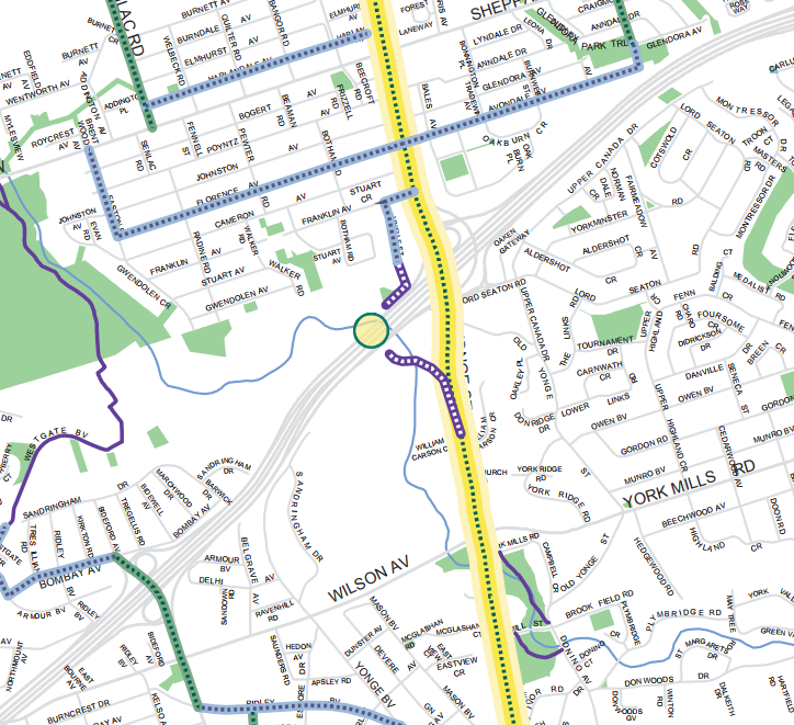

- to south, proposal for off-road multi-use trail at Yonge-401-DonValley - part of it already in City's 10 Year Cycling Plan while some other parts require more discussion with MTO
The Yonge-401 "bypass" idea pushed by Cycle Toronto included a trail connection under the 401 to Yonge Blvd, which is not shown in the 10 year plan. Is that proposal dead or unfeasible at this point, or is there still talk behind the scenes?

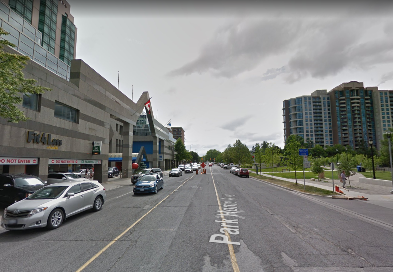

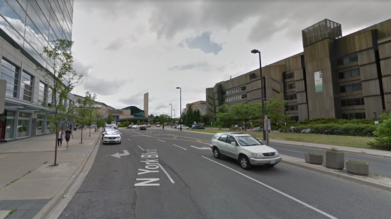

About the east-west connecting streets (sorry if I missed the answer to this), what else is special about them besides just having traffic signals? Will they also have bike lanes or multi-use trails? Because these streets as they exist today feel more like arterial roads and are definitely not safe for cyclists. Furthermore if the city is serious about making Yonge St more pedestrian friendly, these side roads must be shrunk drastically. Just a reduction in crossing distance alone would be a huge improvement.
Actually,.... that original Yonge-401-DonValleyWest ByPass Multi-Use Trail solution "pushed by Cycle Toronto",... is my idea! CycleToronto's Yonge Street Working Group just made an unauthorized youtube video of it without giving me full credit,.... that's called plagiarism, intellectual property theft, etc,...
Anyways,... the main centre-piece of my Yonge-401-DonValleyWest ByPass Multi-Use Trail solution is utilization of lower deck level of existing Highway 401 Hoggs Hollow Bridge for multi-use trail usage,.... I've been in discussion with various City Staff, local area Councillors, Provincial MPPs, community groups and even Federal MP over the years and they generally like the idea but the Highway 401 Hoggs Hollow Bridge itself is Provincial MTO infrastructure,... thus, City needs to get approval from MTO for any such usage. City is committed and focused on the near Yonge at separate grade crossing of 401 via existing dirt MTO service road near eastern valley ridge as shown in City's 10 Year Cycling Plan,... this requires MTO approval since its their infrastructure. With these discussion, the other segments like lower deck of Hoggs Hollow Bridge will be discussed as well,.... but City see them as longer term dependent on how demand for cycling infrastructure (multi-use trail) in the area materialize. NOTE: MTO now has CycleON policy guidelines for cycling infrastructure near MTO infrastructure,..... so that helps.
The east-west connectors are conceptualized as Off-Road Multi-Use Trails to match the Off-Road Multi-Use Trails along west side of Beecroft and east side of Doris Ave.
As per your first photo, there's plenty of room along north side of ParkHomes Ave to host off-road multi-use trail,... not just in GibsonPark but along grassy boulevard between curb and sidewalk.
NOTE: that south side of ParkHomes Ave is a pet-peeve of mine,... the pedestrian sidewalk are hidden in the colonnade,.... where drivers don't expect it to be!!! Very dangerous for pedestrian,.... let's try to get that sidewalk rebuilt outside of the building!!!
As per your second photo, there's plenty of room along north side of North York Blvd to host off-road multi-use trail,... along grassy boulevard. Keep in mind North York Blvd is ridiculously wide with 2 eastbound lanes, 2 westbound lanes and 1 centre left turn lane,.... 5 lanes of traffic for a road that's only 200m long!!!! WTF,... when is there ever traffic congestion on North York Blvd???? Are cars and people just lining up here "just dying" to get into the cemetery???? This is one of the 2 streets (of 6 east-west connectors) where I recommended lane removal.
From your first photo, I don't recommend any lane reduction along ParkHomes Ave & Empress Ave (likewise Churchill&Church Ave) since they're one of 2 feeder streets between Yonge and single residential neighbourhoods east and west of North York Centre between Sheppard & Finch, as per first photo of my previous post.
