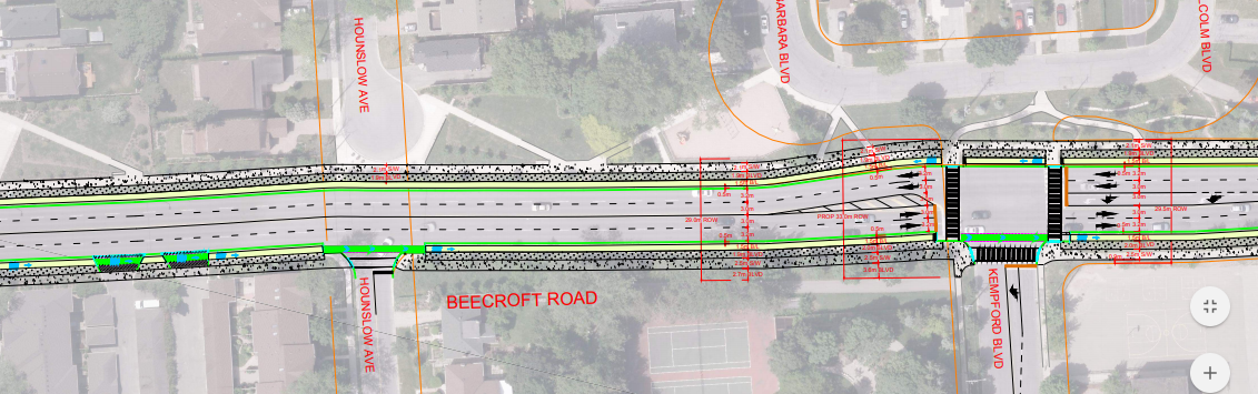

BTW, since no-one have spotted what's wrong with "Transform Yonge" solution (CityStaff hiding something! - Shiner's "Enhanced Yonge" *should* fix it),.... maybe a fan of Complete Streets guidelines should try spotting what's wrong with "Transform Beecroft"
(fixable but require slightly different design).
https://www.toronto.ca/wp-content/u...Beecroft_Stage-2_4L-2017-12-11-compressed.pdf
I'm guessing that you're referring to the fact that the bike lanes on Beecroft aren't bidirectional on the west side so they have to deal with unnecessary intersections:
Which, as you've pointed out previously, is disappointing because it means that there are many more potential conflict points and much more stopping required for cyclists than if they had a side-of-the-road configuration
yongecorridornyc3dt_good_orangegreenred_measure-jpg.119135
As a cyclist, I have to agree that I would much prefer cycling along routes that do not intersect with road traffic. I've been hooked before, twice, while in curb-separated bike lanes in a central road (de Maisonneuve boulevard), and there is much more conflict even between other cyclists when we bunch up at intersections.
I would prefer bike lanes on Yonge for a traffic-calming and street-improvement perspective, but if they are going to go ahead with Beecroft instead of Yonge, they might as well do it right.
All of the curb-separated bike lanes in Montreal are bi-direction, usually hugging the side of the road with more greenspace and fewer intersections (e.g. Côte St. Catherine hugs Mount Royal, more residential side). But there aren't many examples of roads where there is such a drastic difference in intersection density between east and west as Beecroft.

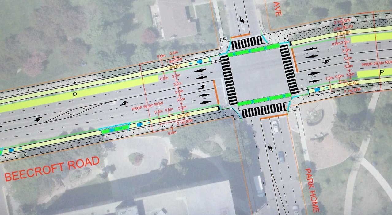

AquaTeam, yes, that of course is my main beef against the Uni-Directional CycleTrack design for "Transform Beecroft". CityStaff might have been tempted to present a Uni-Directional CycleTrack crap job on "Transform Beecroft" to help make "Transform Yonge" look better! Thanks for the Montreal reference, I'll check them out!
Here in the narrower City Right-Of-Way on Beecroft Road between Sheppard Ave and ParkHome Ave,... there's a violation of Toronto Complete Streets Guideline,... Can anyone spot it??? The easiest and cheapest fix (anyone figure out how?),... might actually force CityStaff to change to Bi-Directional CycleTracks along west-side of Beecroft where it's long & continuous with minimal cyclist-vehicle conflict points.
My understanding is the Bi-Directional CycleTracks version was also developed internally but never presented; thus, now at 30% engineering - it's now or never. Problem is the local Councillor is,....it'll be better and safer for his ward,... but the local Councillor is,.... arghhhh!!!
