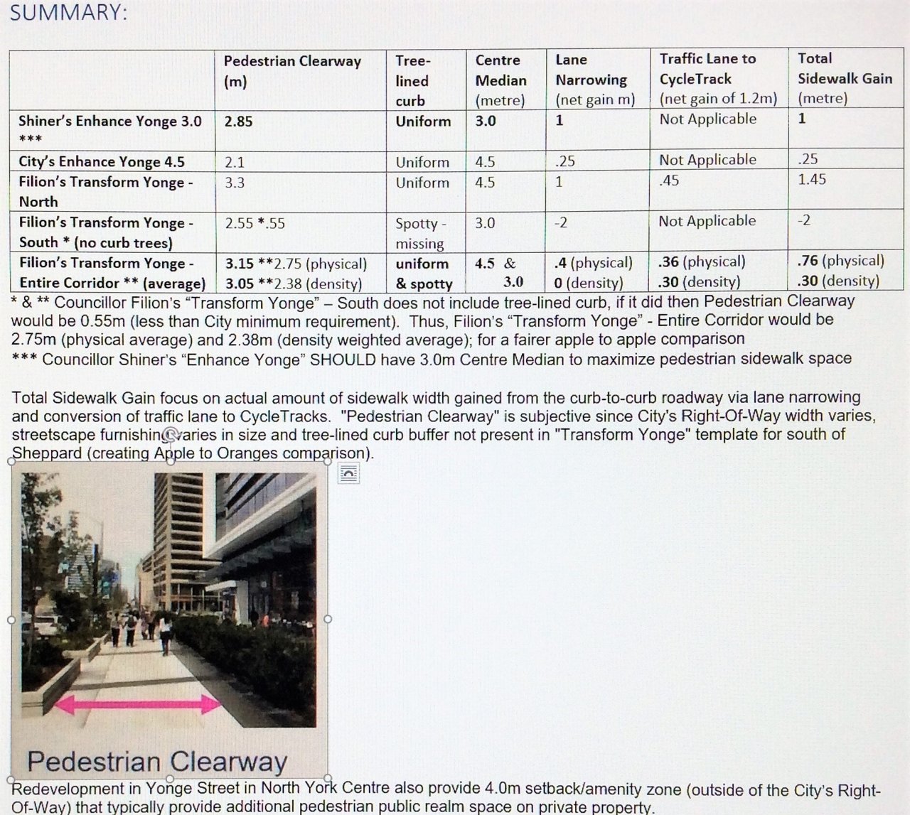

Originally, CityStaff's definition of Pedestrian Sidewalk Width gain was very liberal,... notice in the above image, in the middle of the sidewalk there's street furnishing like trees, fire hydrant, trash receptacles, etc,... Well, when they move these street furnishing items to the curb with the other street furnishing items,... they counted the free-ed up sidewalk space and it's imaginary buffer space! as gain in sidewalk space! Huh? It's already the sidewalk!!! So CityStaff was reporting to Councillor & office that there's actually 3 to 4m in sidewalk width gain per side!!!! And they were believing them! You won't see those types of numbers unless you convert entire traffic lane to sidewalk,... no CycleTracks, just sidewalk. Wow, 3-4m,... that seems like enough for a patio!
After being challenged on those numbers, CityStaff adopted more conservative estimates,...
Anyways,... with the various current options creating 0.25m, 0.76m or 1m or pedestrian sidewalk width gain,... then factor in street furnishing increasing by 30cm,.... in the end, forget patio,... the sidewalk width gain won't even fit a patio table tray,...

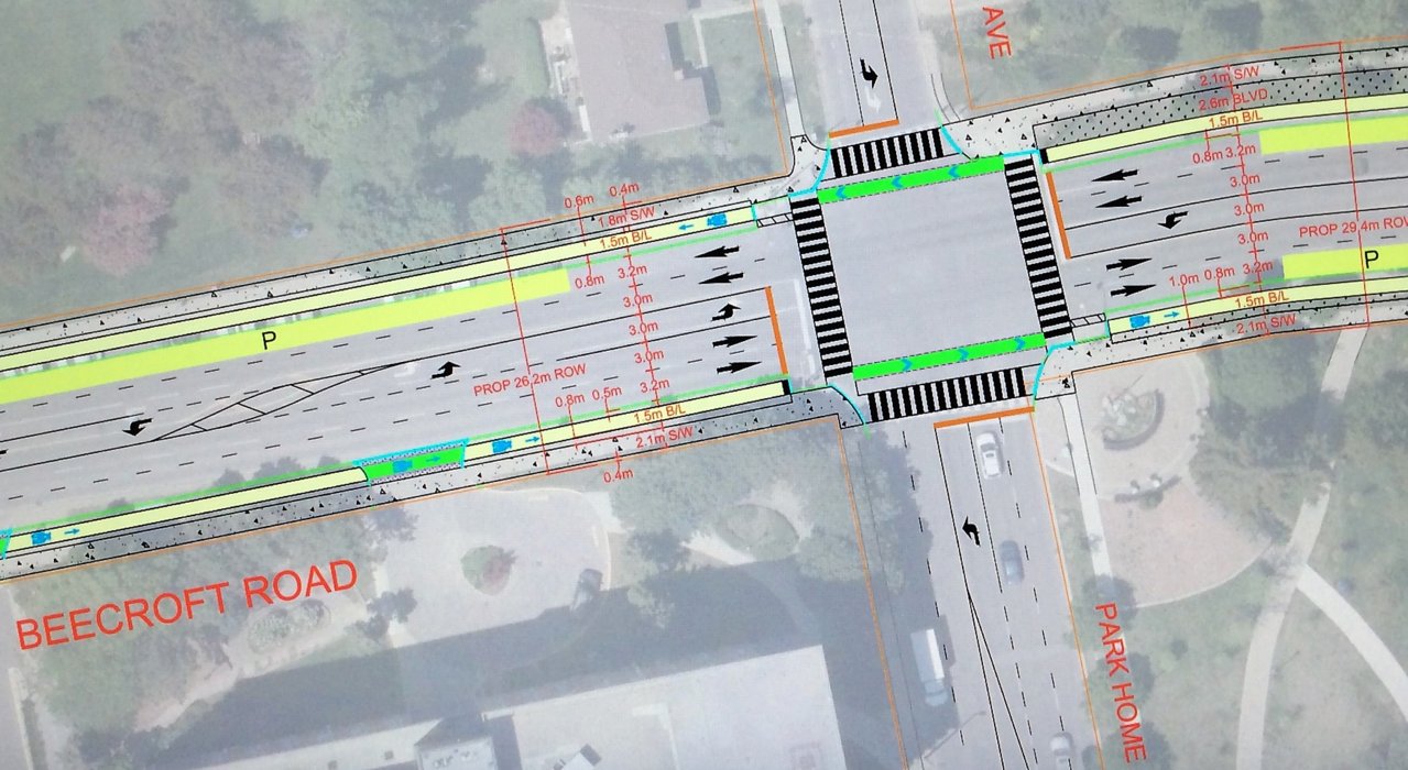

Here in the narrower City Right-Of-Way on Beecroft Road between Sheppard Ave and ParkHome Ave,... there's a violation of Toronto Complete Streets Guideline,... Can anyone spot it??? The easiest and cheapest fix (anyone figure out how?),... might actually force CityStaff to change to Bi-Directional CycleTracks along west-side of Beecroft where it's long & continuous with minimal cyclist-vehicle conflict points.

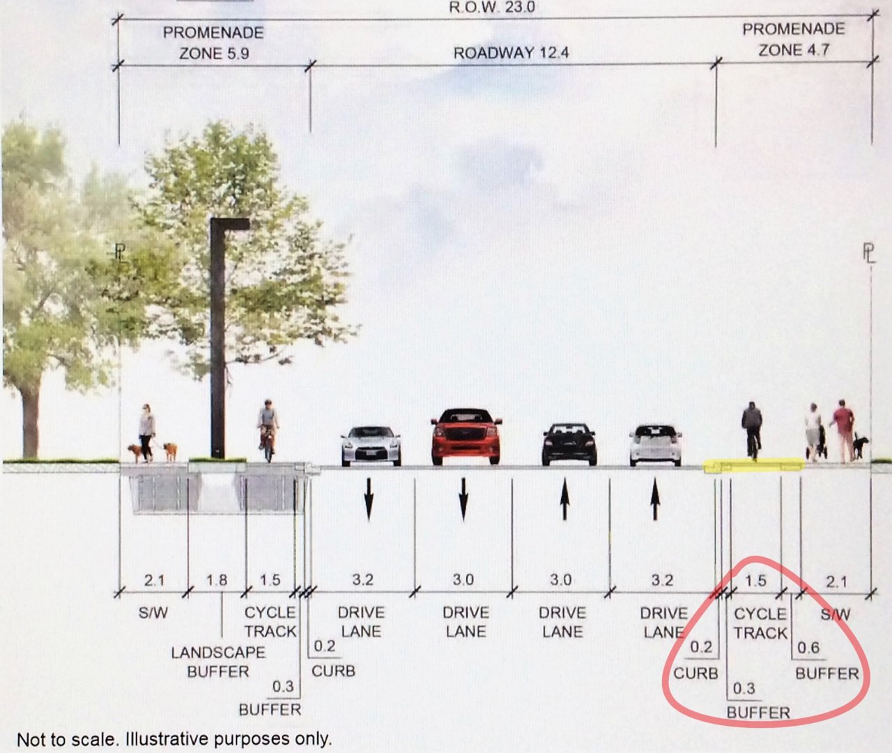

The proposed 1.8m wide pedestran sidewalk along west-side of Beecroft Road between Sheppard Ave and ParkHome Ave (about 850m ie: 1/3 of Beecroft Road) does NOT meet Toronto Complete Streets accessibility guideline of 2.1m wide pedestrian sidewalk.
Page 2 https://www.toronto.ca/legdocs/mmis/2017/pw/bgrd/backgroundfile-102436.pdf
Converting the dangerous Uni-Directional CycleTracks to safer fully protective (high wall or guard rails) Bi-Directional CycleTracks will free up 0.6m to 1.2m width here; more than enough to widen the 1.8m sidewalk width to 2.1m along with extra for other streetscape items and more buffer space to help ensure row of mature Spruce tree in front of Lawn Bowling Club survives.
This conversion to fully protective (high wall or guard rails) Bi-Directional CycleTracks will free up 0.6m of width between ParkHome Ave and Ellerslie Ave and allow width of proposed curb boulevard along west-side to increase from 1.0m-1.5m by 0.6m; thus, ensuring the curb trees in front of Dempsey Park survives.
https://www.toronto.ca/wp-content/u...Beecroft_Stage-2_4L-2017-12-11-compressed.pdf
This conversion to fully protective (high wall or guard rails) Bi-Directional CycleTracks will allow the controversial Bike Sharrows along west-side of Greenview Ave to be replaced with temporary fully-protective Bi-Directional CycleTrack all within City's Right-Of-Way until the required properties are conveyed to City via development.
From a cyclist perspective, this will allow fully protective (Jersey barrier or guard rails) Bi-Directional CycleTracks along the west-side of Beecroft Road where cyclist-vehicle conflict points are minimized in both number and vehicular traffic volume. CycleTracks with fully protective barriers (Jersey barrier or guard rails) will be especially important along accident-prone area of Beecroft Road south of Churchill Ave with sharp road curves.

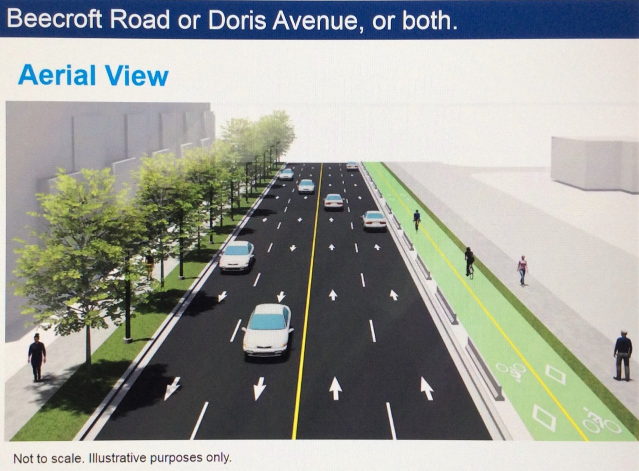

Bi-directional tracks are also safer for cyclists. They are less likely to be in blind spots of drivers.
The best plan should be:
1. bi-directional tracks
2. tracks are always between vehicular lanes and sidewalk, even right-turn pockets - vehicles do not cross onto cycle tracks to enter right-turn pocket
3. protected right-turn for vehicles at signalized intersections - no right turn except on green arrow; cyclists face a red light when vehicles have the right turn green.
My understanding is the Bi-Directional CycleTracks version was also developed internally but never presented; thus, now at 30% engineering - it's now or never.
During Community Consultations,... CityStaff was making some excuse about Bi-Directional CycleTracks being more complex due to Traffic Light signalization,.... yet, they applied Bi-Directional along south-side of QueensQuay and LakeShore Blvd West near Royal York.

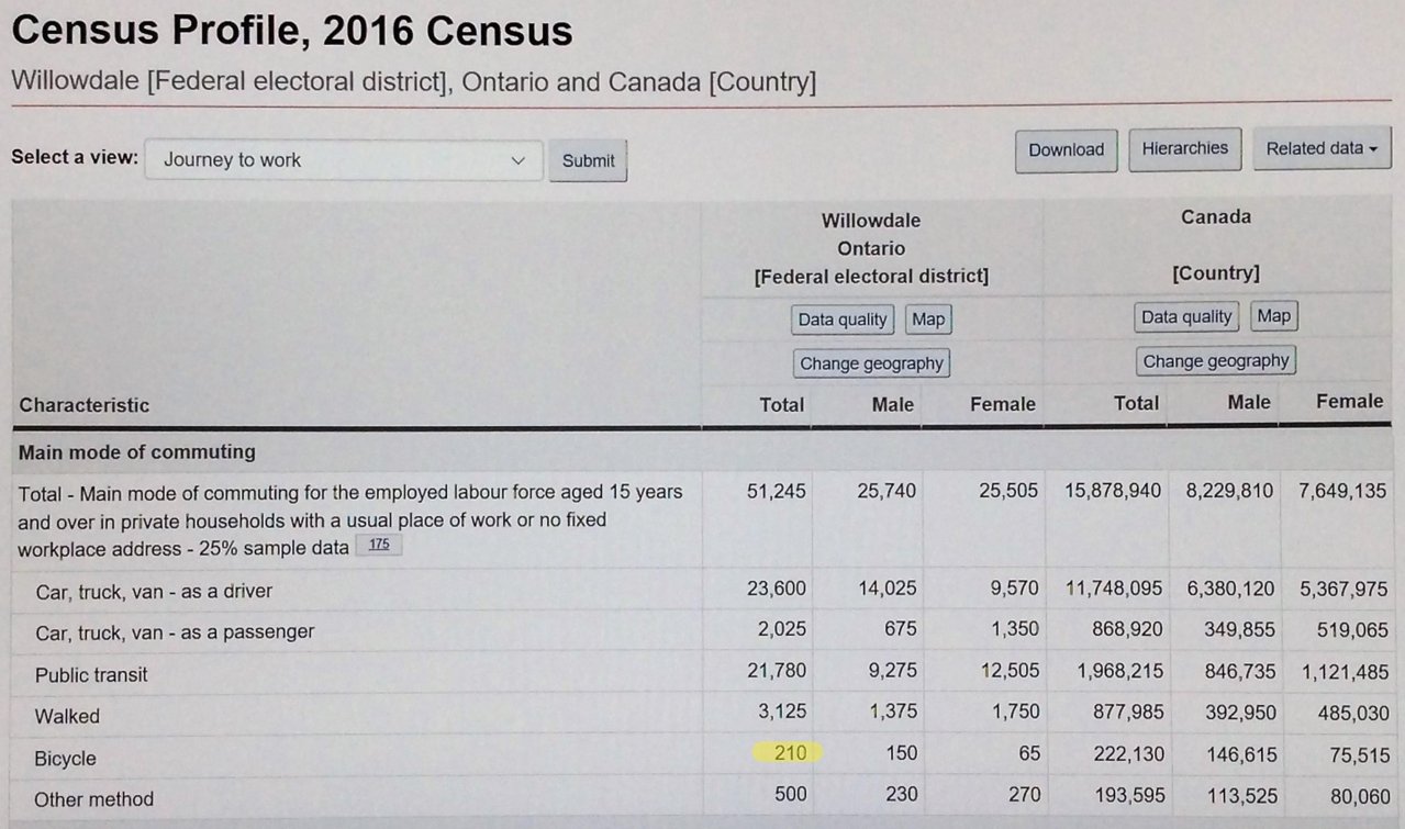

My personal observation is most of the Bikes parked on Yonge are mainly at TTC Subway Stations entrances and they get there going east-west from the house neighbourhoods where most of Willowdale's 0.4% Cycling Mode Share originates from.
For every north-south cyclist I see on Yonge Street, there's about 10 on west-side Beecroft and 5 on east-side Doris; on both they're sticking to outer part of Ring Road where sidewalk is 500-850m long continuous without Cyclist-Vehicle Conflict points VS every 80m along Yonge & inner part of Ring Road (east-side Beecroft & west-side Doris).
