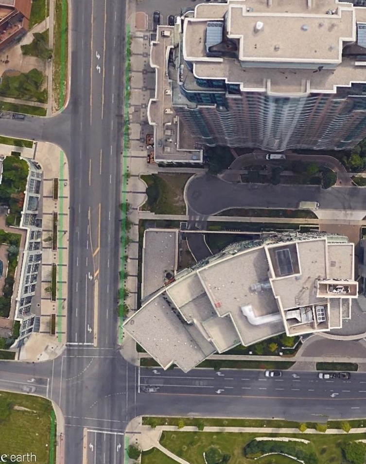

Green painted CycleTracks don't make cyclist invincible.
Transform Yonge with CycleTracks will still have all the exact same high number of Cyclist-Vehicle Conflict Points (right-hook, left-cross, pull-out),... generally every 80m since east-west side street dominate local road grid system.
The only way to eliminate/lower these Cyclist-Vehicle Conflict Points is to dead-end side streets before they connect with Yonge,... as you can see, now both sidewalk and CycleTracks become more longer, more continuous and safer since vehicular conflict point eliminated!

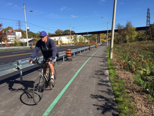

http://www.cbc.ca/news/canada/toronto/toronto-cyclists-enjoying-new-separated-bike-lane-on-bayview-avenue-1.3812323

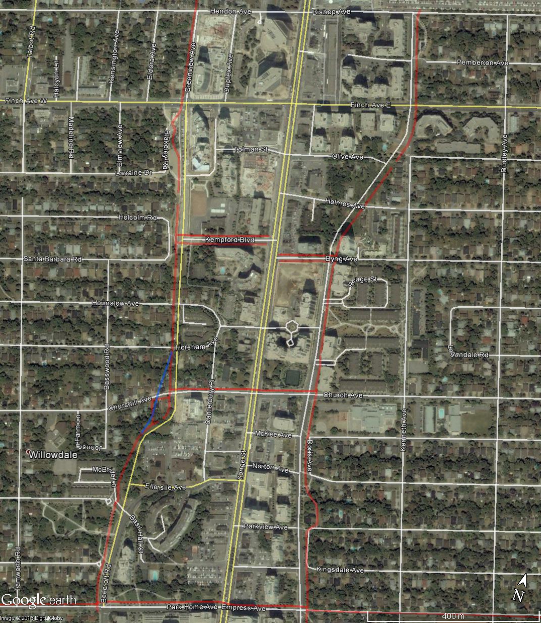

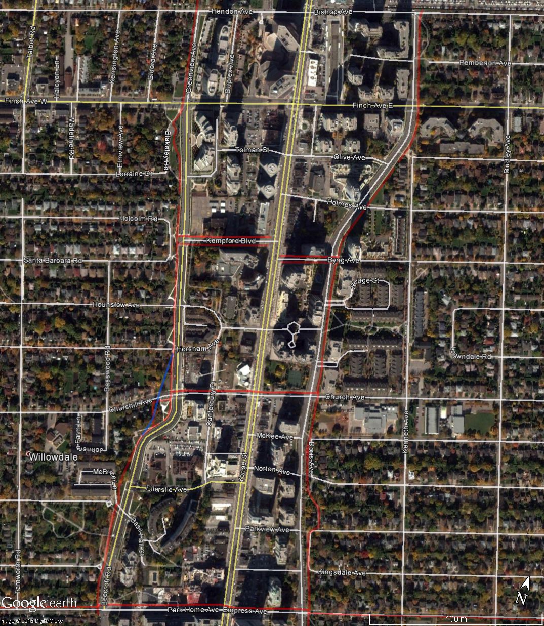

Originally, all the east-west roads from the single residential house neighbourhoods went directly to and intersected with Yonge St.
Starting in mid-1970s when high-density started in North York Centre, the protective road grid system was part of the deal to protect the existing single residential neighbourhoods from traffic infiltration originating from the new high-density intensification within the Yonge corridor.
In 1990's with official North York Centre Secondary Plan Area, high-density developments were allowed between the boundaries of Beecroft Road & Doris Ave,... and whenever these Service Roads were extended so was North York Centre's protective road grid system. Note: Initially (I'm not sure if it ever stopped) the house property owners on the streets would vote to get the protective dead end/loop-out feature to prevent traffic infiltration and pay about %10 more property tax for 5-10 years to cover the cost. As you can see, all the streets that got the offer took it!
2007 image with current road overlay (yellow or white lines), notice Beecroft end at Ellerslie and Doris at Byng:
2012 image, showing Beecroft extension north of Ellerslie Ave to Finch and Doris extension north of Byng Ave to Finch.
Notice: North York Center Secondary Plan generally uses Beecroft Rd & Doris Ave as boundary and buffer (not perfect but better than nothing!),.... and will generally extend them as development occurs,..... Yonge & Eglinton does NOT have such a service road buffer, and now they're getting a lot of intensification deeper and deeper into the single residential house neighbourhoods.
