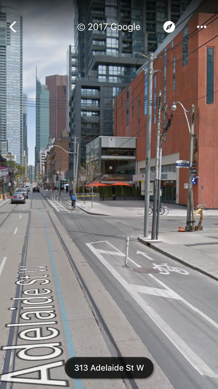

The driver wasn’t able to take the right-most lane, as there was a bollard in the way. And the cops didn’t come because the rules for reporting apparently changed recently. Unless there was an injury or over $1k in damages, you are directed to a collision reporting centre. (I’ll be doing so tomorrow afternoon and let you know what comes of it)
Thankfully, the adrenaline has worn off and I’m completely fine. I kind of feel bad for the driver, even though it was her fault for not looking. The system failed her, and it’s clear that it will continue to fail people as long as these rules aren’t clarified, enforced, and taught properly.

This is the location btw, to clear up road markings:
Exactly! That mistake is made time and again on Toronto bike lanes, but is just one of many. The Bloor St lanes are legion for them, and one of the highest accident corners in Toronto? Bloor and Christie. And guess what....?

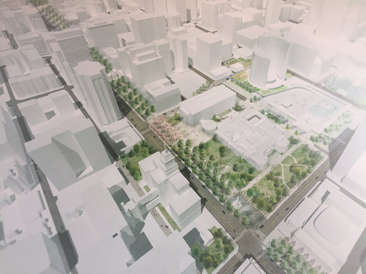

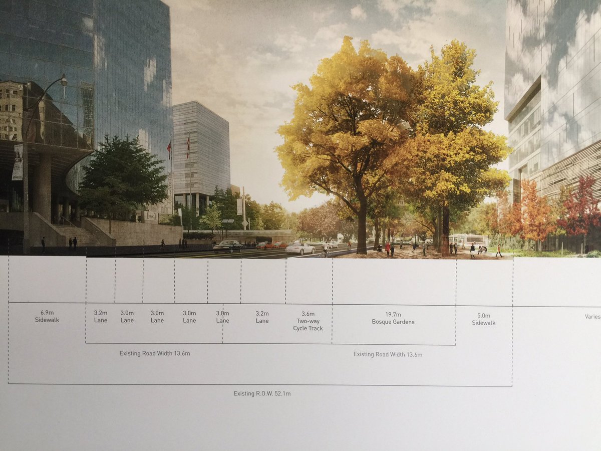

To the University bike lanes question, funnily enough (perhaps that's what prompted the initial question), Alex Bozikovic (and many other folks) posted a couple images from the Public Work (not ever to be confused with PWIC) presentation that I believe was a part of Jan Gehl's presentation on the weekend depicting their blue-sky proposal to re-imagine University in service of turning it into a real, usable public space from the dangerous vehicular highway that it is today.
Now, there are some obvious design flaws (but remember this is nothing remotely close to a "real" proposal), but in general I adore the idea of making University a place that we can actually be proud of and interact with. I agree that it'd be a really fantastic and valuable cycling connection for a whole bunch of reasons, though obviously the cycling infrastructure shown in these renders is a bad joke.
Those images are also interesting taken along with the fact that the Planning Department has included University as a priority cycling connection in their TOCore visioning document. A number of Planning employees were tweeting the above images and engaging in discussions with folks about them.
