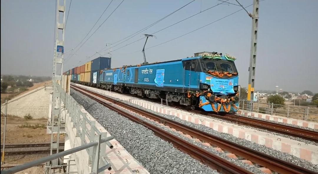

Not the case - India has nearly 2,000km of newly built electrified railway dedicated for double stack freight - electrified at 25kV AC.
Trains of comparable length to ones used in North America, running at 100kmh on these dedicated, grade separated lines. They use Alstom electric locomotives.
(Freight isn't always an afterthought, Indian Railways has historically subsidized the passenger segment with income from the freight business!)
(Also this image is great at scaring US foamers who claim double stack freight isn't possible under wires)
That is a bit of a strawman argument. Just because you provide an example of one country outside of North America that has long, electric freight trains, that doesn't mean that "most of the world" doesn't focus on passenger trains. I will admit that the Scandinavian countries also has some long freight lines, but that isn't representative of the rest of Europe, where significant restrictions are placed on train length, height and weight, mostly because of an unwillingness to upgrade their infrastructure for better freight.
I'm curious, is that "nearly 2,000km of newly built electrified railway" one continuous line, or a network of lines? India has significantly different geography and demographics than Canada. Sure CN and CP could probably get away with a 25 kVAC feed in the "Quebec-Windsor Corridor" (admittedly the topic of this thread) where:
  1. The topology is flat, and
  2. There is a well developed electrical grid, allowing frequent feeds to the catenary.
In other parts of the country this isn't the case. For example, in BC the combination of a mountainous terrain, combined with frequent, heavy resource loads (which, AFAIK, are typically heaver than containers), the higher power could be helpful. Also, in Northern Ontario, there are large sections without a well developed electrical grid, so having a higher voltage, would lower the current, meaning the distance between grid feeds could be longer.
The freight railways could possibly choose to use 25 kVAC in some sections to allow them to import European locomotives there (assuming they meet North American Standards) and then switch to 50 kVAC locomotives where those are more useful, but I somehow think they would want to standardize on a single voltage.
I will conclude by reiterating that the freight railways have shown no interest in installing catenary anywhere on their networks (or even permitting it), so the whole discussion is likely moot.

so its 2 systems (1.5 since the utah is 1 small line) vs the whole world.... id say thats pretty much zero then. theres no point in using an essentially bespoke voltage. costs would be 5x right off the bat.
the obstacle is not technical. as shown above for india its all about whether CN/CP wants in invest on electric infrastructure or stick with the good ol' diesel. right now its the latter because its more short term financially convenient for them.
