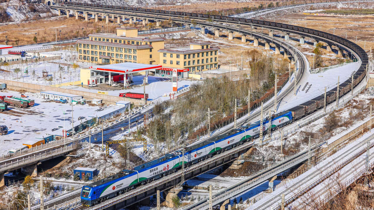

One final message I promise - this is a little outlandish, but the most powerful electric locomotive in the world is used in China to haul 10,000 tonne coal trains. I remember I laughed when I saw this for the first time - it looks remarkably silly.
28.8 MW 24-axle six-section locomotive (106m in length) develops starting tractive effort of 2,280 kN and continuous tractive effort of 1,596 kN reaching 120 km/h
