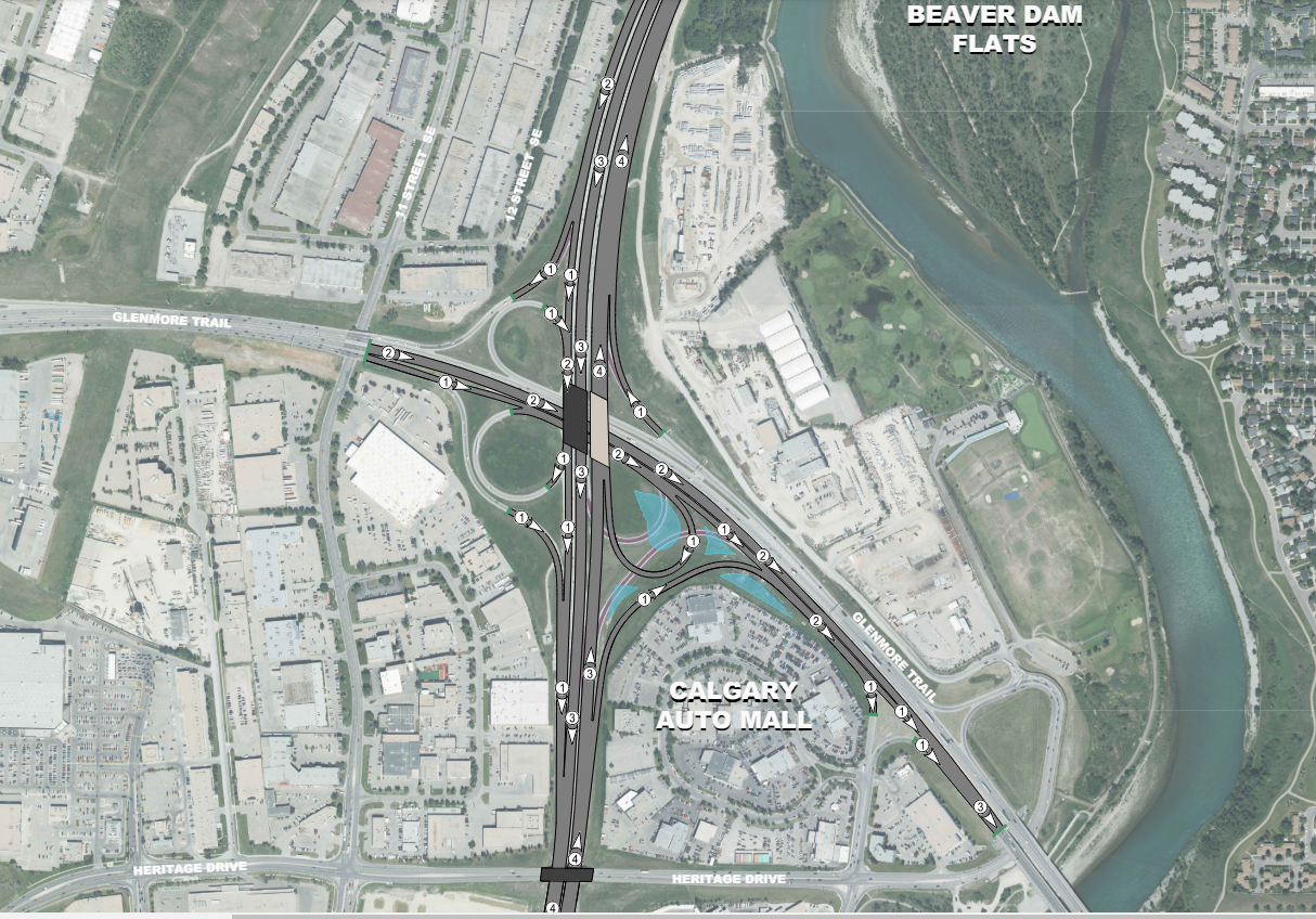

Interchange updates with # of lanes
Am I correct in seeing that they're not upgrading the northbound deerfoot to westbound Glenmore interchange? If so that's a little disappointing.
Most expensive part of the project with approximately 1200 users in morning peak out of 16,000 road users at the intersection. All to remove one interaction with a light, which could be removed with an intersection redesign at Heritage Meadows Way and Road. The juice isn't worth the squeeze.
Yeah - it’s mind boggling to me why they don’t provide a proper NB to WB movement.
