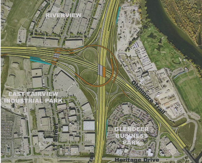

Am I correct in seeing that they're not upgrading the northbound deerfoot to westbound Glenmore interchange? If so that's a little disappointing.
I think there's always been a multi-phase approach to the Deerfoot/Glenmore interchange. The initial improvements are twinning the bridge to get rid of the 2-lane squeeze, as already outlined; while the ultimate improvements are building WB --> NB and NB --> WB flyovers, C/D lanes on Glenmore Tr between Blackfoot Tr & Deerfoot Tr, and reconfiguring Glenmore/Blackfoot interchange. Based on various studies that have come out, including the Deerfoot Trail Phase 4 Final Recommendation Report (2020), one would think (hope) that the ultimate build out is still in the works, or at the very least one that includes the missing link. Considering it's two of the city's busiest roadways intersecting, it's an improvement that's way overdue.
Do they need a flyover for WB to NB or do you mean WB to SB ?
Agree with your comment about two of the busiest roads in the city with this sub-standard interchange - never really understood that.

Two most need movements for flyovers would be NB to WB and EB to NB. NB to WB doesn’t have a movement at this time

The issue has always been lack of space due to the Lafarge cement plant. From a traffic volume perspective, a NB --> WB loop would probably be sufficient, but there's no room so they would have to squeeze in a flyover instead.

Acquiring additional land would be very simple as the needed land is currently side road and storage yard.
Of course the city and province act like it is impossible even when it would typically be much cheaper and faster to acquire land.
Not that I think the movement is particularly bad or needed or easy to be compatible with modern separation standards.

I'm surprised that the movement doesn't have more traffic. That may be because it is so difficult. A dedicated flyover would likely unlock latent demand. Ultimately, Glenmore will become Calgary's most important road:
-near the N-S axis of the city
-links all of the major freeways (Stoney East bypass, Stoney West bypass, Deerfoot, Crowchild)
-traverses the bottleneck created by Glenmore Reservoir
-services the enormous commercial traffic generator of Foothills Industrial
Does the new bridge under construction at Deerfoot allow 4 through lanes each way on Glenmore?
I could see that island of land wedged between Deerfoot, Glenmore and the river being redevelopment in the medium term. It would likely need to be raised above flood plain.
I agree. I sometimes find myself exiting Deerfoot at Southland and then taking Blackfoot to WB Glenmore. Saves a bunch of hassle
I agree - and have also wondered if the new Deerfoot bridge over Glenmore eliminates the double pier and just has a single center pier to allow Glenmore to be widened beyond 2 lanes each direction when the existing bridge is demolished - I sure hope so.
