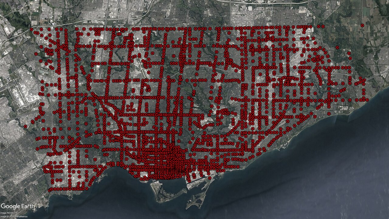

I pulled the City traffic signal open data for something I was working on, and I figured I'd share here:
The City currently has 2486 traffic signals. This is absurd. The entire country of the Netherlands (which has 18 Million people) only has 5500.
I wish we'd have a moratorium on new signals - so for each new (warranted) signal installed, an existing unwarranted signal needs to be removed.

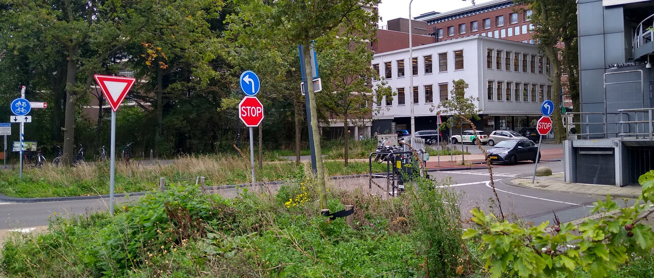

Stop signs (are supposed to) exist for a reason, namely that the visibility is so poor that you can't see the conflicting street until you reach the stop line.
Example of correct use of stop sign: The main street is a one-way road coming from the right, but visibility is blocked by a building. The driveway is too close to the building to allow adequate visibility for approaching traffic so it has a stop sign. The bicycle path is further away from the building so there is sufficient visibility along the main road for cyclists to have a yield sign. If the order of the bike path and driveway were swapped, it would make sense for the bike path to have a stop sign.
If we legalized rolling through stop signs it would eliminate the interest in changing stupid traffic controls at places like this:
Stop sign at the intersection of two bike paths were the side street is uphill and all bikes need to slow anyway to turn.
There are a few locations along bike routes which genuinely do require a stop sign due to visibility restrictions, and eliminating the meaning of a stop sign would eliminate the most suitable form of traffic control for the situation. The only safe control then would be a traffic signal, which is even worse than a stop sign.
