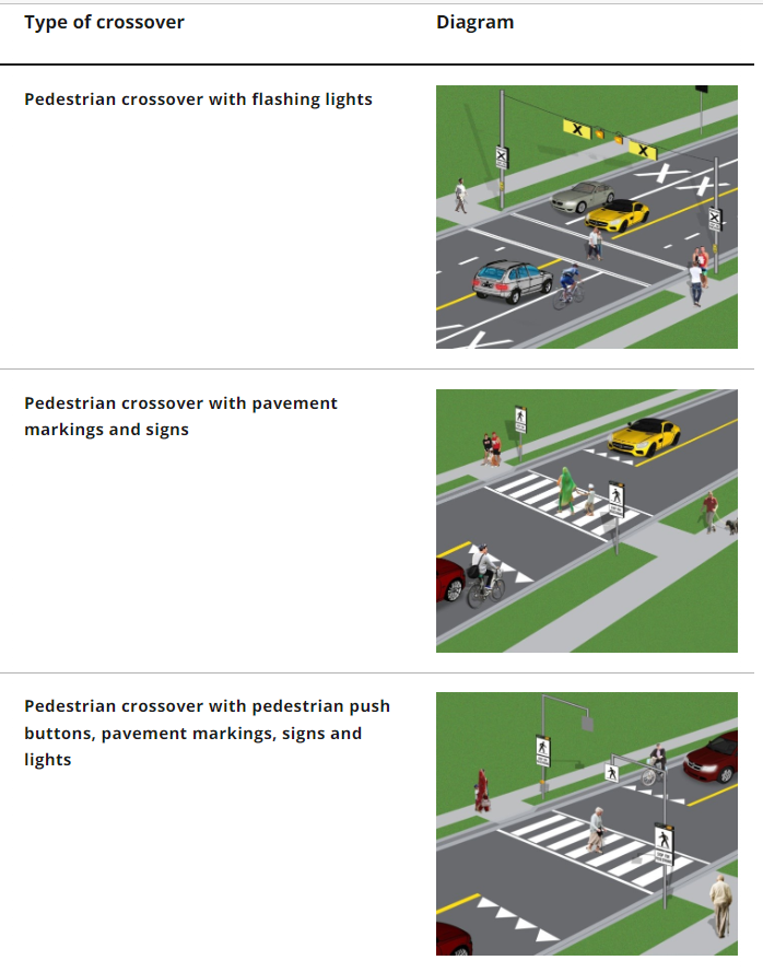

I don't know about this particular location but I am seeing a trend of replacing pedestrian crossovers with signalized crossings. I'm of the opinion that the new crossing configuration is not as safe as the old one, and it seems some road authorities agree. The replace a backlit overhead sign plus two flashing lights with curb mounted signs and lights that can get lost in the visual clutter.
Are you referring to the second and third in this image?

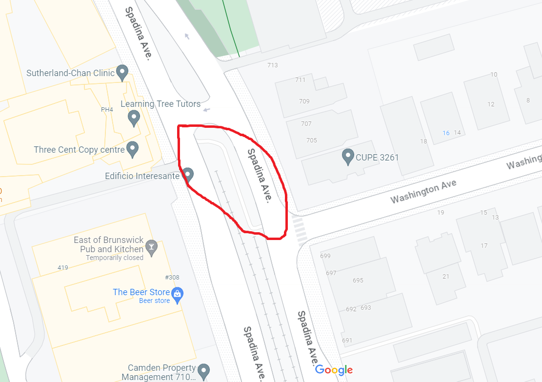

I'm not quite sure where it is - presumably just north of the portal - where you can see people crossing the street even on Google streetview.
The ideal place would be Washington Avenue, but the portal is in the way. Though you do have that odd piece of sidewalk along the Spadia median from Washington up to the U-turn location.
It's going where that driveway is just south of that green space over to the Sutherland-Chan clinic...

Yes. I was surprised that the configuration in the first image is still described in O/Reg. 402/15; I thought it was grandfathered (can I still say that?) because I haven't seen a new one installed in a few years.
I can't say I've seen a crossover installation like the second image - just signs and road markings (no lights). Any installation I have noticed has flashing lights. The way I read the Regulation, lights and over-lane signs are optional. I've only seen over-lane signs on multi-lane roads.
Subjective observation only but I find the visibility of the lights can be impacted by roadside clutter, foliage, etc. and simply by the fact that they are at the side of the road vs. overhead like they used to be. If they had mandated over-lane signs + lights they would have been better.
Off the top of my head, I can think of two, maybe three installations around here that were initially 'new style' crossovers but have since been replaced by full signals.
Subjective view only, but I think they would have been improved if theover-lane signs were the flashing lights were repeated on the over-lan

I live in York Region, a popular jaywalking spot near me had one of the new-style zebra crossings without lights installed as in that 2nd image, then presumably due to noncompliance by drivers (which I witnessed on multiple occasions) it was changed to a zebra crossing with push buttons and lights as in that 3rd image, then presumably due to continuing noncompliance they went straight to upgrading it to an actual traffic light (just for the crosswalk, there is no road intersection). The road is one lane each way, I'd probably call it a minor arterial, very wide lanes and 50 km/h (aka, textbook suburb).
The provincial pedestrian crossover standard is missing a crucial element - the crossing being raised, resulting in a speed hump for drivers. That's a standard part of the design in other jurisdictions. It forces drivers to slow down and makes it more likely that they pay attention to people trying to cross the street. It's no surprise that our watered down version results in non-compliance.
