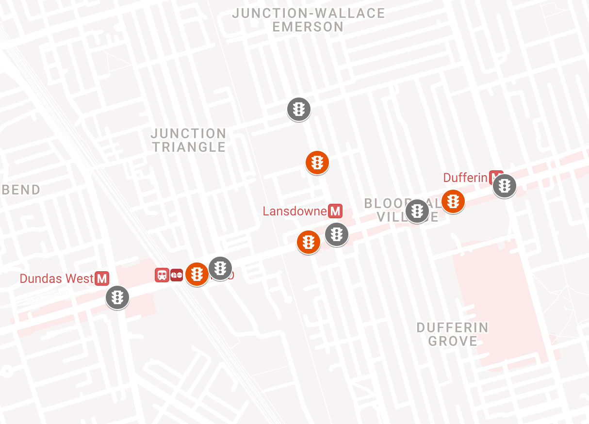

I put together this map showing the existing (grey) and approved (red) traffic signals in my neighbourhood.

This seems like a lot of new traffic lights. Too many? What could we be doing here instead of adding traffic lights at every other intersection?

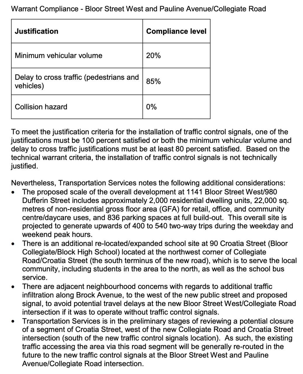

I wasn't able to dig up the documentation for Bloor/Perth or Bloor/St Helens. But for Lansdowne/Paton and Bloor/Pauline, neither met the warrant criteria but both were recommended by staff regardless.

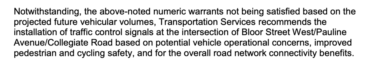

Staff response:
Bloor/Pauline:
I'm inclined to think that the Bloor/Pauline signal is justified based on the reasoning in the staff report, but I would have liked to see a bit more analysis for Lansdowne/Paton.
