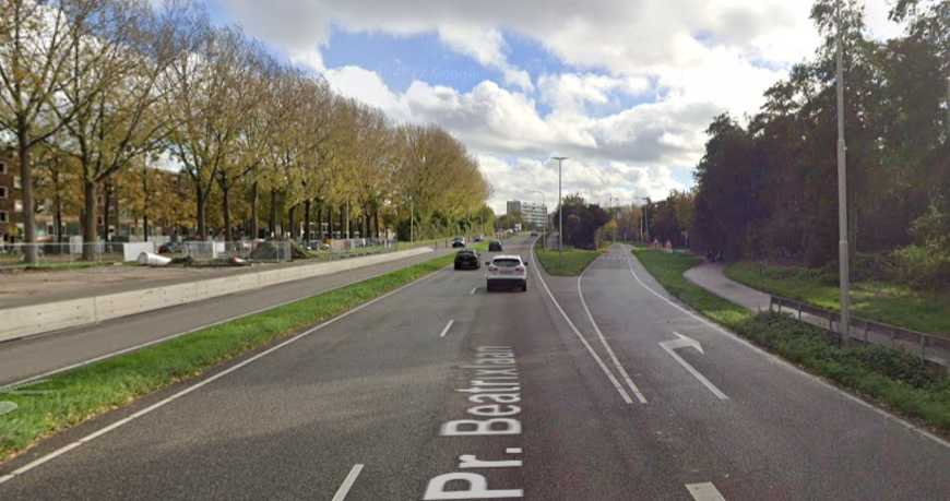

6-lane arterials are indeed less common in NL than they are here, but 4-lane arterials are quite common and pedestrians need grade separated or signalized crossing facilities either way.
The difference is that modern Dutch urban planning (since the 1970's, and especially since the late '90s) has been focused on completely removing primary motor traffic routes from the urban fabric. This means building arterial roads without frontage, or grade-separated expressways.
Houten, a new-build suburb of Utrecht, represents the ideals of Dutch planning. The entire community is transit-oriented: the highest densities are around the train stations, with lower densities further away. The town is shaped such that every home is a short bike ride from a train station. Through motor traffic is only permitted along the ring road around the town, as well as one shortcut in the middle of the town, in the low-density area halfway between the two train stations. It is easy to see how this type of design minimizes the need for pedestrians to cross arterial roads - improving motor traffic efficiency, cutting maintenance costs, improving urban quality of life and improving safety.
Beatrixlaan, below, is one of the main arterial roads through Delft, where I used to live. There are also two parallel freeways, one on each side of the city.

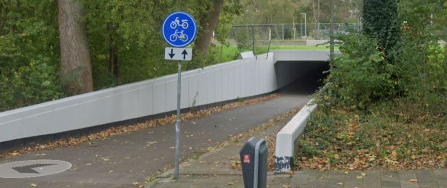

Bicycle tunnel under Beatrixlaan. This is an old tunnel not quite up to modern security standards.

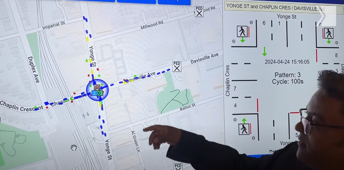

  • 400 cameras across Toronto
  • Pedestrian detectors for leading pedestrian interval
  • Lidar detectors can get quite a lot of information regarding, cars, buses, transit, pedestrians, cyclists from quite far away.
  • They have a lot of real time data and can also adjust signals remotely.

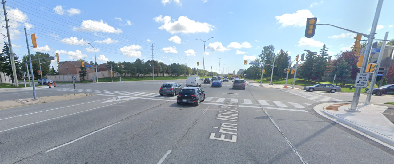

My "favourite" new utterly useless traffic light is one recently installed at Islington and Ridgevalley Crescent, because you know, a dozen bungalows backing onto St. George's golf course in an area with zero pedestrian activity and no schools, shops or other businesses anywhere nearby was truly crying out for a ******* traffic light. I'd LOVE to see the report that justified such wasteful spending.
